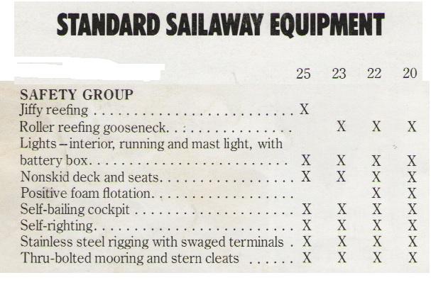

I do not recall the OD-22 being advertised as having positive foam floatation. Anyone have a brochure handy?

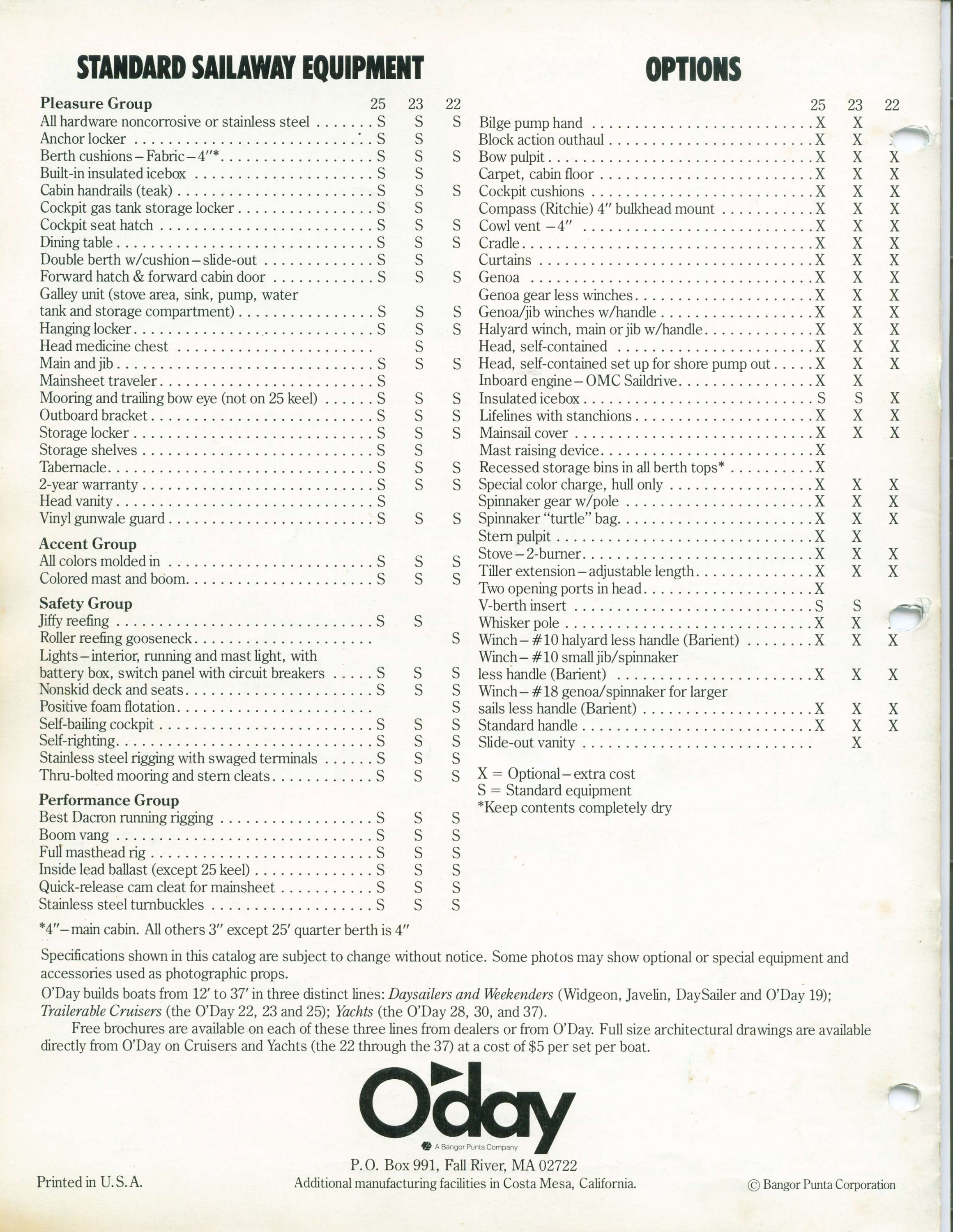

I have several O'DAY 22 Brochures, I've pasted the Safety part of the Standard equipment list for 1978. I checked my other brochures, 1972, 1973, 1974, 1976, 1977, 1978, 1979, 1980, and 1981 all list "Positive foam Flotation" as a standard feature. Interesting, 1981 lists it as only being under the V-Berth, I guess if one of those models swamped she would float bow up?
