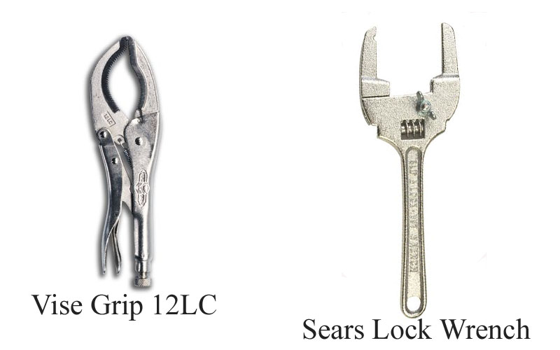

I have a Hunter 290, with a leaking stuffing box. After reading all that I could on HOW, I was ready. I purchased 2 wrenches, a Vise Grips model 12LC and a Sears Lock Wrench. I applied Liquid Wrench to the packing and hex nut, loosened the hex nut, tightened the packing nut and stopped the leak. But I wanted to go further and change the flax. I removed the packing nut to experience how much water would enter my boat...it was less than a gallon over 30 minutes. I enlisted the help of a friend and his heavy duty dental-type pick and in 45 minutes it was changed. The bige pump never kicked on. The link from a previous HOW article was very helpful.
