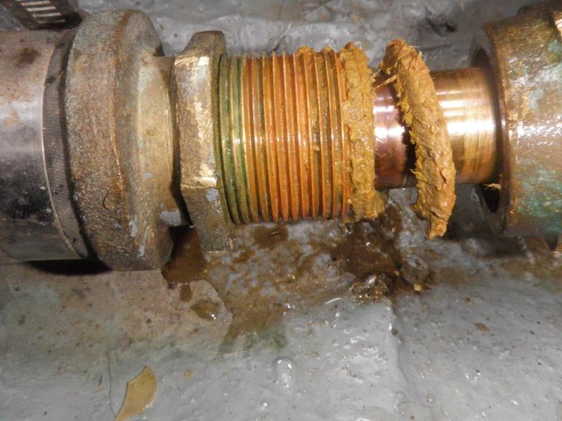

The stuffing box on my boat is similar to the
one pictured. Notice the flange at the end of
the threads has no flat spots.
How is one supposed to hold the stuffing box
still while tightening or loosening the packing
gland nut?

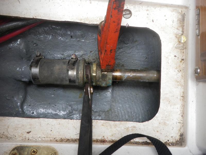

I ended up putting a large vice-grip onto the
threads (where nothing will ever be threaded)
to hold the thing still while tightening.
