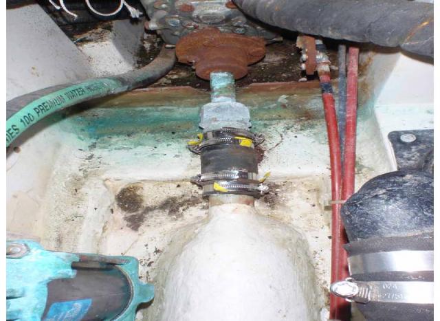

Since I am still really new to the hole inboard thing, I thought I would post how I plan to try and adjust the stuffing box to see if my approach seems ok. I have attached a photo of my stuffing box so you guys can see what I am starting with.

Boston: A couple of random thoughts --- make sure the four hose clamps on your gland are tight. Make sure the rubber hose part of the gland has not sprung any leaks, particularly the underside of it where the the water pools. Run your hand under there and feel for leaks or use a small articulated mirror to look. Also, after you tighten the compression nut (closest to the coupler) and retighten the lock nut behind it, make sure you snug up your dock lines and run the engine in gear to determine the leak rate. Finally, if you have a corroded compression/lock nut that defies loosening with PB Blaster, et al, try tapping the lock nut in a counterclockwise direction with a ball peen hammer.

almost looks like a pss dripless product--- keep hose clamps at the ready in case of emergent failure and goood luck--- your plan sounds fine. make sure pumps are working before starting this job. smooth sailing!
