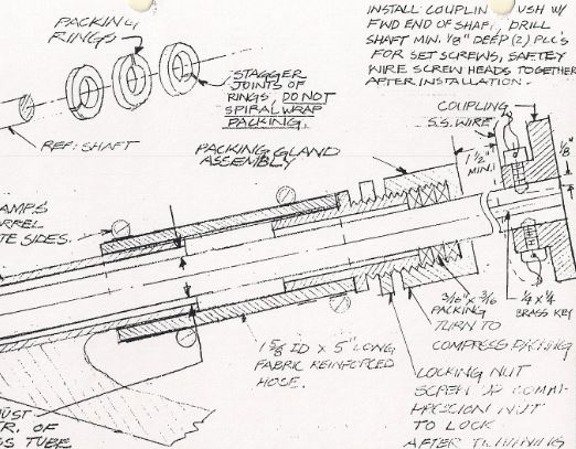

This would be easier to do if we could take the "big" stuffing box nut off the prop shaft. But the coupling that connects to the transmission is on the shaft. We have removed both of the set screws that holds this coupling (flange??) on but it doesn't seem to want to come off the shaft. We have sprayed WD40 on it and have tapped it with the hammer.
Any ideas on how to get this coupling off the shaft?

DON'T HAMMER! get a puller or make something like this! Also, don't hammer the shaft back in when you re-assemble. it will damage your new transmission.

Stu, your post was excellent. Will be referencing it tomorrow on the boat when my friend and I do this job.
But the transmission is disconnected. Seems like it would be much easier to remove the old packing gland material if I could pull that nut off the shaft. But I can't because that coupling is in the way.
I could also get good access to all the threads and get them clean.

No. Boat is in the water. I have about 1.5 to 2 inches between forward end of big stuffing box nut and coupling.
But don't have a puller like in your diagram.
Guess we will try it with nut still on shaft and see what we can get done.

it can be done with a piece of steel, bolts, and socket that is smaller then the shaft.
