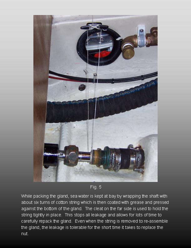

You can do it with the boat in the water if you have balls. Either plug the prop shaft in the water with toilet gasket wax, by diving on it; or cut a piece of bicycle inner tube to make a tie-on gasket (like a tourniquet) that you'll tie over the threads and shaft while you're working on the nut. If you use the wax, don't forget to remove it after you're done!

my packing gland is different than most of yours as mine is a flanged unit--we repacked in water more than one time so far--no one packed it before installation, as they should have-- but it will not sink your boat unless you forget to finish the work. mine had zero packing in it for over 5 yrs and didnt sink. (po told me the cutlass bearing was bad--wasnt--just the packing gland was never stuffed.)

To Repack a Stuffing Box ...............................
I will change to the 3/16" packing when the boat is hauled for the winter.
........................ in the water requires no more than a grade four reform school education at best. See below.
The water inrush when you open the gland is not that bad and once you've sealed it off, you can take the rest of the day to pack it to the utmost of perfection.

we repacked my rudder shaft packing gland also in water--is below water level. NO water ingress while changing it--
dont fear the ingress of water-isnt more than a 500gph pump can empty in less than 5 minutes...
