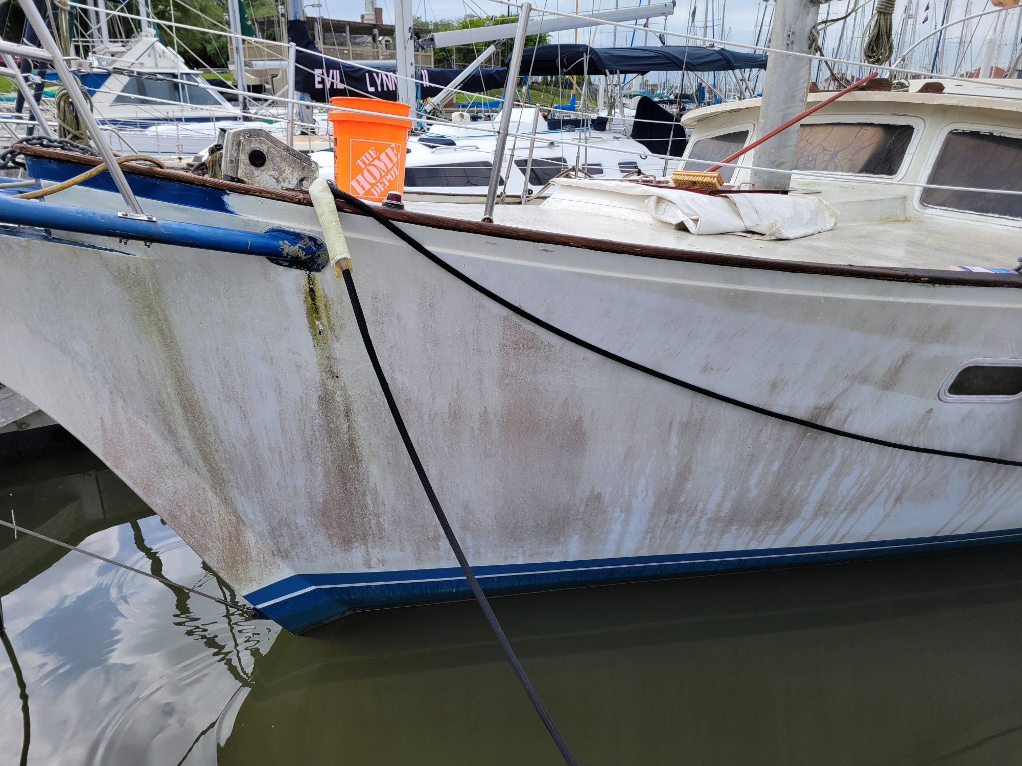

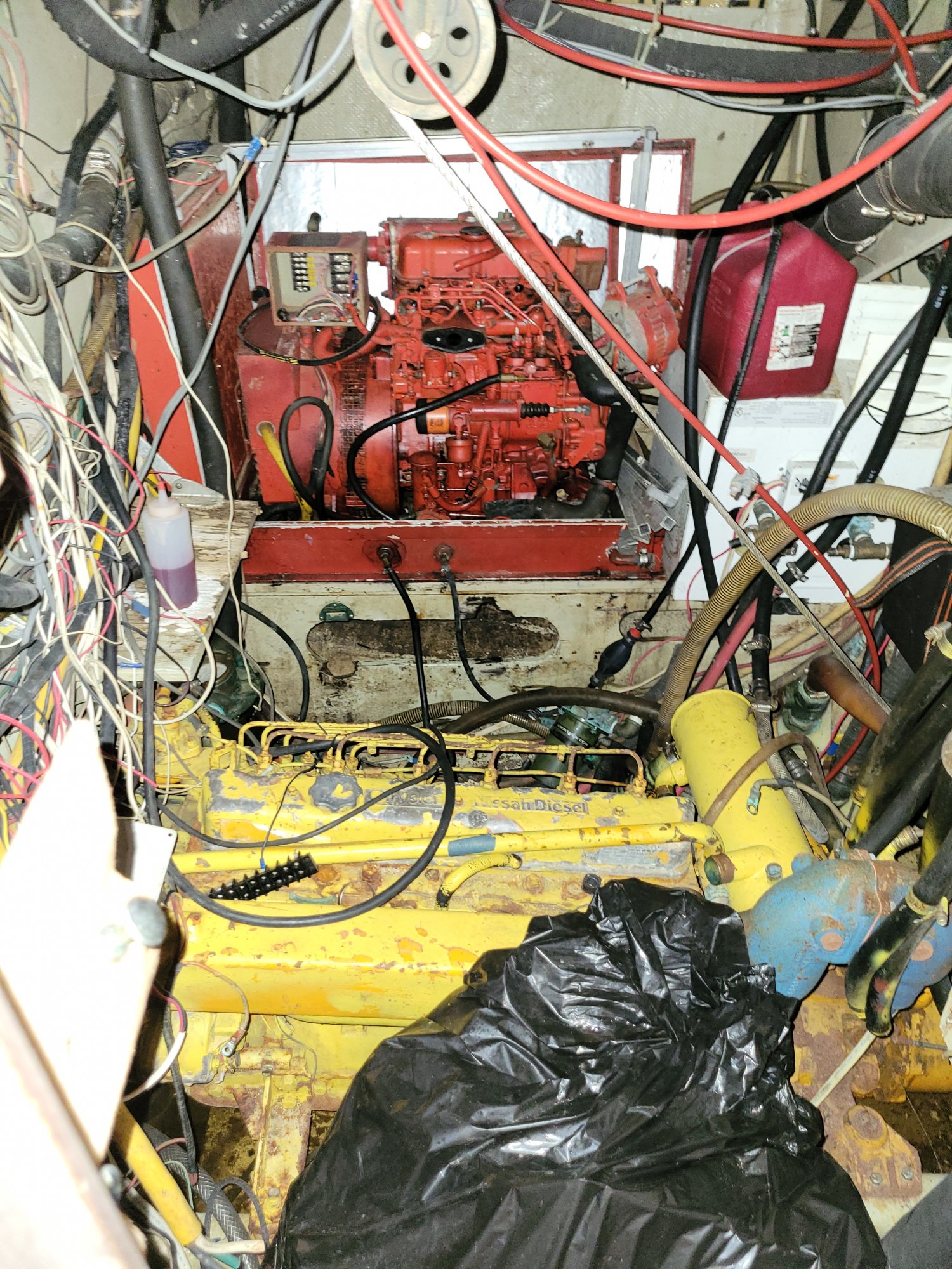

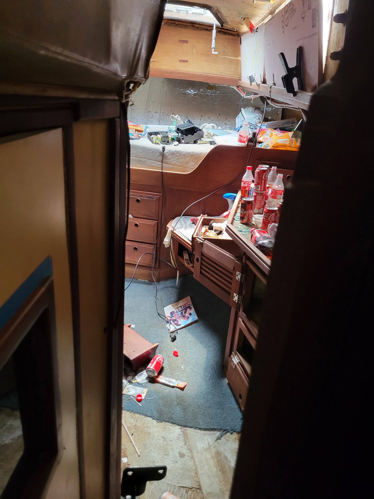

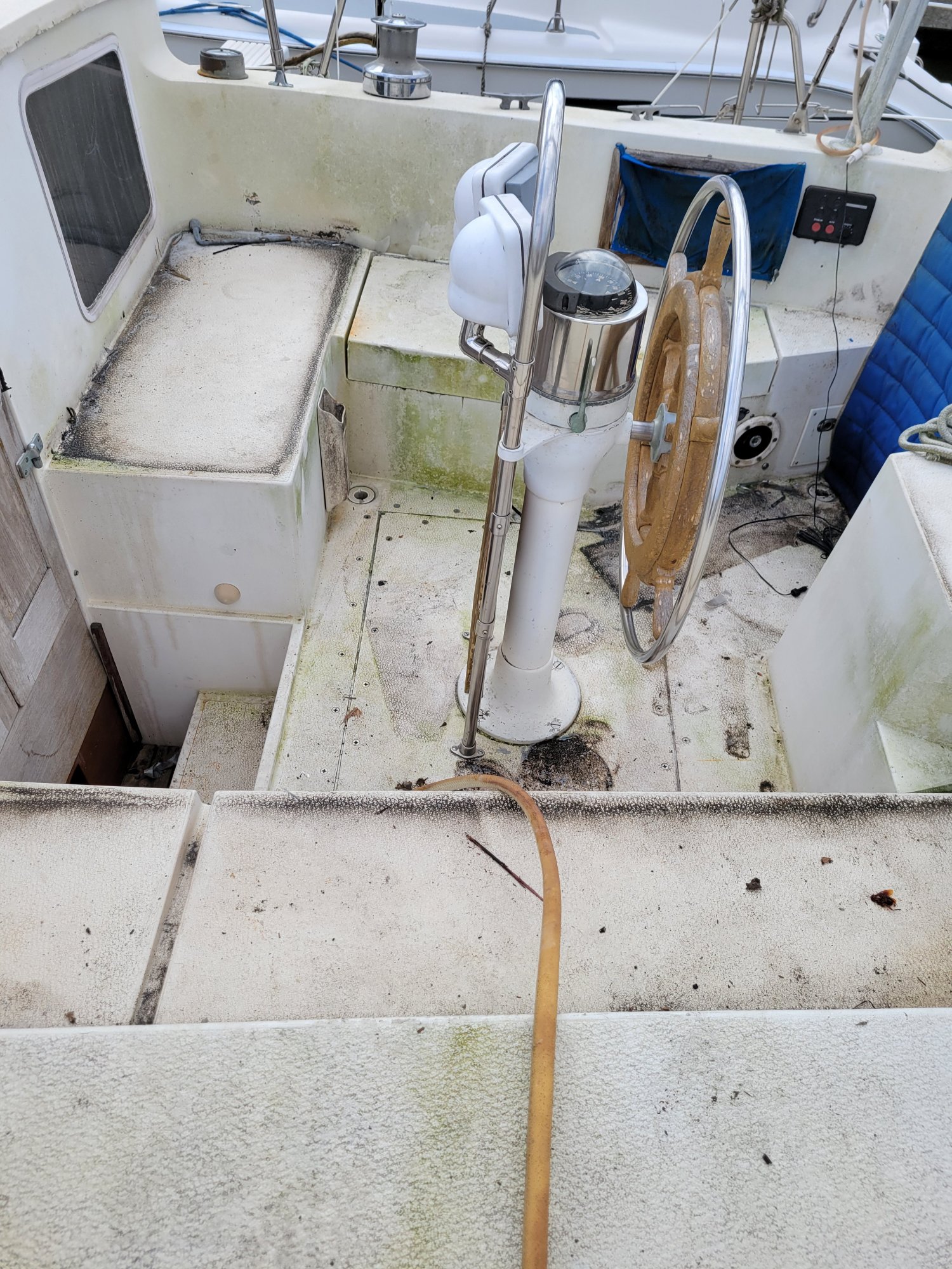

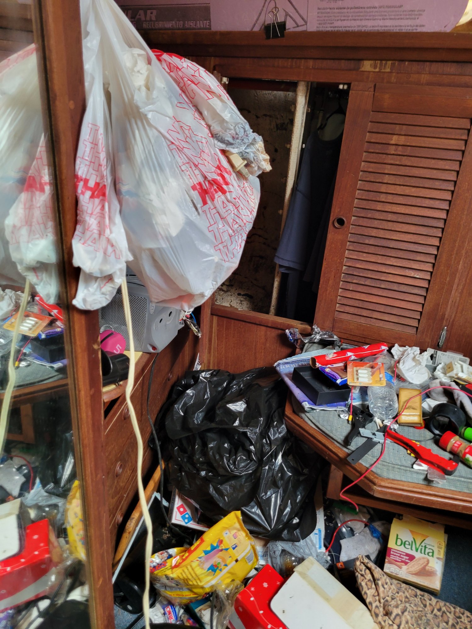

Thank you and I appreciate the knowledge. I've seen and heard from two distinct camps here are my local marinas: those who favor dripless seals and those who are adamantly opposed. Thanks to you and everyone.
Now I have another project, lol. Was able to buy a 1976 Freeport Islander for $500. It floats and doesn't leak, so that's a plus.
Mar 31, 2024
10
Watkins 33 Kemah
Pictures?
Needs some work, to be sure. There was a squatter on it, but at least he wasnt a crackhead and didn't tear the boat up; just left it messy as heck. Just wont the auction yesterday morning so cleaning as best I can, the gonna bug bomb it and then evaluate whether I flip it for a small profit or keep.
