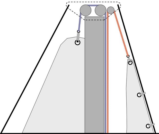

I can't see the full mast in the pictures. The parts I can see don't seem to have the openings for internal halyards.
This means the halyards have to go up one side of the mast, over a set of blocks (pulleys) and back down the other side of the mast. (or down the same side for the jib.)
Can you actually see all the way through the mast head to verify the blocks are missing?

Yep, the sheaves are not in there. The axels are gone too. I ordered new sheaves today and am in the act of calculating the lengths of lines for the main and jib. The jib sheets are on the old jib, so I can measure from them. I will also need new line for the boom vang.
I have found out that there is wire rope to pull up the jib and then through the head and down the other side attached to a down haul halyard. I laid everything out today, didn't get them measured though.

Dave's thumbnail doesn't look right. I think your mast is just like mine. Both halyards cross over the top in opposite directions. I have 2 sheaves on each pin with a spacer that runs between all of them. As far as the pin goes, I used a 1/2" SS bolt last year. I made a new tabernacle so this year I'm using a fixed pin in an "L" shaped tabernacle slot. It works wick'd good. (Maine after all)
With the halyards, mine are spliced to wire rope so only SS rides on the sheaves and only yacht braid goes on the winch. When I replace them, I'll get VERY different colors. "The blue one Honey, the pretty blue one. Never mind what it's called, just wrap it around the round thingy."
