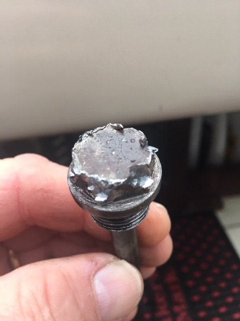

Yep, I rounded off the bolt that is the fill plug. Why its not a plastic unit with a dip stick like on a car, is beyond me. So, I'm asking the "go to guys" on this list what to do. If I apply heat, will there be damage to the transmission? I don't know much about how they work, but if there are any rubber seals inside, my guess is that heat will damage them. So I have applied PB Blaster, I have tried one of the wrench sockets with the multiple pins that push back when you cap the nut with it. I have not done the vice grips because i think it will just break down the nut head. Drilling and using a bolt extractor wont work because the extractor will need to be small and they just snap (very experienced with them).
So guys any help?

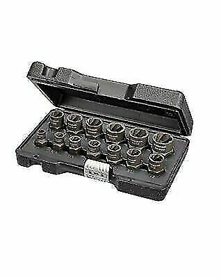

This plug is one SOB (and I don't mean Slide Over Baby). Pipe wrench and vise grips don't work. there is not enough flat wall space to get it to grip without it lifting off. My next step is using more PB Blaster and find a set of Bolt and Nut Extractors. The type that cuts into the head. wish me luck.

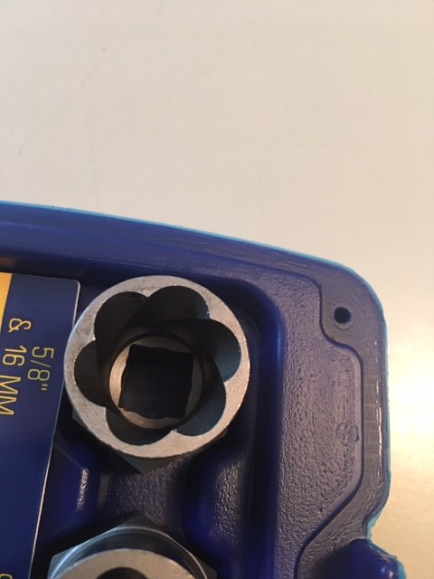

These bolt and nut extractors go over the six sided head of a nut or bolt and grab into the metal. There is no drilling, but thank you for the reminder of the ramifications of drilling into the head. Maybe I need this like a hole in the head!!!!!

BTW - there should be a copper washer under the plug.
That is why the plug was stuck on. No copper washer.
My task now is to clean this bolt up, cut a slot to insert and weld a finger tightening key like thingy that looks like Mickeys ears.
