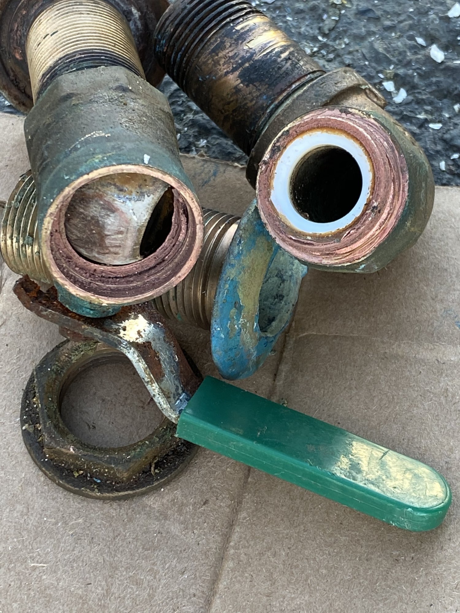

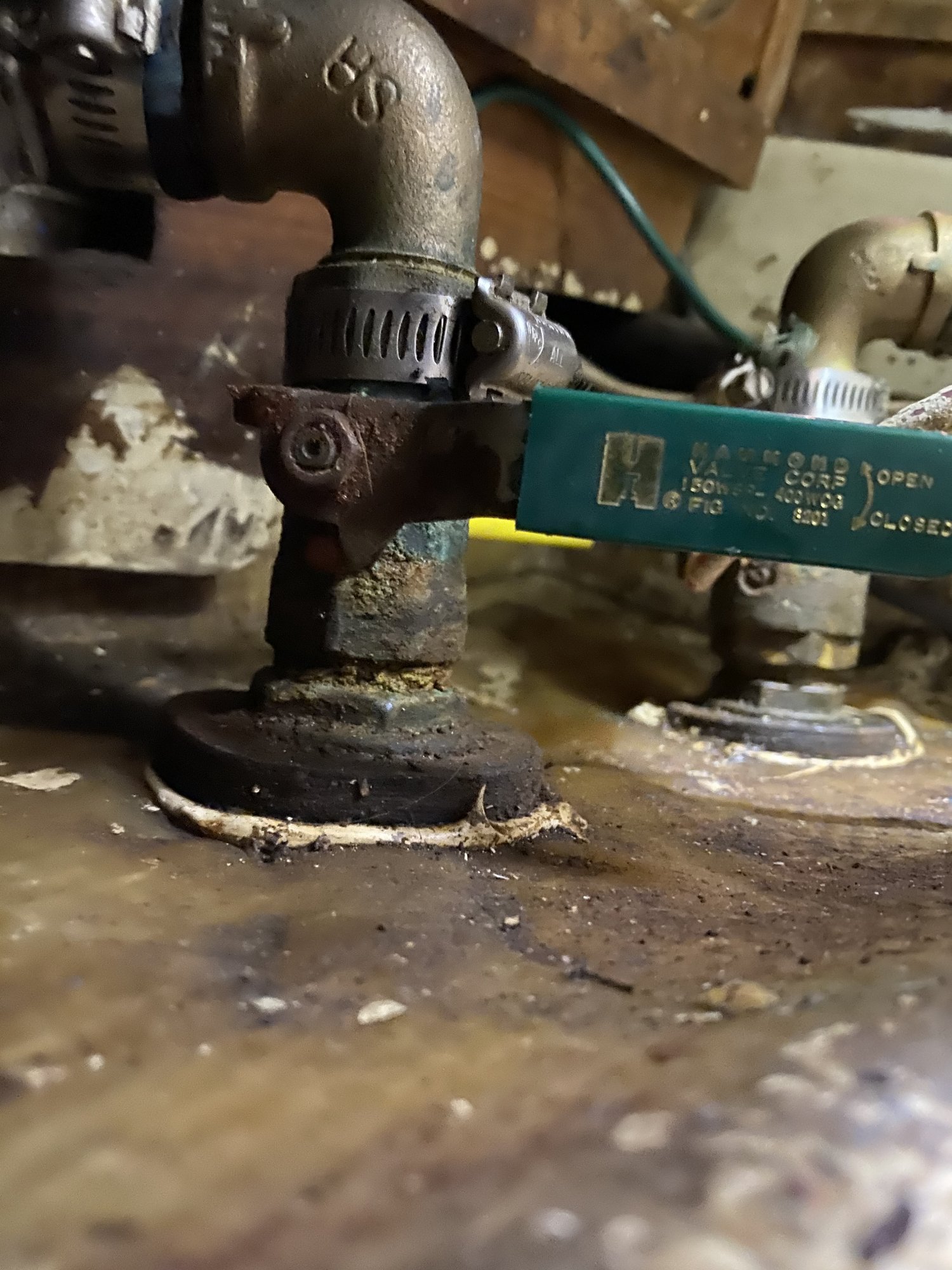

I ask because I live 4.5 hours from my boat on a good traffic day. I averted a sinking. I had not replaced the seacock on my raw water system. I was nervous and felt it was a good preventive action to take. I had the boat hauled for an over night hold in the slings so I could replace the through hull. I thought the valve was still good. I went to remove the seacock and due to the internal corrosion the valve split apart in my hand.
I thought it looked good and it had worked smoothly since I bought the boat.
When I went to remove the valve to replace the through hull it broke in to two pieces.:yikes:
Consider your boat and valve condition. If it is a concern I would haul the boat and replace the valve. If you know it is newish and in good shape then your approach might work. You may have something stuck in the valve that is causing the problem.

John's seacocks show evidence of pinking, which happens when zinc in the bronze leaches out resulting in very brittle metal. Galvanic action causes pinking and is the result of improper bonding or an unisolated ground wire on the shore power connection or exhausted sacrificial anodes. If the problem is pinking, all of the underwater metals will need to be evaluated.
