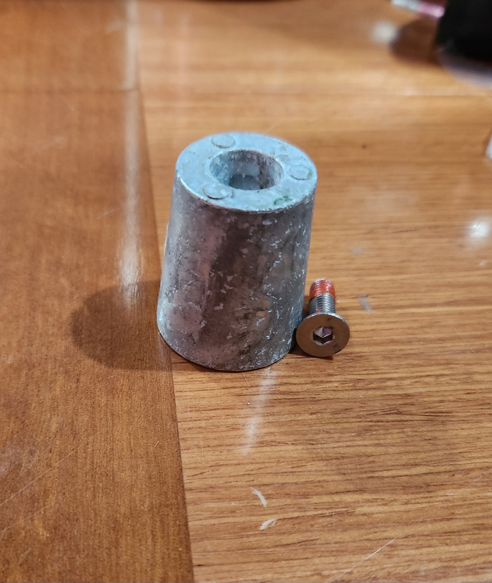

Stuck screw on prop anode
Jul 23, 2009
931
I thought I would take care of simple task today. Replace the prop anode. Had to shave to get my mask to seal. The hookah worked flawlessly. But the screw is stuck in the anode/prop shaft. Normally I would just apply some heat but I can't do that under water. Ideas?

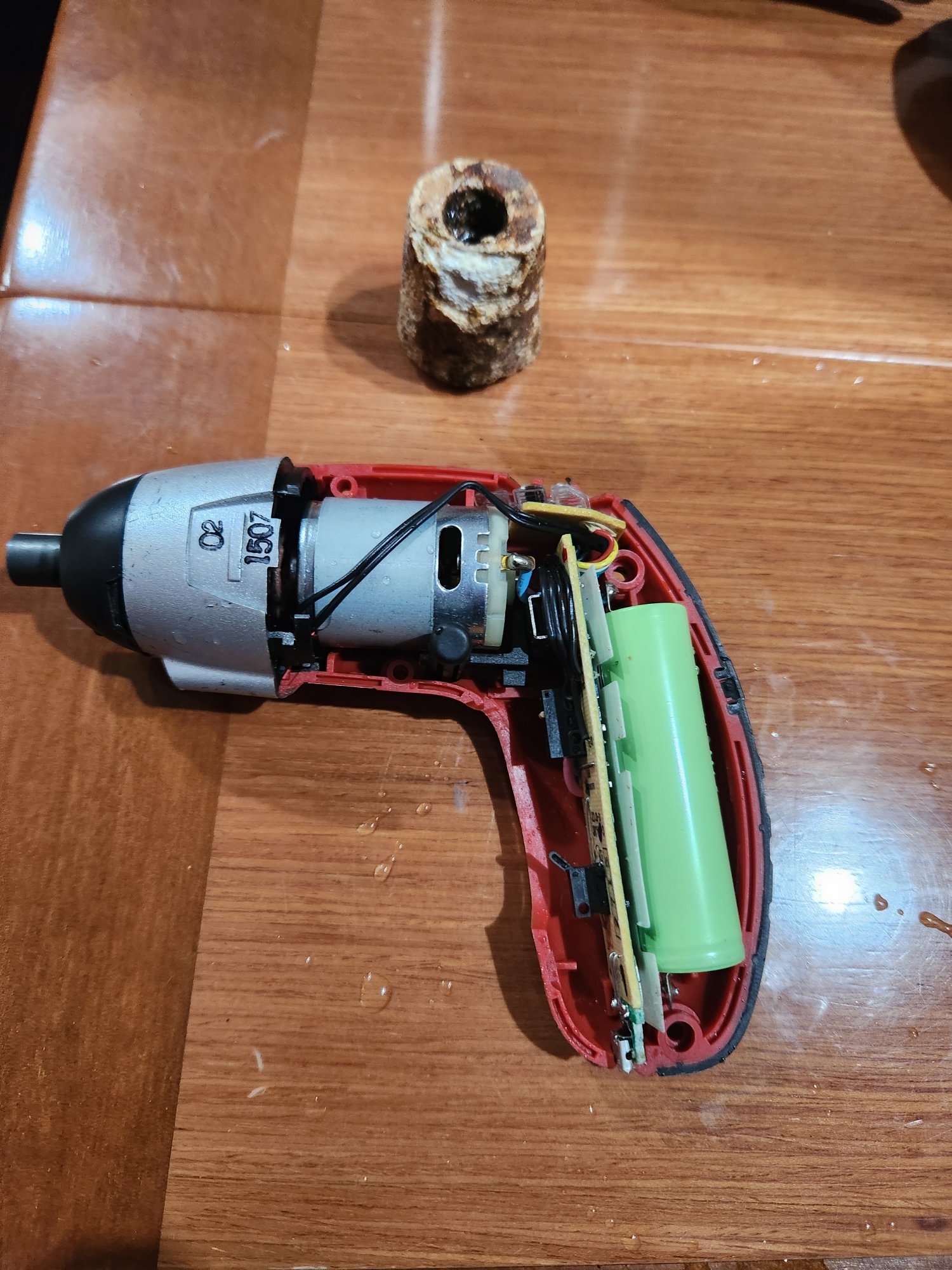

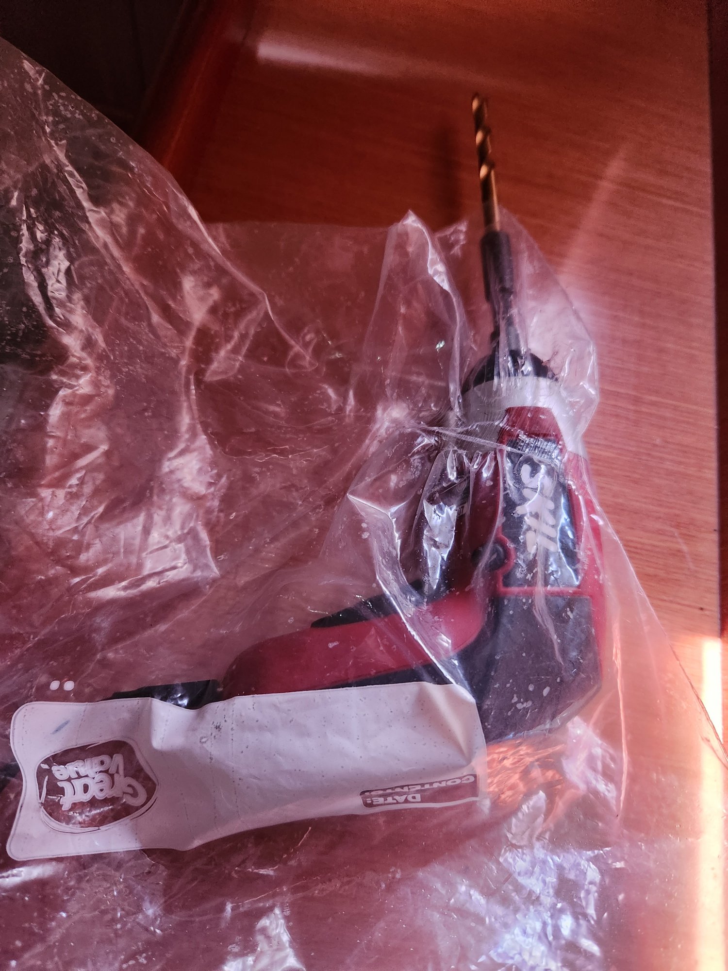

I'm thinking about putting a drill bit in my cheap cordless screwdriver and putting the assembly in a zip lock bag and drilling the head of the screw off.

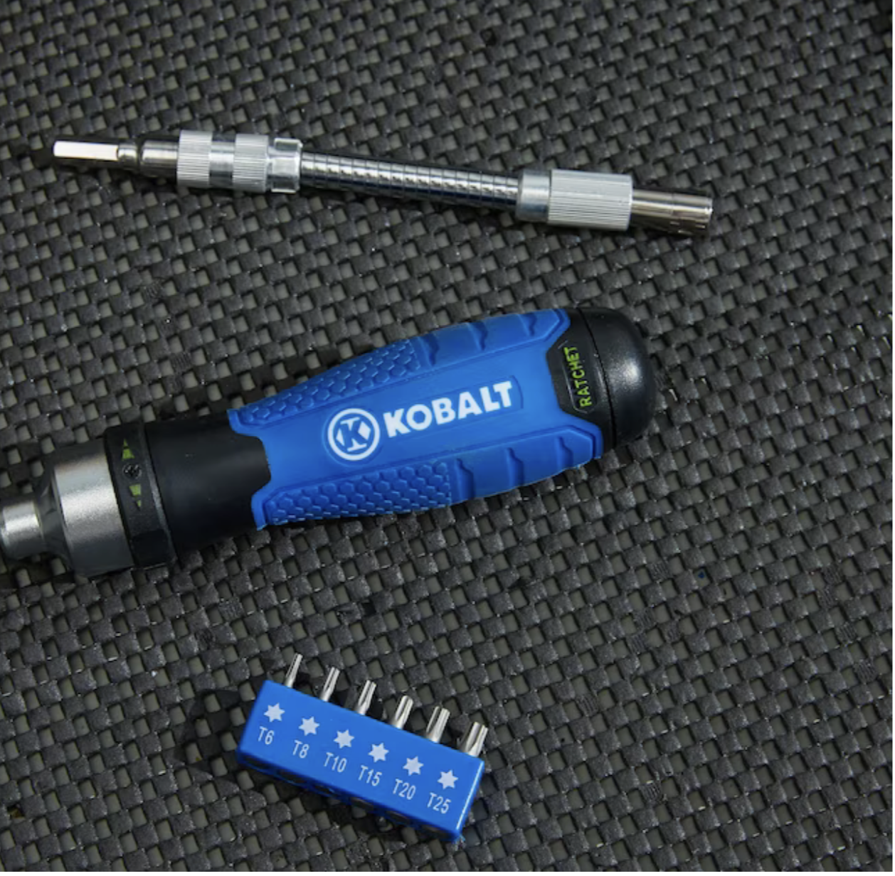

I have this tool on my boat. My version rotates the handle too.
In fact I used it today to loosen hose clamp, not with the flat blade type.

Using the right bit, you can ratchet off your screw, underwater.;)

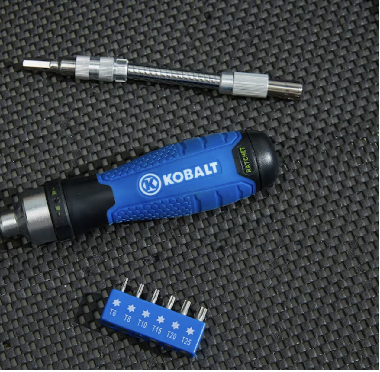

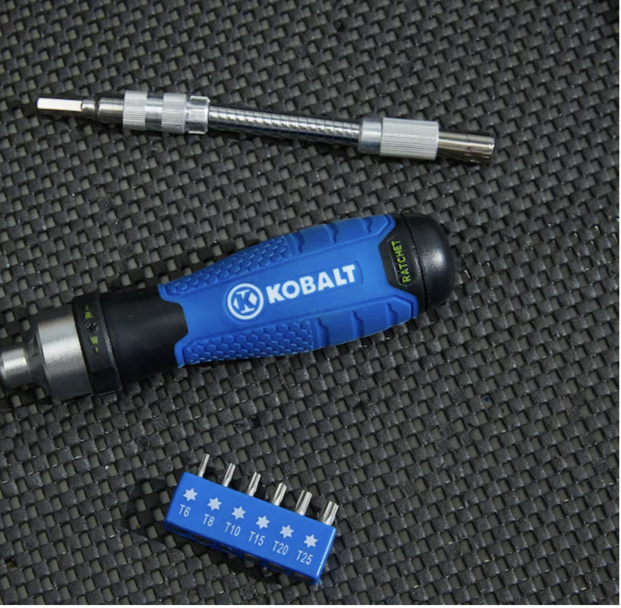

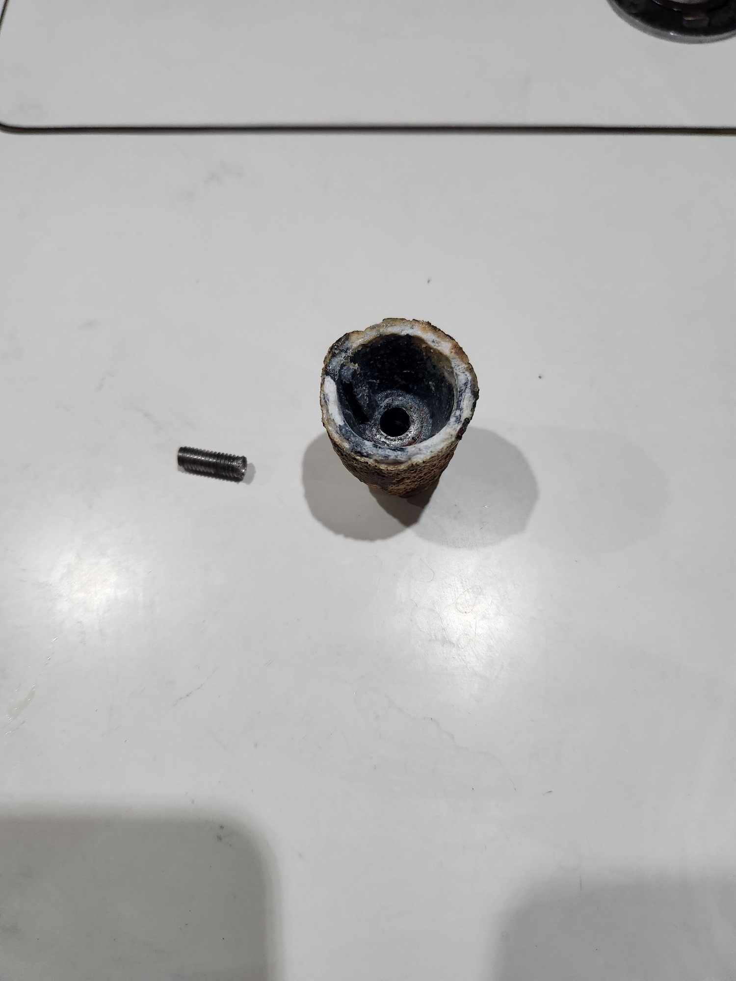

The allen head bolt is damaged, especially now after drilling it. I definitely need more tools on my boat.
