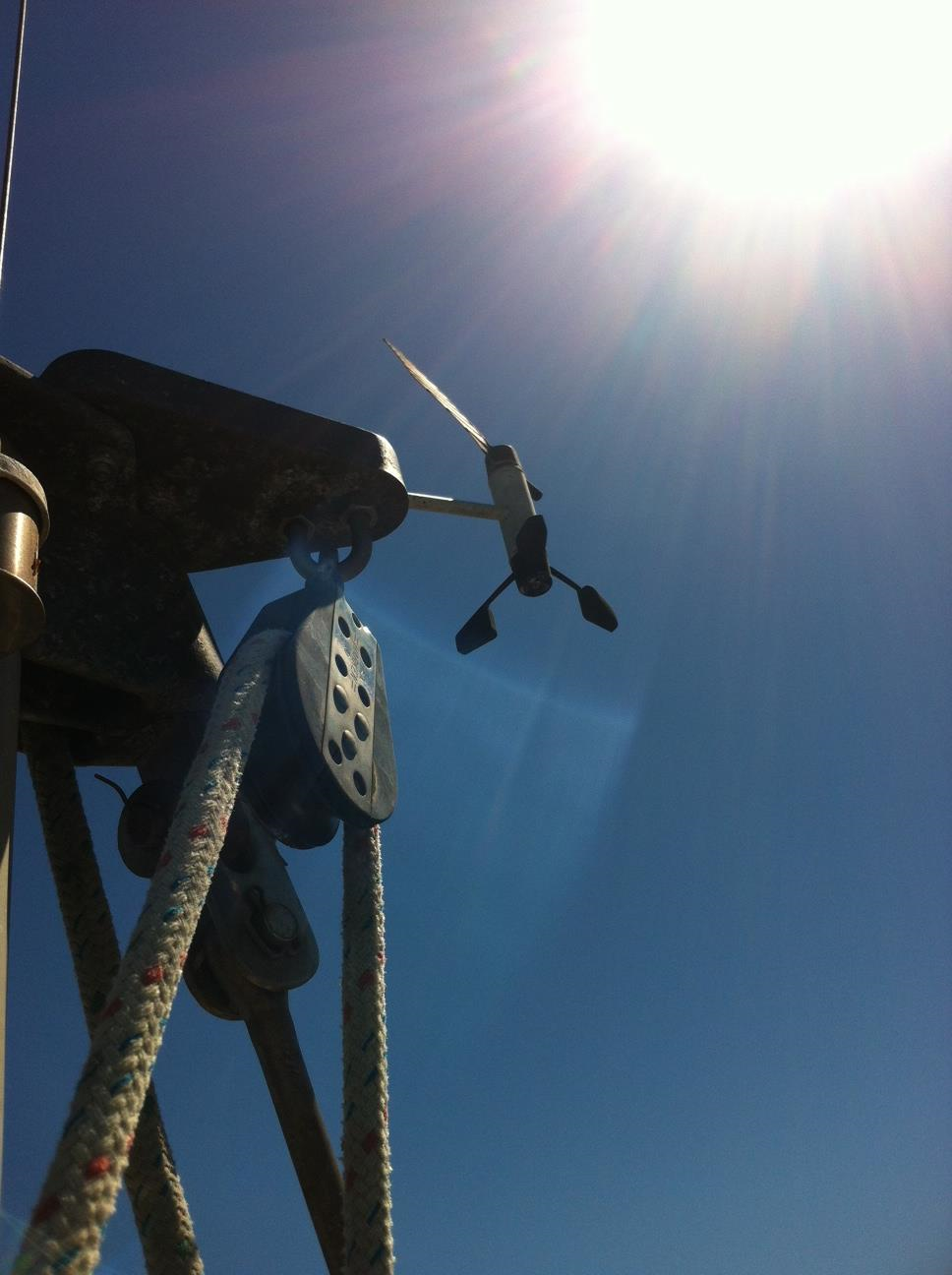

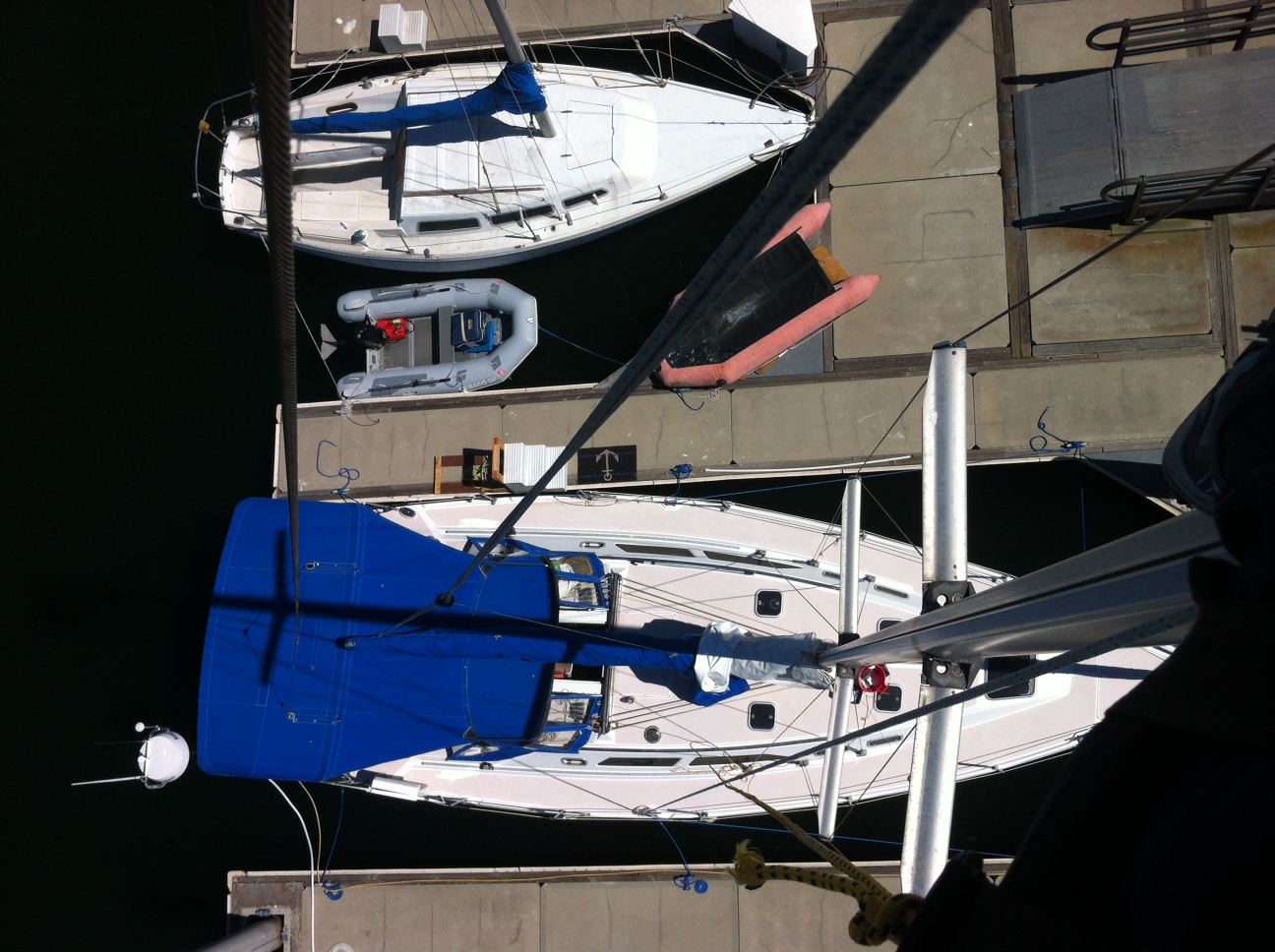

Mast head.png Mast Shot.png Used a mast climber to get up the mast Saturday. Sure enough the vane wasn't turning but I was able to gently move it enough that after generously spraying some McLube into the bearings it began to work again. I was a bit short on time or I would have removed the whole unit and brought it down for an overhaul. I want to be sailing this summer not working on the boat. Here are a couple of photos.

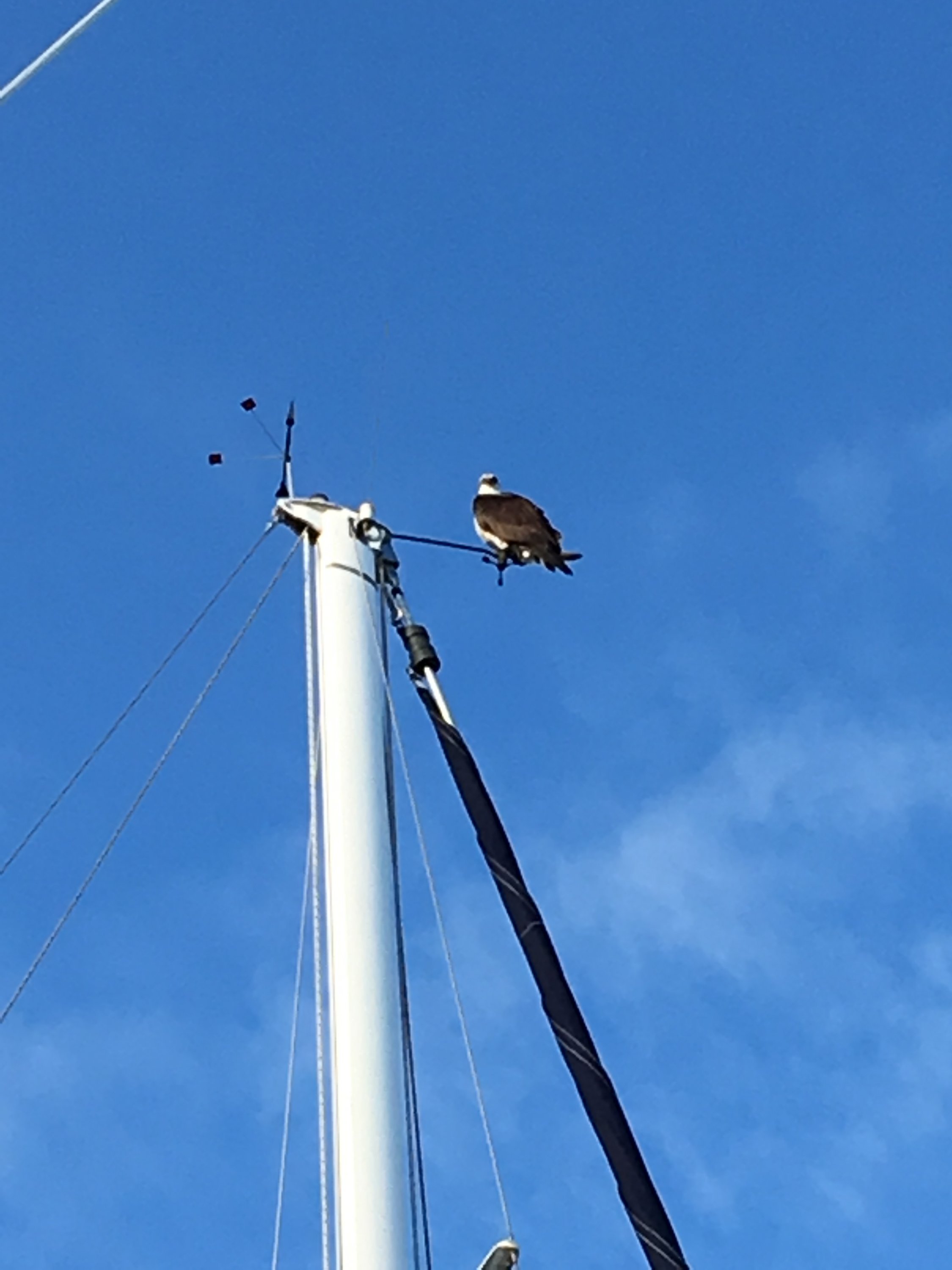

Saw this the other day in our marina. Wonder if this could be a reason your windvane got stuck.
