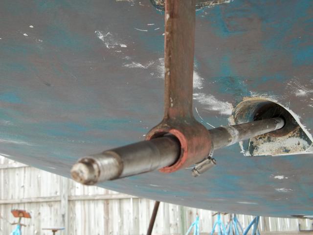

I was having my cutlass bearing replaced when the mechanic noticed my strut was discolored. They recommended I replace it. The boat is only 6 years old? I have had a diver cleaning and keeping the zincs up to date every month. The marina said that bronze has gone soft when it turns pink. They are getting me a price for a strut but I have no idea what a reasonable price is and cannot find a price on Google. Can anyone help me ? I have attached a pic of the strut. Thanks.

You got something bad going on with electrolisis........is there a bond wire on that strut from the inside?
1,715
Hunter 34 Alameda CA
Drill a hole through it and use a pancake zinc on either side. That will prevent any further change. You will find as you drill it is fine inside. Mine looked just like yours 20 years ago and it is still sound.

Yes, there is a problem with corrosion .................
.................. however, if you scrape the surface of the strut with a blade, I'm betting the dezincified surface is no more than a thou or two in thickness. You should look at attaching a zinc or bonding wire to the strut (on the inside) just to be safe.
Right now, I'd say you biggest worry is the mechanic. Don't forget, most of these guys couldn't make it as squeegie kids and that's why they moved over to boat mechanics. 98% of them are completely useless.

Ralph hit the nail right on the head. You know there are sharks out there and not all of them are in the water. Some are going to try and take a big bite out of your wallet. Your picture looks like only surface effects so either scrape it and look for the bronze color to return or after drilling a hole (which you should do anyway) look in the bore and you can see a cross section of your stut. That will tell you how deep the dezincification extends. Because of the lack of serious erosion on the suface, I am betting it is only minor. Make sure inside the boat that there is no wire attached to the mounting screws then use a dedicated zinc for the strut and it should be fine from here forward.

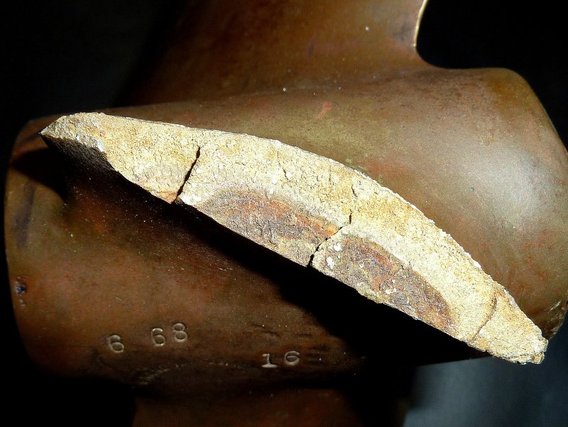

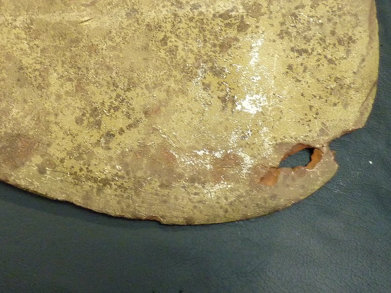

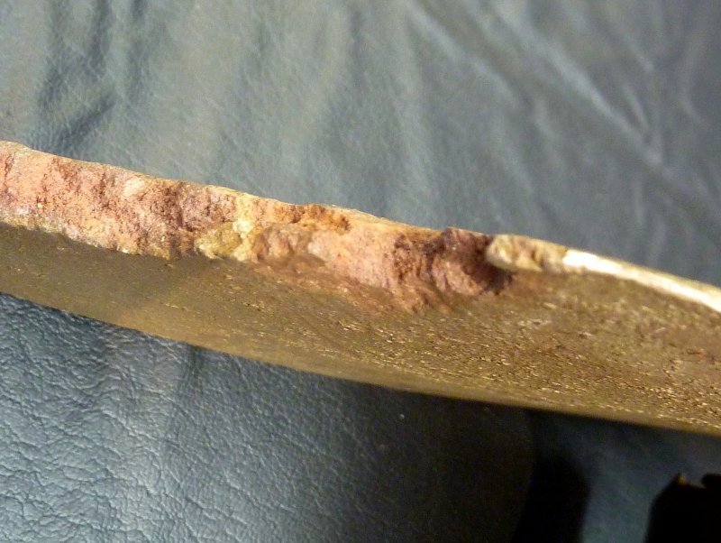

#1 Call Hunter. This should not happen if properly installed & protected. If that is a quality marine strut bronze, as in Nibral, that amount of dezincification almost never happens as there is not enough zinc in it to cause that pinkish coppery color when dezincified. Hunter generally uses Manganese Bronze/421 which is less expensive but really MUST be zinc & corrosion protected. Many builders use Manganese Bronze because it is cheap and strong but the drawback is that it is easily eaten away by corrosion if not protected.
#2 I would clean the entire strut with a burgundy Scotch Brite wheel or soft brass brush on a drill. If it is dezincification I will disagree with the others here that this is a "non-issue". There have been many struts and props and seacocks that have failed from dezincifitation. It can be dangerous and if it fails it will cost you a LOT more to deal with than addressing the problem up front..
I have seen quality marine rated bronze at 40+ years old with zero dezincification while a manganese "bronze" prop next to the strut or rudder shoe is totally eaten away. That is the difference between a high zinc content bronze and a low zinc content bronze. Low zonc content bronze can last but only if protected.
Personally I would not put my name on that strut and send you back in the water either. There is a liability in doing so.
More:
It's not just skin deep:
My own friend at the prop shop flat out refused to even touch this prop, to much liability:

Thank you. I have called Hunter and they want to see the strut. Several years ago I remember receiving a recall notice from Hunter on all thru hull valves. They paid to have them replaced because they were falling apart. I'll keep the community up to date.
Oct 4, 2008
147
Hunter 36 Mulberry Cove Marina
No wires attached.
Sorry but no wires are attached to the strut.
