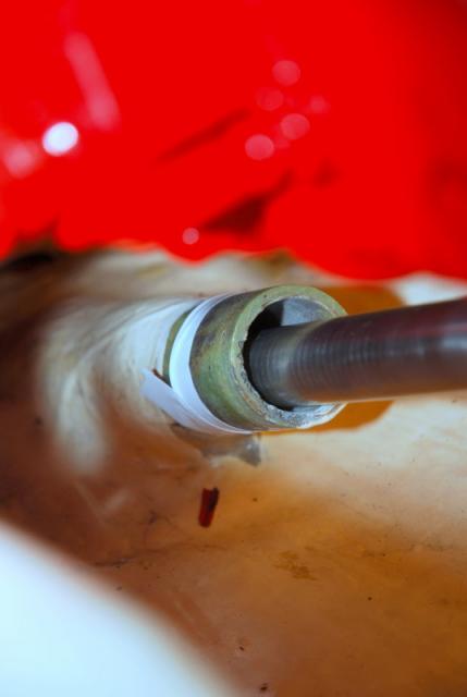

After successfully replacing my cutlass bearing (slid in with relative ease after thoroughly giving the strut a brush job with the drill and putting the bearing in the snow and warming up the strut with a torch), it is now quite apparent that the strut is way out of alignment and this was the real reason for the wear on the original bearing. The settling of the motor due to worn mounts contributed, but most of the problem lies in the incorrect alignment of the strut. How much of a PITA is it to align the strut? Looks like it is glassed in to me. When I inseart the shaft using soapy water it is crushing the top aft of the bearing and the bottom forward and is so tight I can barely turn the shaft by hand. This all while keeping the shaft at the top of the shaft tube in an effort to relieve the pressure.
BTW the Moris "BlackFish" is advertized with a 1/32" wall thickness, and it actually is 3/64" So it seem both manufactures have their specs incorrect. I can live with the 3/64" (.046) but not the .07 that the Duramax "Back" was. The Duramax literally had no rubber in it.
So far I'm very disappointed with the quality of this C310. I can't believe that the factory shipped this boat with the strut so far out. Also the mess I have had with the use of the R&D damper plate which failed after 500 hours and the damaged it caused to input spline of the transmission shaft. I'm F!@#$%ing pissed and will never buy another Catalina or production boat again!!! No quality controll!! Are you listening Catalina!!!

I live ~1.5hrs from my boat, so I haven't had a cold chance to get back up since I discovered the problem on the 22nd. I will get you some pics. next time I'm up. I purchased a flex coupling and want to install it, but this will cause the drive shaft to slide toward the aft by ~1.25". The area on the drive shaft that will now have contact with the packing gland it all bitched up. It almost looks like someone took a pair of vice grips on it, so it will get torn up and leak. Not sure I want to deal with this right now. Convince me to pull the shaft and have it re milled, or shortened please.

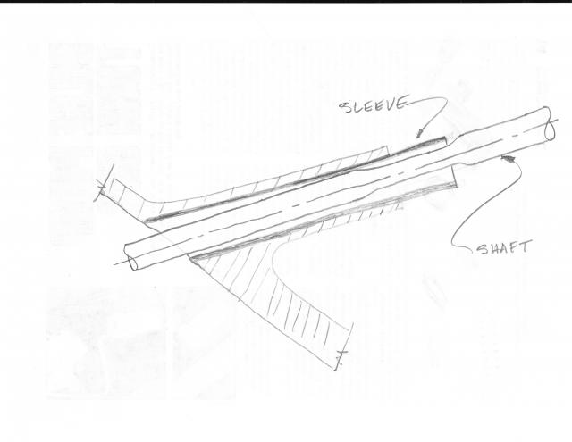

I think the sleeve, whatever it's made of, runs the full length of the log.
You could machine a tapered clearence groove on the shaft.....
You could bore out the sleeve part way down and glass in a new sleeve with larger diameter or change the exit angle of the sleeve keeping the same diameter.....
I'm not sure what Ray did when he installed the flex coupling.
I keep looking at this area of the shaft log in solving the problem because in my mind I could do all the work myself.
Just some thoughts :lastweek:
paulj :troll:

Thanks Paul for taking the time to draw out another innovative solution.
Whether or not I can get the engine any higher by shortening what I believe to be excessive length of shaft tube inside the boat and maybe beveling the top inside (iif I think I can get away with it without affecting the integrity of the tube), I don't know. Also not sure how much of this alignment issue is as a result of being on the hard. I'm going to raise the adjustments on the rear jack stands a little and see if it changes.
