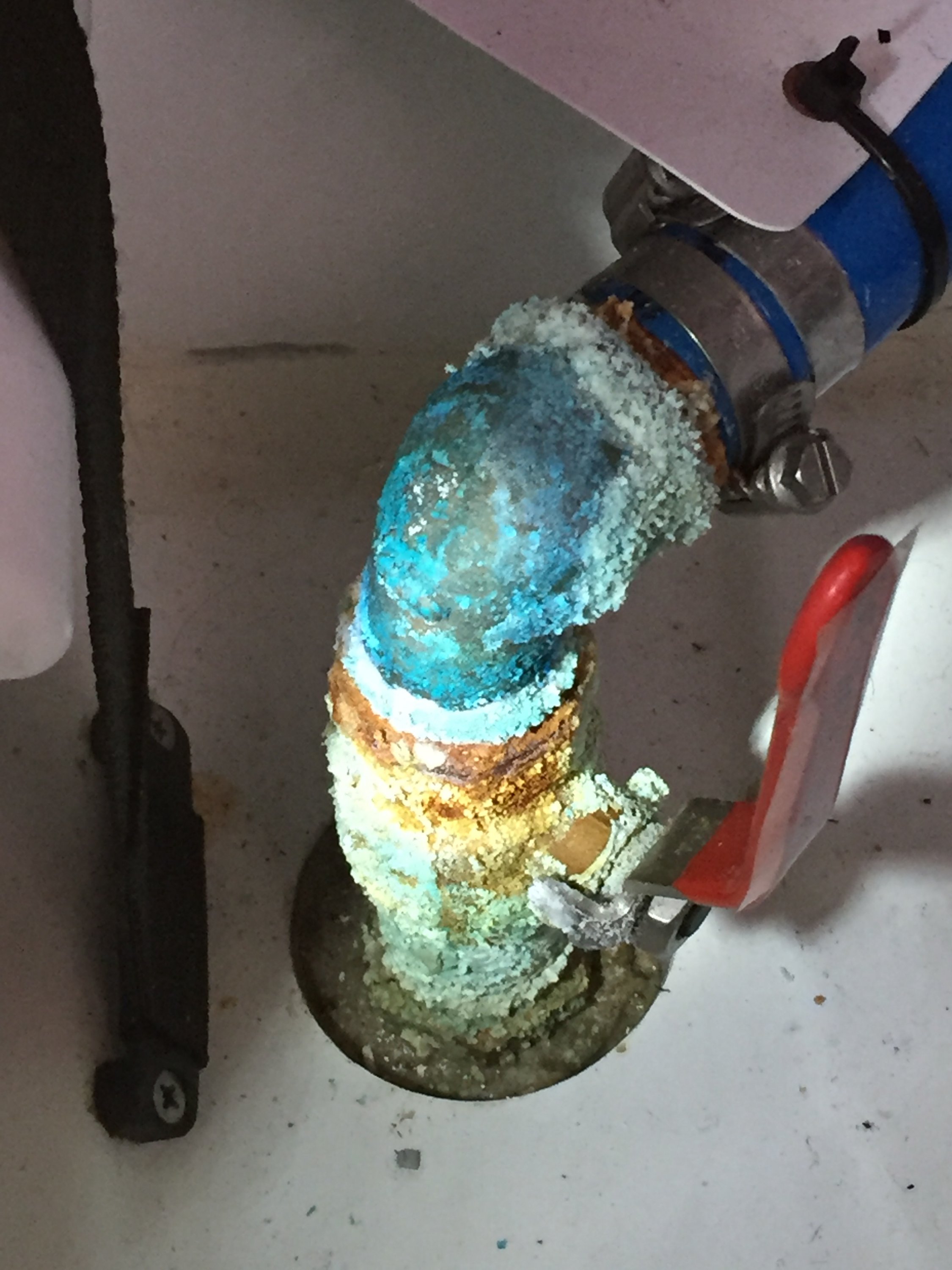

All of the above are interesting. We do have a saltwater washdown pump but have never used it. The throughhull was replaced about 8 months ago because it had been left open and corroded. The new one is closed. I discovered yesterday that our plastic water tank sweats so that accounts for some moisture. We do not have a/c or a genset. We are in the middle of a huge storm sequence, day 3. So the boat movement and heaving are not conducive to crawling around on hands and knees. The pat couple weeks we have been smelling random hydrogen sulfide at random intervals and cannot source that either. We have sealed batteries and the head/ holding tank are not the issue.
You all must be really tired of me. ☹ I seriously appreciate your input. ☔
Posting a pic of our replaced through hull.
JamesG161
Feb 14, 2014
7,931
Hunter 430 Waveland, MS
Sweating or moisture in the air condensing, can only occur when the surface of your tank is colder than the daily dew point.
From watching your weather, you have colder water in that tank when warm moist air hit the Bay area.
Do other boats in your area experience a lot of interior boat sweating?
If you have eliminated any head leaking problem, then the only "renewing" source of a smell has to be...
SEA WATER
Fresh water from a public potable water system that has be chlorinated, should not produce odors, although some public water do stink.
____
Does the smell increase after a motor cruise?
Give a few days after the cruise to have the ocean water critters began to decompose.
Jim...
