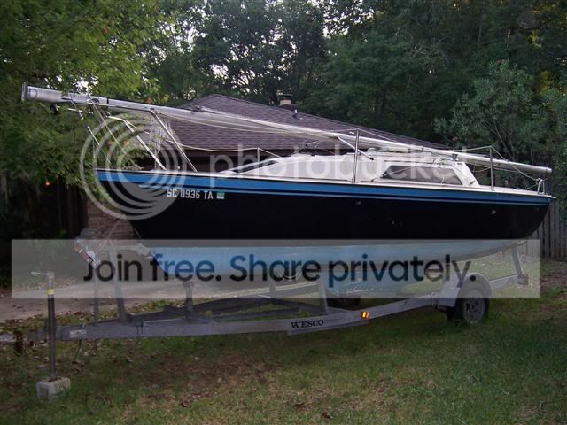

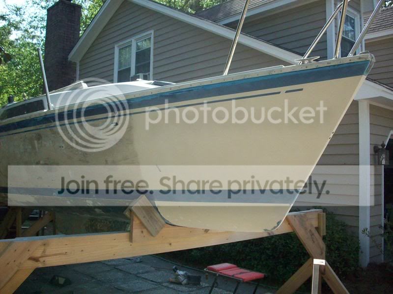

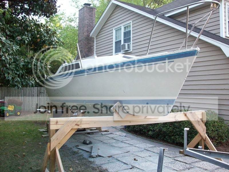

I used Peel Away on the bottom paint. I tried it on the topsides as well with luck, but I found out that I was able to scrape about 90% of the paint off the topsides with a long handled scraper. The kind with about a 4" long razor blade on the end that you push along the surface. I think I lucked out because of poor prep by the previous owner. I ended up sanding the entire surface of the boat with a RO sander with 80 grit paper.
Before
After. I think some of the dark area was some of the hull that I tried the peel away on before finding out the scraper worked as well as it did.
After sanding

I'm intriqued by the way you supported the bow. Is that a 2 x 6 or 2 x 8? What is the the length of the board ? Appears to be strong enough. Could you send me pics of the supports ( front and rear ) ? I need to do the same with mine. Mark

The front support is made up from doubled up 2x8s and 4x4s. If I were to rebuild it, I'd replace the 4x4s to use double up 2x4s or 2x6s so the width would match up with the 2x8s. The boat has been on the supports for around 9 months now (I know, I know) and the has been MAYBE a half inch of sag. The rear stand is built up from 2x6s scraps that I had. If I were to rebuild that, I'd do it the same way that I built the front support (like a big sawhorse). All pictures can be seen here.
