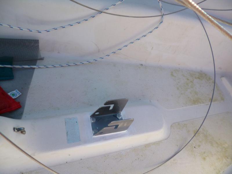

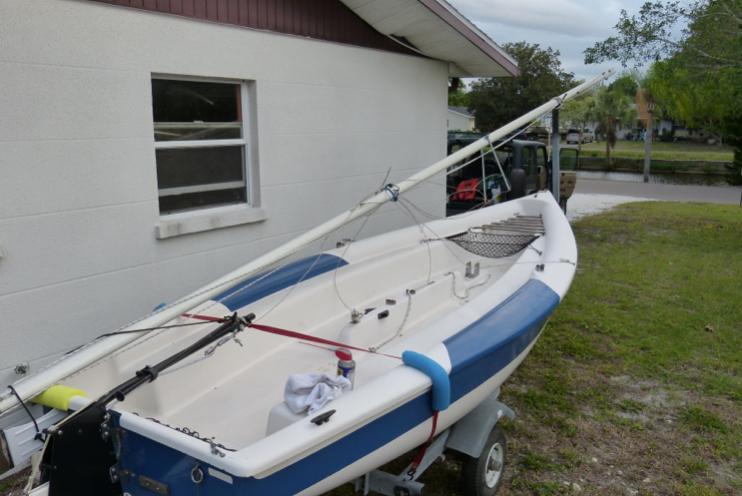

The mast step on a 1987 15 foot American Sail Racer have stripped out. I was going to drill out the holes and fill with a paste of fiber glass resin and fibers. If there are others that recommend a better solution, please let me know.
Thanks. Photos attached

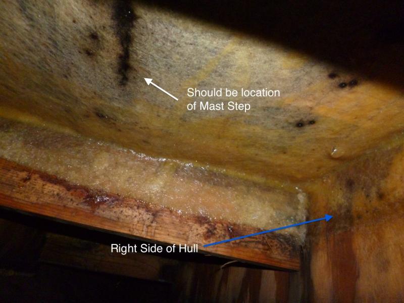

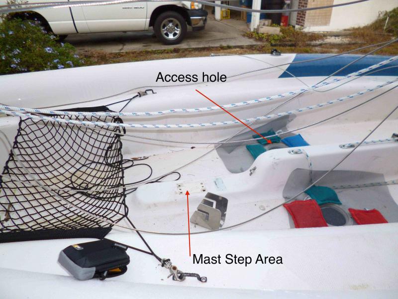

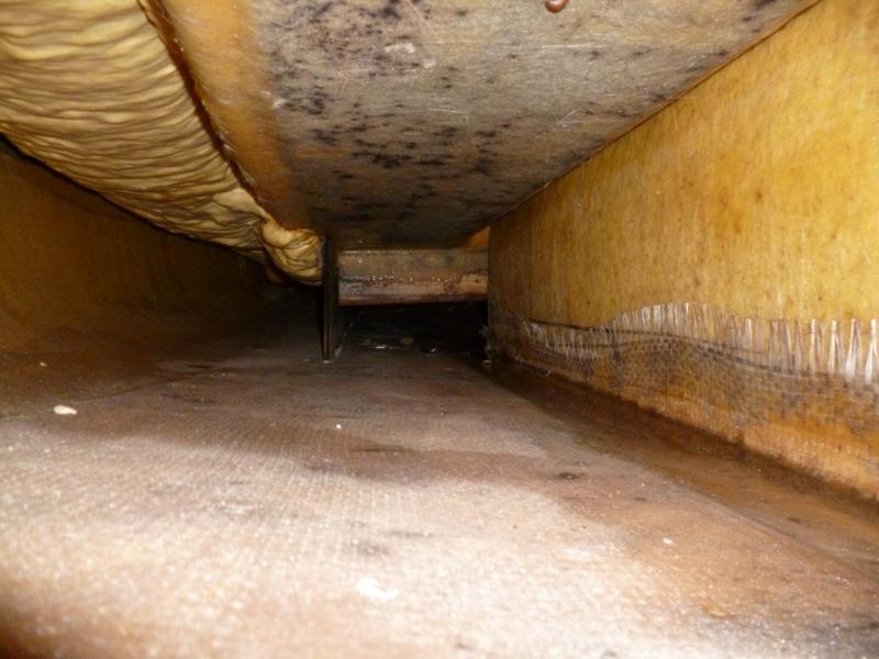

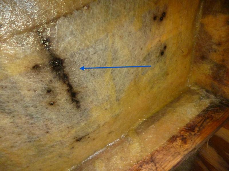

Thank you for the help. The screw holes, about 2.5" deep, don't go through the deck into hull opening. I fished a pocket camera into the hull to check it out and tried to try to get a pic on the spot directly under the mast step. Couldn’t see, just guessed at the location. There is more bare wood then I thought there would be inside.
Photos attached.
The distance Between the access hole and the mast step is too wide to reach by hand.
I think there is a piece of wood under the surface that the screws attach to. That’s why I was going to try the the fiberglass filler after drilling out the holes.
Thanks again for the suggestions.

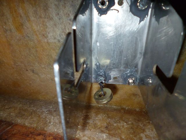

Did the repair
I put on a new mast step, used the old one for backing. Fastened it with SS Bolts, nylon nuts, lock washers and 3M 4000'd the holes, bolts & underside of new mast step.
Because could not reach the underside of deck with hand to hold the backing, I fished bailing wire into the old holes and attached the back plate (old mast step) and pulled it back into place. Again, because I could not reach the location by hand, I had to JB Weld the Nuts to the backing plate a few days before.
Thanks again for the help. Pics attached
