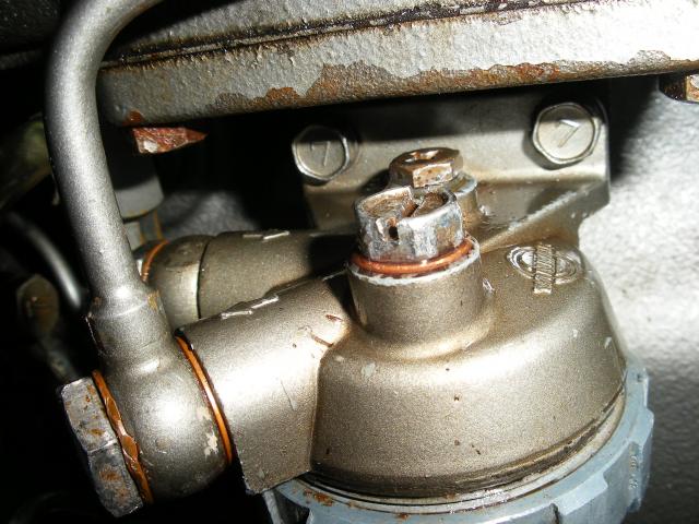

I have a 3GM30F yanmar and the fuel filter mounted on the side of the engine has the threads of a nut (with the copper washer) stripped causing fuel to leak out. Can this be repaired with a helio coil or something or does the filter need to be replaced? If it needs replacement, is it difficult to do?

I think you are talking about the larger of the two screws on top of the fuel filter. This is the 1st bleed screw. Yes. You can retap it with a helicoil. If memory serves it's a M8. Be sure to keep the screw as it's ported. Might also be a good idea to replace the copper washer while your at it.

The filter unit is easy to remove to work on. Disconnect the two fuel lines and undo the two mounting bolts at the top of the mounting flange and it will fall into you hand.
Unfortunately you can't get the "strainer body" as a replacement piece but must buy the whole filter ("strainer") assembly to get it, part # 124790-55601 for the 3GM.

Thanks Don, after reading your comment I found a Yanmar dealer and he said to unhook it just like you mentioned and bring it down and they would put a helio coil or something and I could re mount it. This would be 30 min. labour for me to do it or 3 hours for them to send someone down twice.

Here's a pic of the top of the filter to show you how it's mounted on the engine block.

Yup, thats it Dan. Will pull it off in the next day or two and then get a helio coil installed in it. Thanks.

Well I disconnected the complete filter. (very simple job) and took to to the yanmar dealer for the coil. The mechanic said he would have to charge a minimum of 1/2 hour or $60 and leave it overnight. The parts man said a new one cost $90 and came with a filter, and he had it in stock.
So, for an extra $20, I chose the new filter and installed it myself. (a very simple job):dance:
