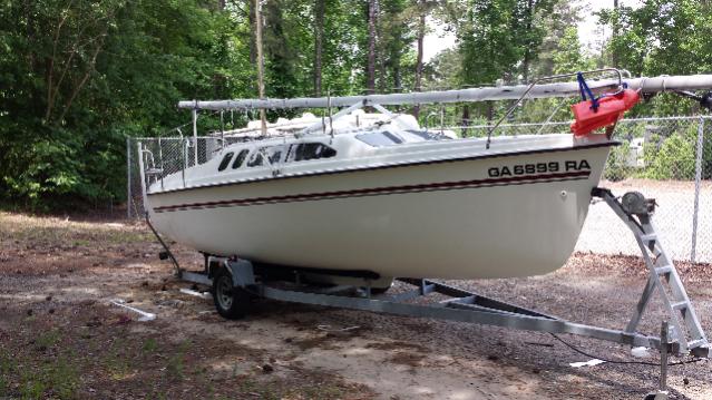

I have a 1994 Hunter 23.5 and am in the process of removing the old striping to include the swoosh, clean, and wax the hull and deck. After browsing this forum I bought the 3M wheel and it works great getting the old striping off. The only problem is that it leaves a residue that is the color of the stripe and makes a mess. Does anybody have any suggestions on how to clean up the residue mess and get the rest of the striping off and prepped for new stripes? Thanks.

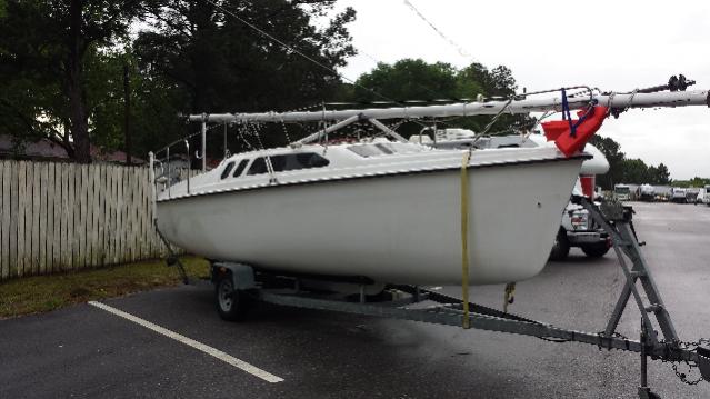

Thanks for the replies. I didn't realize the gelcoat was that delicate that a high pressure washer would cause damage. Fortunately, I didn't cause any damage and am returning to good old fashioned elbow grease. As far as the shadowing, I'm really only concerned about the swoosh because I am going to replace the stripes with the same sized stripes only a different color and spanning the length of the hull.

Project is coming along. As usual, one project has turned into 10 but will be getting it on the lake this weekend.
3M eraser with acetone worked best. A good hull clean and wax with a rubbing compound around the swoosh pretty well as well.
