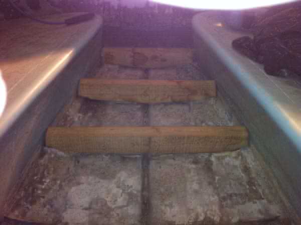

I have a 67 Oday Mariner Fk. The stringers and sole were severely rotted.
I've begun working on the stringers from a template but I'm getting the itch to get her in the water a few times before the end of the season.
I've searched the threads here and am coming up with different answers. Can anyone tell me definitively, are the stringers structurally necessary to sail?
Am I going to risk damage to the hull without them?
I've already replaced the keel supporting ones.

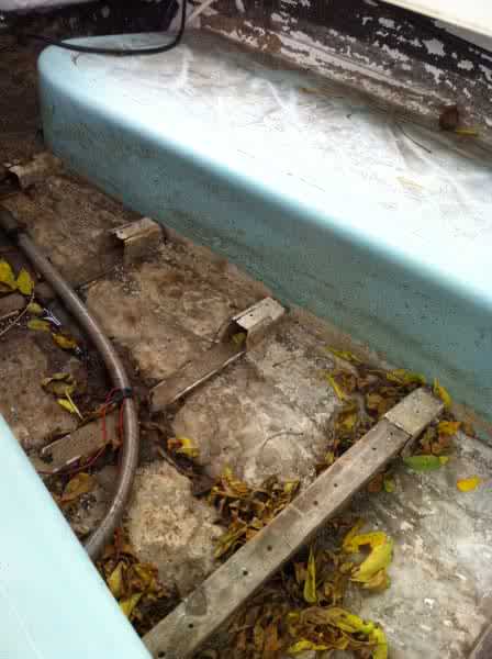

I looked at a few pictures of Mariners of that vintage, it appears that those wood pieces were to support the floorboards as much as anything? One clarification, the ones that I see would technically be "Floor Timbers" or "Floors", someone else refered to them as "ribs" and that is more or less correct as well (although in a wooden boat they would be frames, ribs are a more "landlubber term". Stringers would usually run fore and aft and may connect frames or floors together.
Anyway, to the original question, it would appear that you could possibly sail OK without those floor timbers (as long as you did replace the ones in hte area of the fixed-keel, those ARE needed!)

You guys are right... "Stringers" was not the term I should have been using.
Floor timbers would be more accurate.
I had read two different threads on the topic, one saying the timbers (especially in the cabin) were necessary for structural support, and another saying they were nothing more than a place to fasten the floor boards to.
That being said, it's almost September and I am in Canada...
I think I will chance it and get the boat in the water at least a couple of times this season, then do a proper job on the timbers over the winter in the shop.
Just itching to see how a mariner handles in the bays I'm near on Lake Erie.
Thank you gentlemen for your opinions and I'll keep you posted on my progress.
Thanks for making me feel welcome!

Those pieces are properly called "floors"- a term that naturally causes some confusion, but they definitely are STRUCTURAL. That doesn't mean they are so far gone that you can't sail in moderate conditions. You will have to be the judge of that.
They keep the hull from flexing, support any keel/centerboard weight (could be substantial) and support the mast or compression post. (could be substantial, as well) Secondarily, they support the sole of cabin or hull liner.
