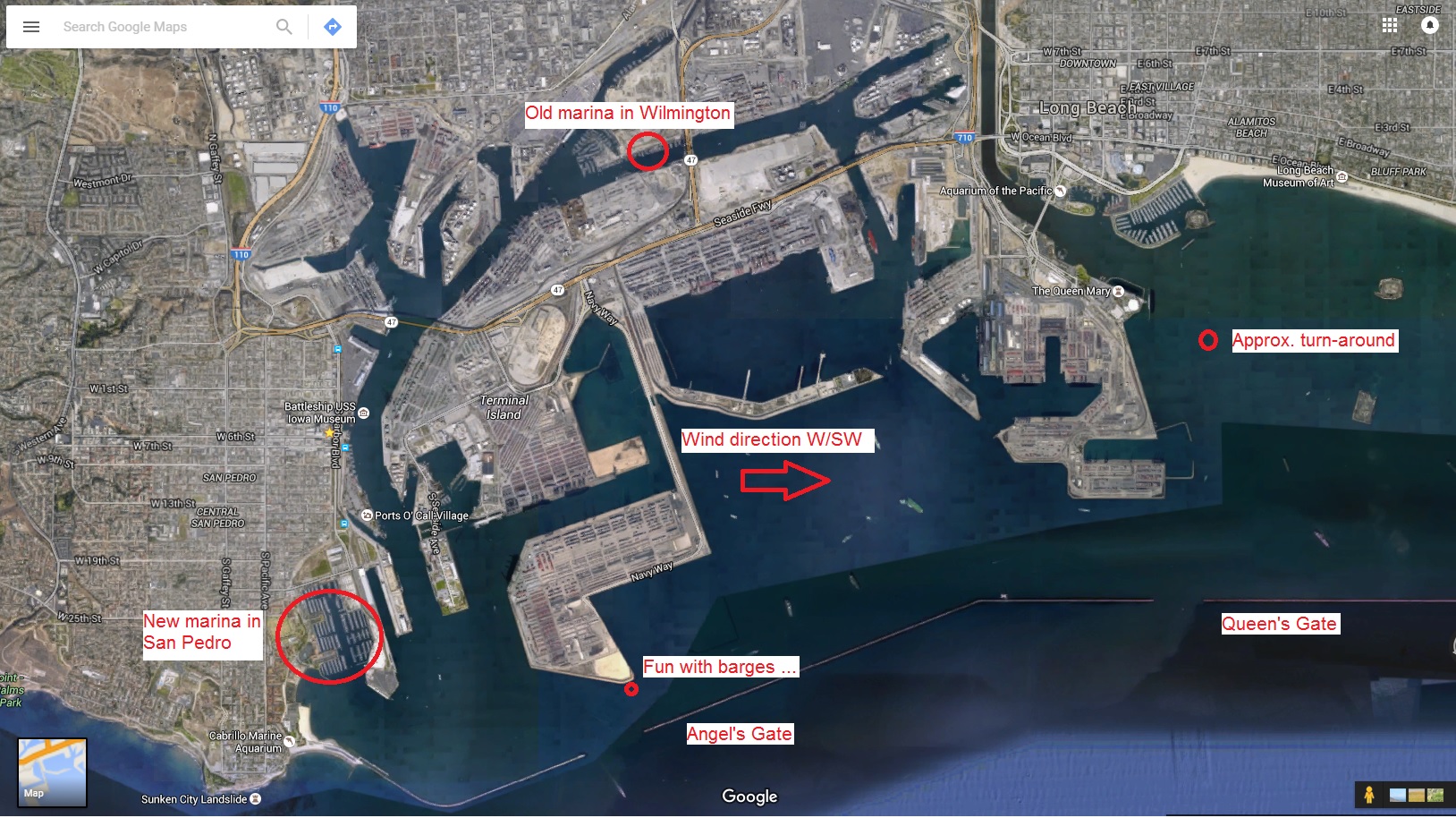

I motored through the channel from our marina in Wilmington, until I got to the open water near Angel's Gate (the Western opening in the breakwater that protects the LA/Long Beach harbor complex), near San Pedro.

I'll post a screen shot from Google Earth showing the overlay from the GPS when I get home later.

Marke--Me mate (admiral) and I have sailed that route many times in combination of inside and outside over the 15 years of berthing in Shoreline Marina, plus we also had the Bavaria at Yacht Haven in Wilmington for a short stint of time near where you likely were slipped. A couple of points to remember. Generally, the wind increases toward afternoon; the wind also increases toward west near San Pedro. Sometimes it's blowing more than 10 kt higher in Los Angeles Harbor than it is in Long Beach Harbor, especially in comparison to near where you turned around in LBH in the lee of terminal island, etc. By all means reef the main to flatten the boat going up---and yes, you probably should have done that in LBH b/f heading back west.
I don't believe the outside route is necessarily the better alternative--it depends. The seas are much more "in your face" on port tack than on starboard tack out there, and the "small boats" I've seen out there "in difficulty" have evidently underestimated the distance required for their outbound tack (i.e., the easier, starboard one), and then try to pinch to make more westing once over on port tack, falling far short of the lay line, ending up too close in my opinion to the slosh near the seawall leeward of them. A couple of times I've seen 'em furl and motor b/c otherwise they're facing another 40-50 minutes b/f MAYBE tacking into a position to pass safely through Angels Gate from sea in the kind of air you're referring to. Big boats do it much better. Their heft allows them to punch through on the port tack heading for the gate and they can do it MUCH FASTER. Also, there is commercial traffic outside as well heading for the gate from the outside. More than once we've had to slow down, tack, or gybe to allow bruisers (as we call 'em) to pass through ahead of us. Yes, it's a bit nerve racking. My recommendation is to keep to the inside in blustery conditions until you feel comfortable doing that. At least you do not have 4 to 6 ft seas to also deal with! [That 6 n.mi. is no cake-walk in 20+ kt--so, don't feel discouraged. Take a mate with you the next time.]

I have nothing to add to King's excellent analysis. I second staying in the inner harbor for the run back to San Pedro. The seas pile up near the breakwater and are tough further out as well. Additionally, there is a lot of traffic going both in and out of the gate, so you may as well be inside. Good luck; that was good experience and you are thinking it through for next time. Good work!

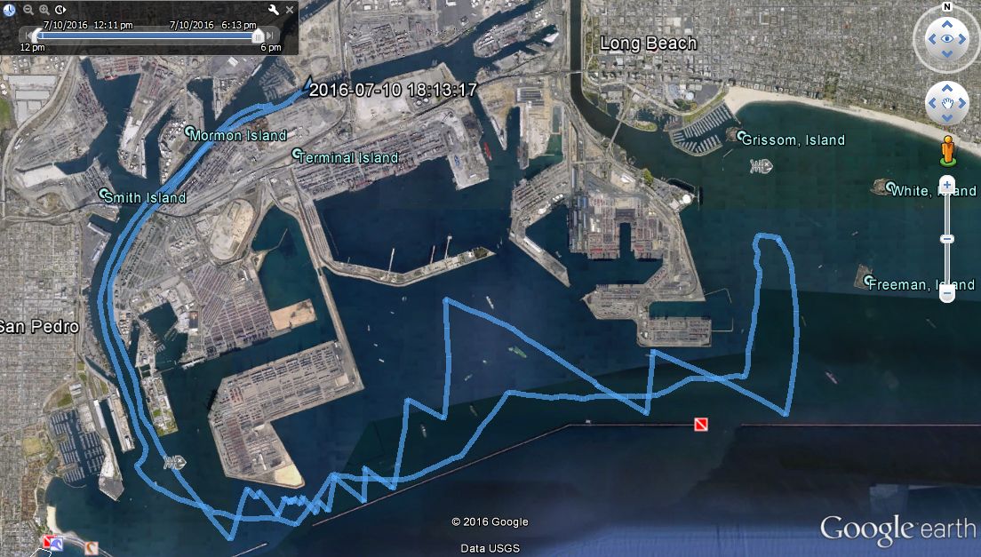

Thank you all for the replies and encouragement. I have noticed the bias toward the starboard tack, I am relieved that I am not doing something wrong!
Here's my course. Urban sailing:

If you're flatter, the long port tack into middle harbor can make much better westing (i.e., sail higher). Also, the last starboard tack b/f heading up toward the harbor channel should go into the gate for a better angle; do not need so much short tacking. It's hard to go upwind efficiently w/ a "crippled jib" or no jib at all; better to reef the main and/or put on a No. 3 headsail if you can get one. Normally, doing this route in that air, my main sail is mostly lugging w/ traveler all the way to leeward, but w/back-stay tightened up, out-haul pulled fairly tight, and the cunningham tensioned, etc. My speed w/ the 135 genoa lets me feather up to stay flat and also keep moving. It's actually a fun trip inside due to lack of seas; I keep the crew pretty busy and on "ready."

Adding to my previous post, I normally stay inside the breakwater in this area if I'm working my way up from Long Beach. As KG pointed out, the seas are a lot more of an issue outside. I've had wonderful sails up thru the inner harbor and some that were just miserable. I've also had wonderful sails up the outside, and yes you have to be aware that the big boys have the right of way but they usually move by pretty quickly. I've also seen some smaller boats have real problems in the late afternoon right by the gate with the wind howling. And yes...locals do call it Hurricane Gulch. There is even a "Hurricane Gulch Yacht Club in San Pedro. Good Luck.
