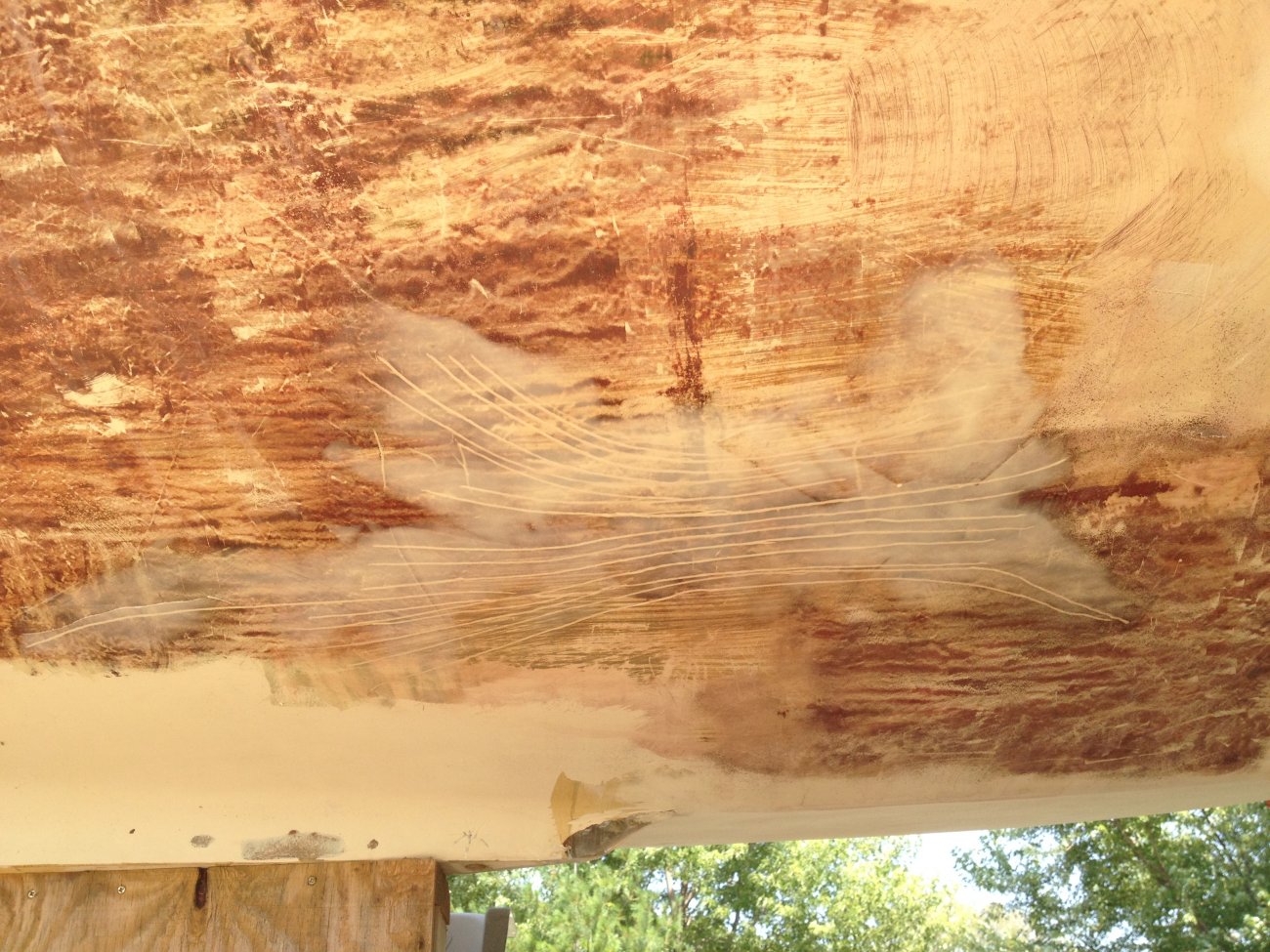

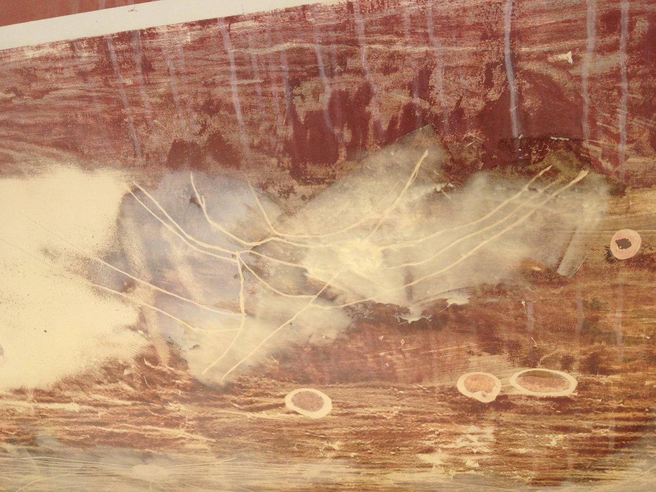

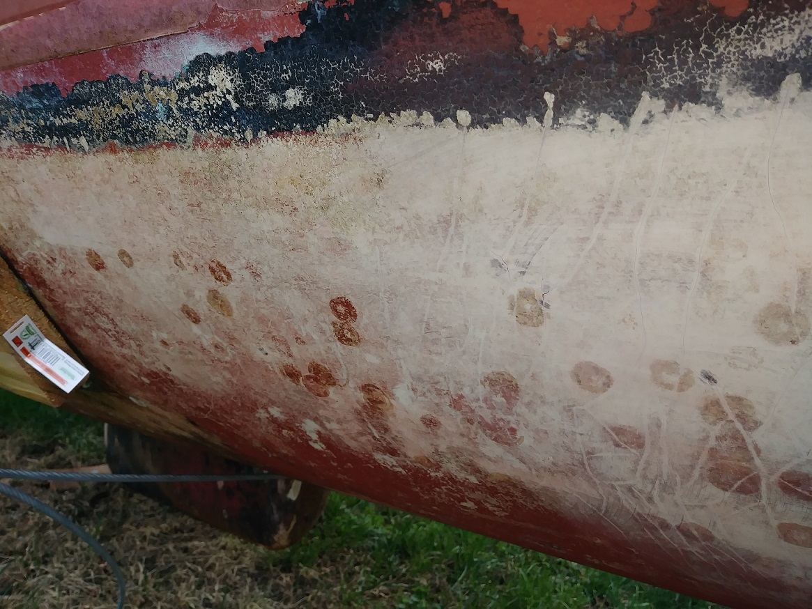

As I've been cleaning up this boat, I have discovered pervasive stress cracks on the bottom. Now I have been aware that the top of the doghouse is totally covered with cracks, as is the area around the toe rail, those areas are bad enough I plan to grind off all the jel coat , add a few layers of new glass, fair paint and nonskid, however, I had at first hoped to get away with the dremel tool - epoxy filler method on the bottom. With the number of cracks I have discovered, I wonder if that even makes sense, Or should I do the same thing on the bottom as the top, grind off all the jel coat, add some glass and refinish from there. Best I can tell, they are like this everywhere. Thoughts? Also, wondering if anybody here has ever turned a boat of this size (22ft) over to repair the bottom...Thanks

Is it stress or did the boat strike something? My guess it would be harder to fix stress cracks, implying movement, versus an isolated strike. Did the trailer cause it?

No trailer.. My guess is that this boat had been in the water until I picked it up. These cracks seem to be everywhere. It spent most of its time in Back River, Md, where it often rested on the bottom due to its very low water level, which goes down even more with the right winds. It had sunk at one point, however, I do believe the cause of that has now been fixed. My thinking is similar to that of yours, that even if I fill all of the cracks, new one will continue to appear, that's why I'd consider redoing the whole bottom, preferably with s-glass and flexible epoxy, followed by barrier coat under the bottom paint...

Those look superficial to me. You don't want water intrusion but I certainly would not grind out the gel coat. Instead I would concentrate on creating a very clean surface and then put on multiple layers of barrier coat epoxy paint followed by a hard enamel rated for below the waterline (to protect the epoxy from UV damage) and then (if you are going to keep it in the water) end with an anti-fouling paint. If you are going to mostly trailer and launch, I would skip the anti-fouling paint and stop at the enamel.
I have flipped (as in bought cheap, fixed and sold) seven older boats so I have actually done a lot of this sort of work. I would not recommend turning the boat over unless you first remove the keel and even then I would be a little nervous about it.. But I don't think you need to do that if you are simply going to barrier coat the bottom.

It looks like the cracks are in gelcoat. Usually that means the laminate deformed underneath the gel coat. Deformed doesn't mean structurally failed. Could be short term impact or longer stress on the hull. I don't think I'd freak out about this. If there is no water intrusion, I might do the barrier coat but maybe not if dry sailed. Bottom paint if not dry sailed. There is practically no repair of a boat that is a 12 year fix. Don't chase your tail about this. Take it out sailing.

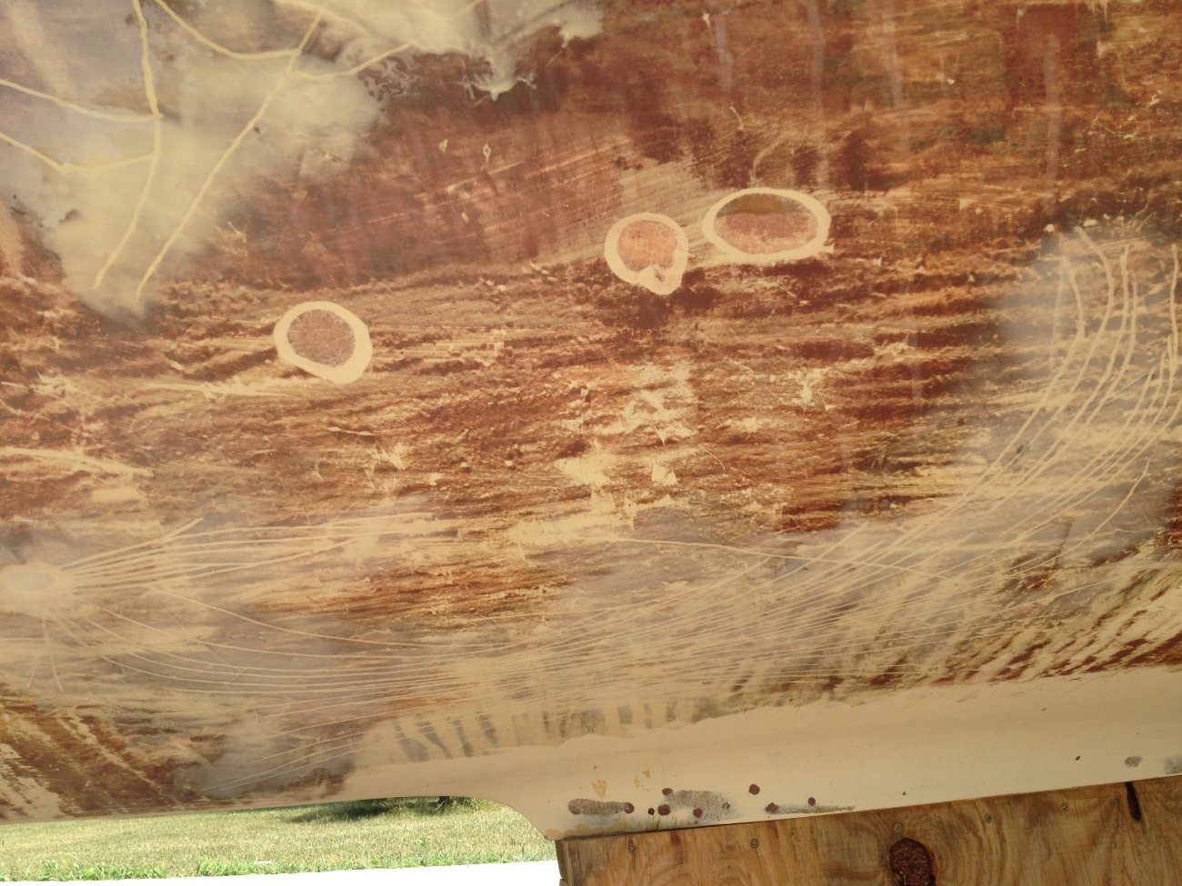

I had even more of the same on my H25 rebuild. I dremeled-out the cracks and filled with epoxy mixed with fumed silica and micro balloons. Lots of sanding afterward. I will epoxy barrier coat and then epoxy prime before bottom painting.
I carefully ground out or gouged out several of the cracks and looked with strong light and magnification to determine if it was just gel coat or into the laminate. I even did a dye penetrate check on several. I never found any that went past the gel coat except a couple times into the first chopped strand mat. The structural lay ups were never cracked.002.JPG 001.JPG 003.JPG
