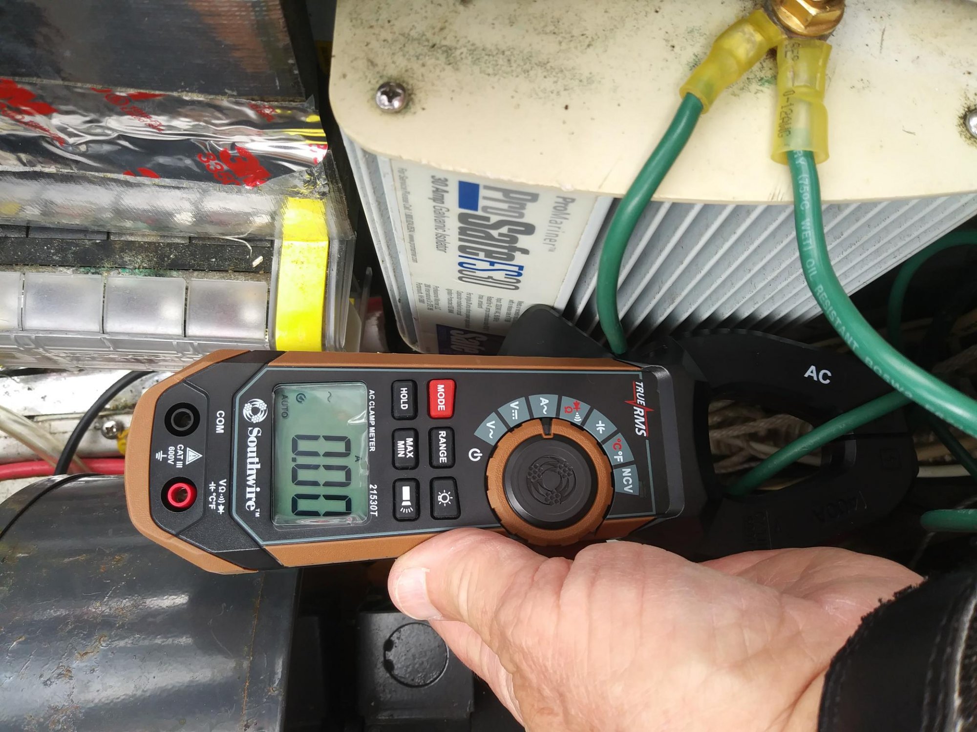

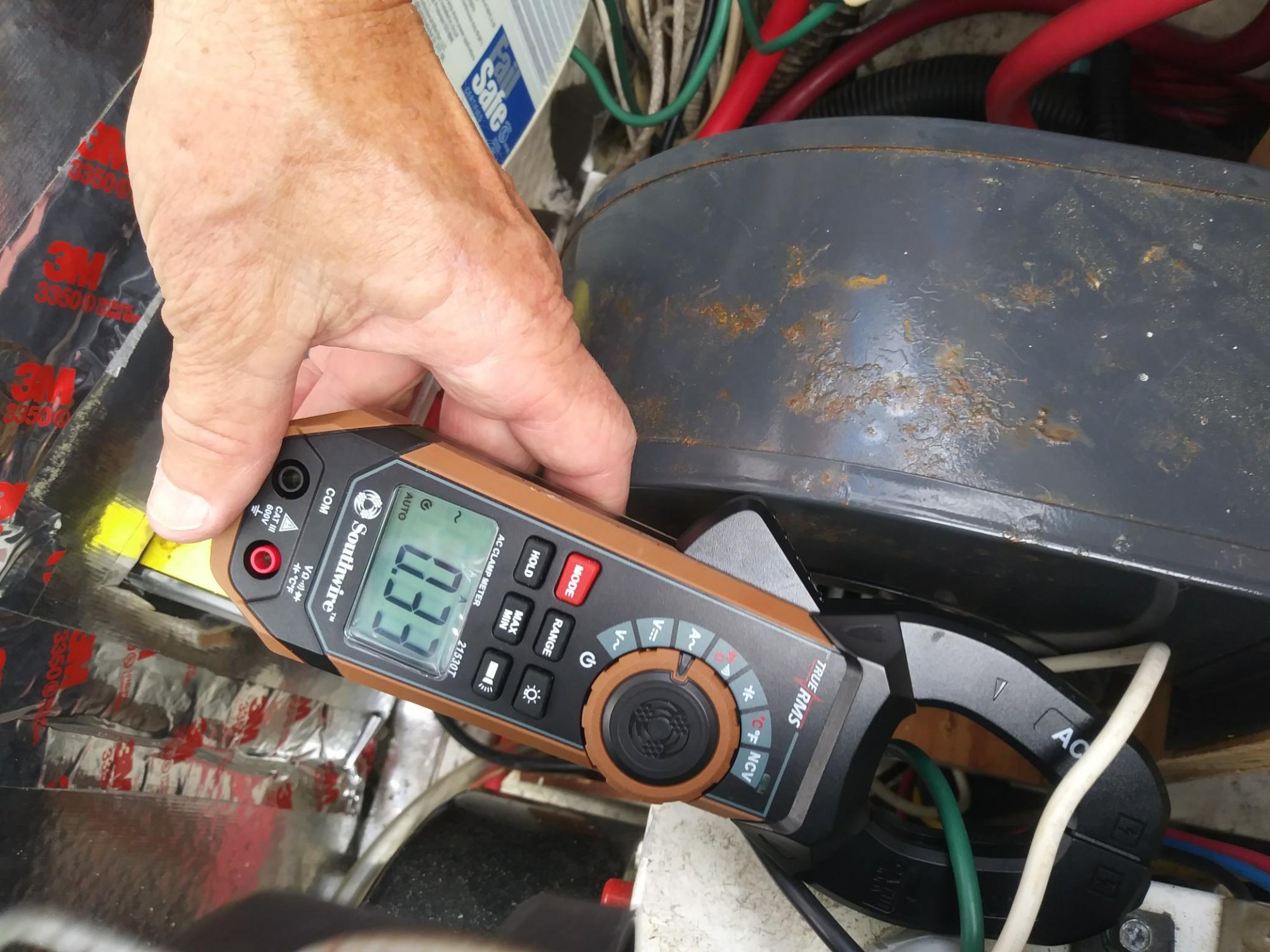

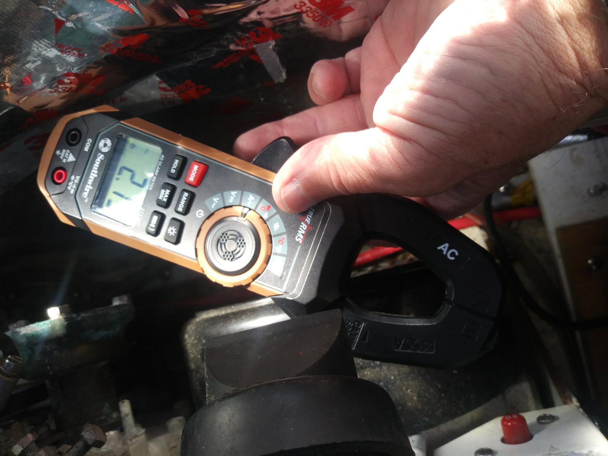

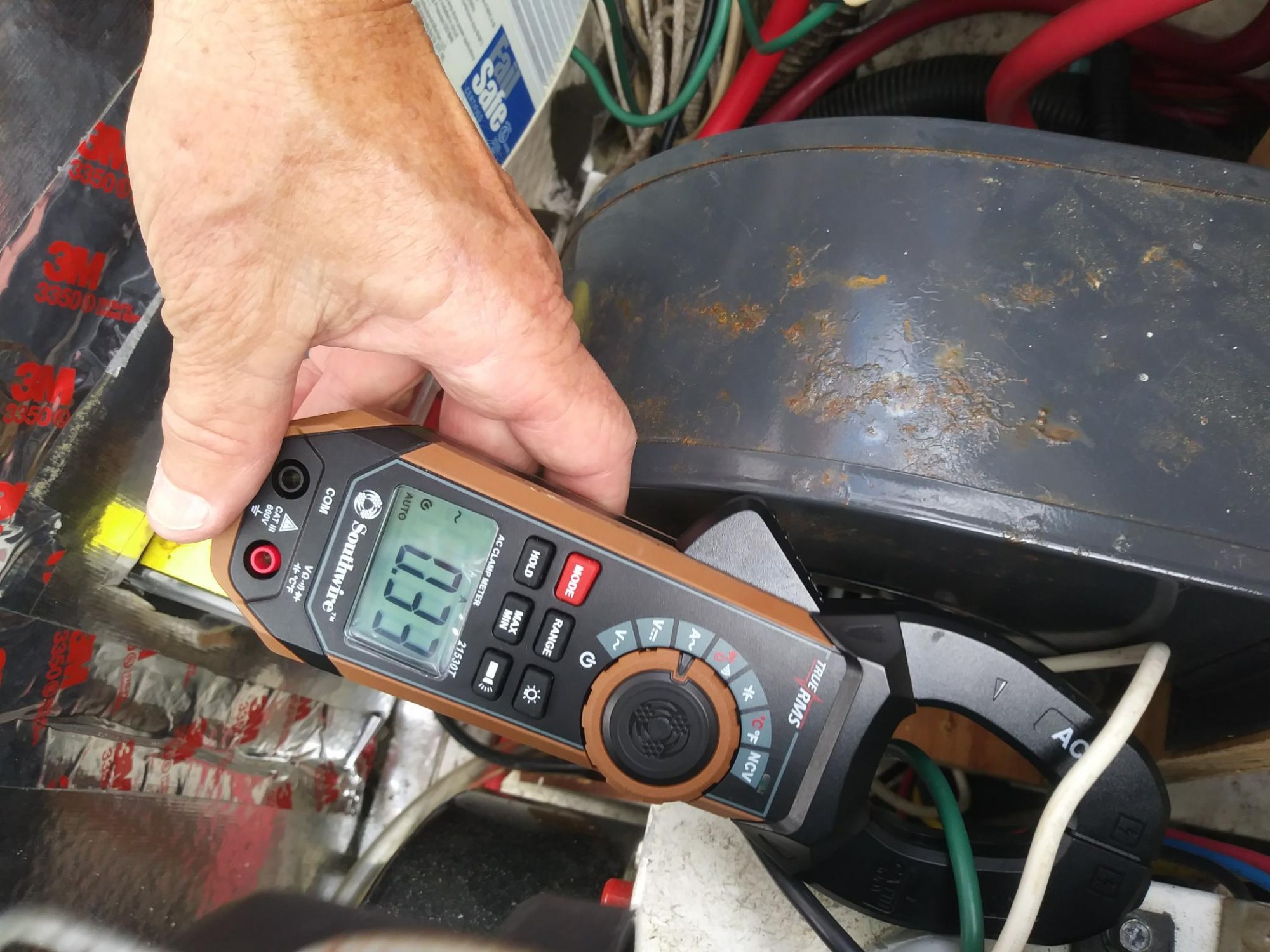

When my Generator is running and I measure the current on the Green Wire shows 0.33 A with the reading taken very near the generator electrical end. When I measure on the exact same green wire a foot or so away from the generator it reads 0.0A See the pictures below.
I am guessing that the 0.33 A is simply some sort of induced current because the instrument is so close to the generator. Otherwise, how could there be 0.33 A at one point on the wire and then 0 A just a couple feet down the same green wire? Both measurements on the picture are on the same wire.

Like the idea @Davidasailor26. Take the induction current out of the equation. There are no other connections or junctions between the two points measured which is what is the conundrurm. Hard to explain why on the same wire there are two different readings other than an induced current from the magnetic field around the generator.
I may also re-route the wire (it goes under a board for about 2 feet) to where I can measure along the entire length. If the reading drops the further I get away from the generator then it is most likely induced current.

Interesting theoretical discussions. When I first measured the current at the location near the generator where I could each the wire easily, I was checking to see if I had some fault in my wiring since the green wire should be 0 A and only carry current if there is a fault somewhere. When I saw the .33 A I was worried that I had a fault. That is my concern and it looks like I don't need to worry about it. I may still try the direct reading ammeter suggested by @Davidasailor26 just to give my self piece of mind.

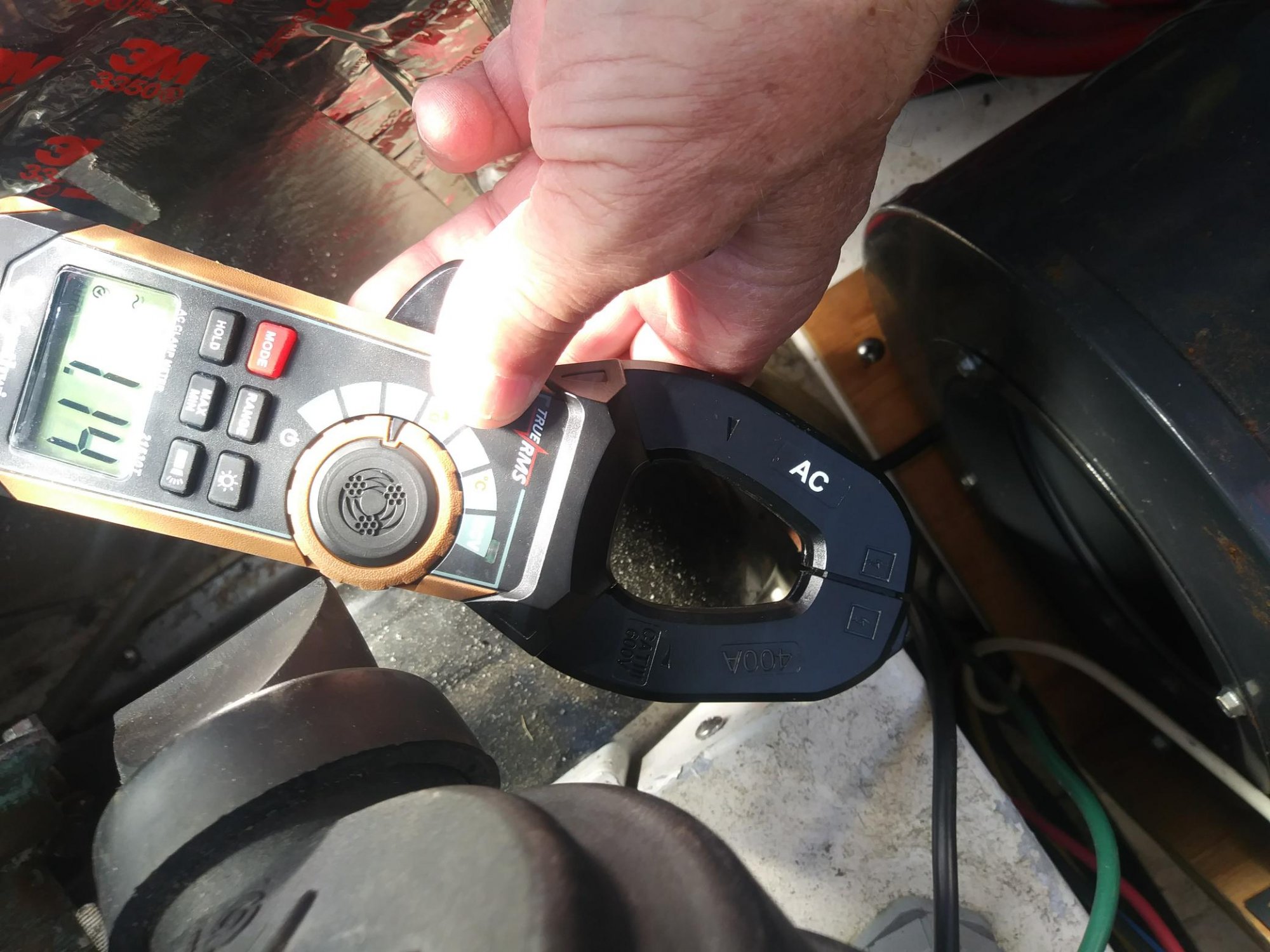

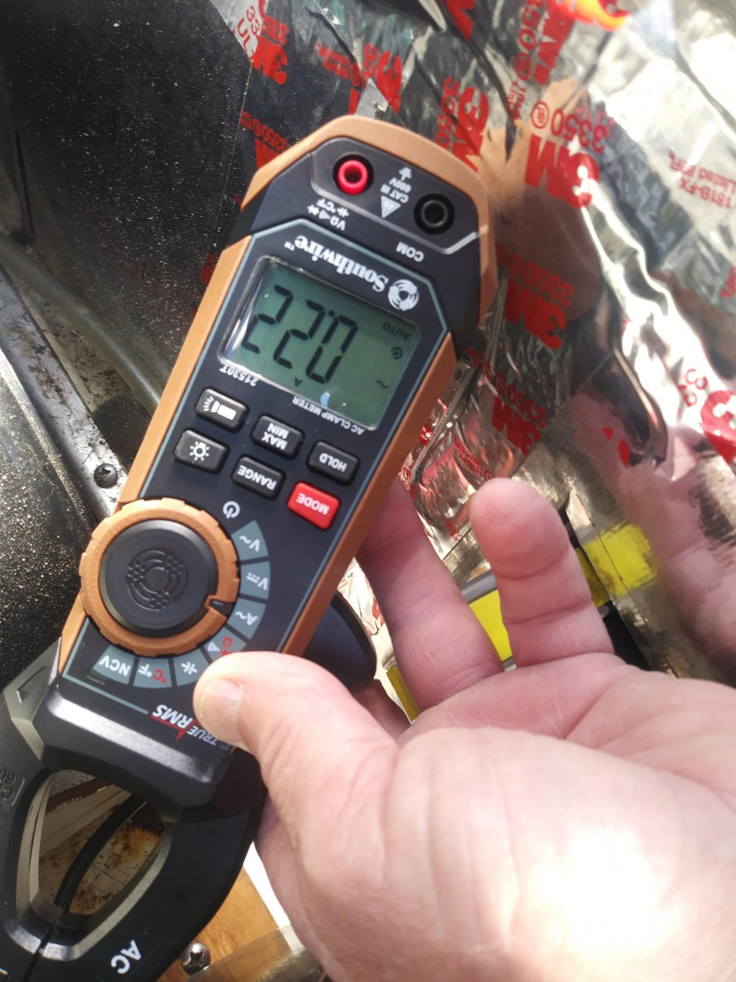

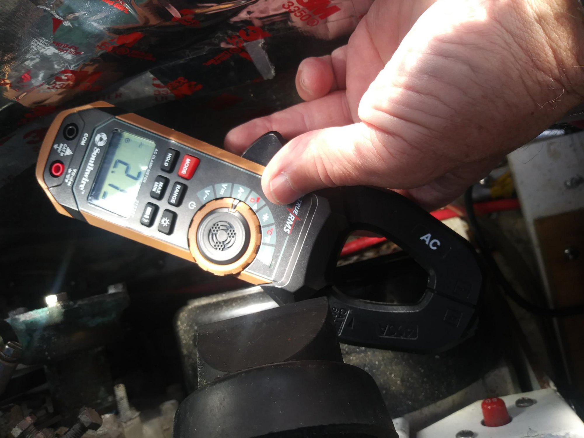

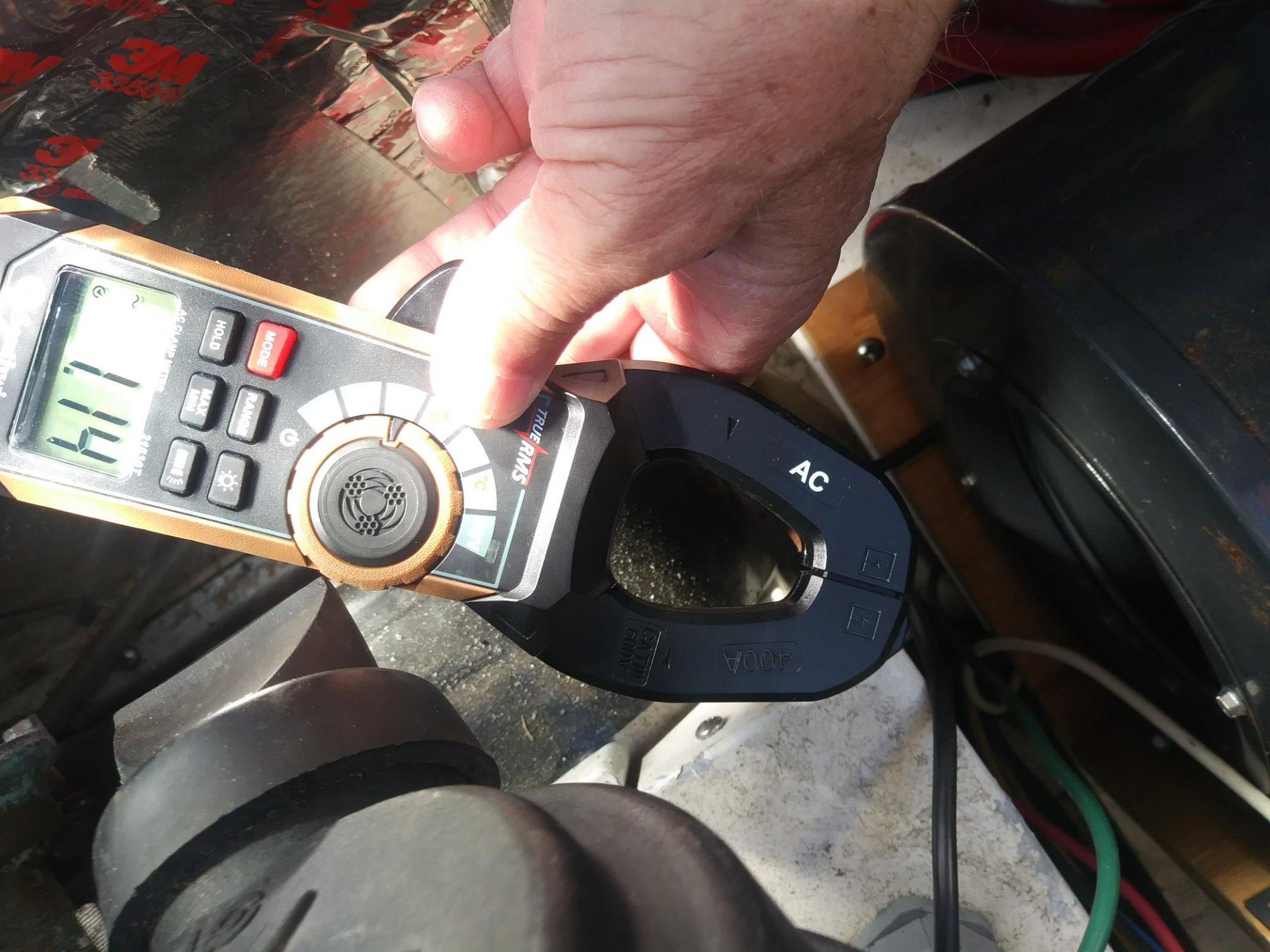

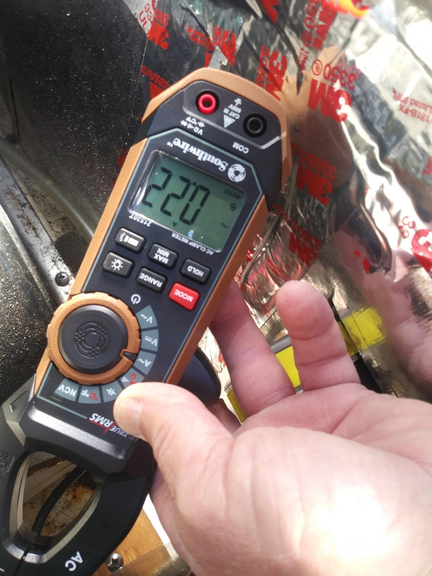

Update - I measured the apparent current at different locations in the vicinity of the AC generator end and the reading varies by a considerable amount by location and the angle the hand held instrument is held. This was done with no wire at all inside the enclosed loop so its clearly the effect of the magnetic field from the generator and not any actual current in a wire. You don't have to get very far away from the actual electrical end of the generator before it drops off to 0. Something to keep in mind if you are trying to use one of these types of instrument. Not surprising but I am now comfortable that there is no actual fault in my wiring.

@dLj Probably a foot or so should be fine. It dropped off pretty quickly as you moved away but I did not take it to 0 to check that. I was about 18 inches away (ballpark) when read I read 0 in the picture in post #1. I attached pictures. The best thing to do would be to take a reading adjacent to where you ae trying to measure with nothing in the loop and make sure its 0 there and then measure with the wire enclosed in the instrument loop.
