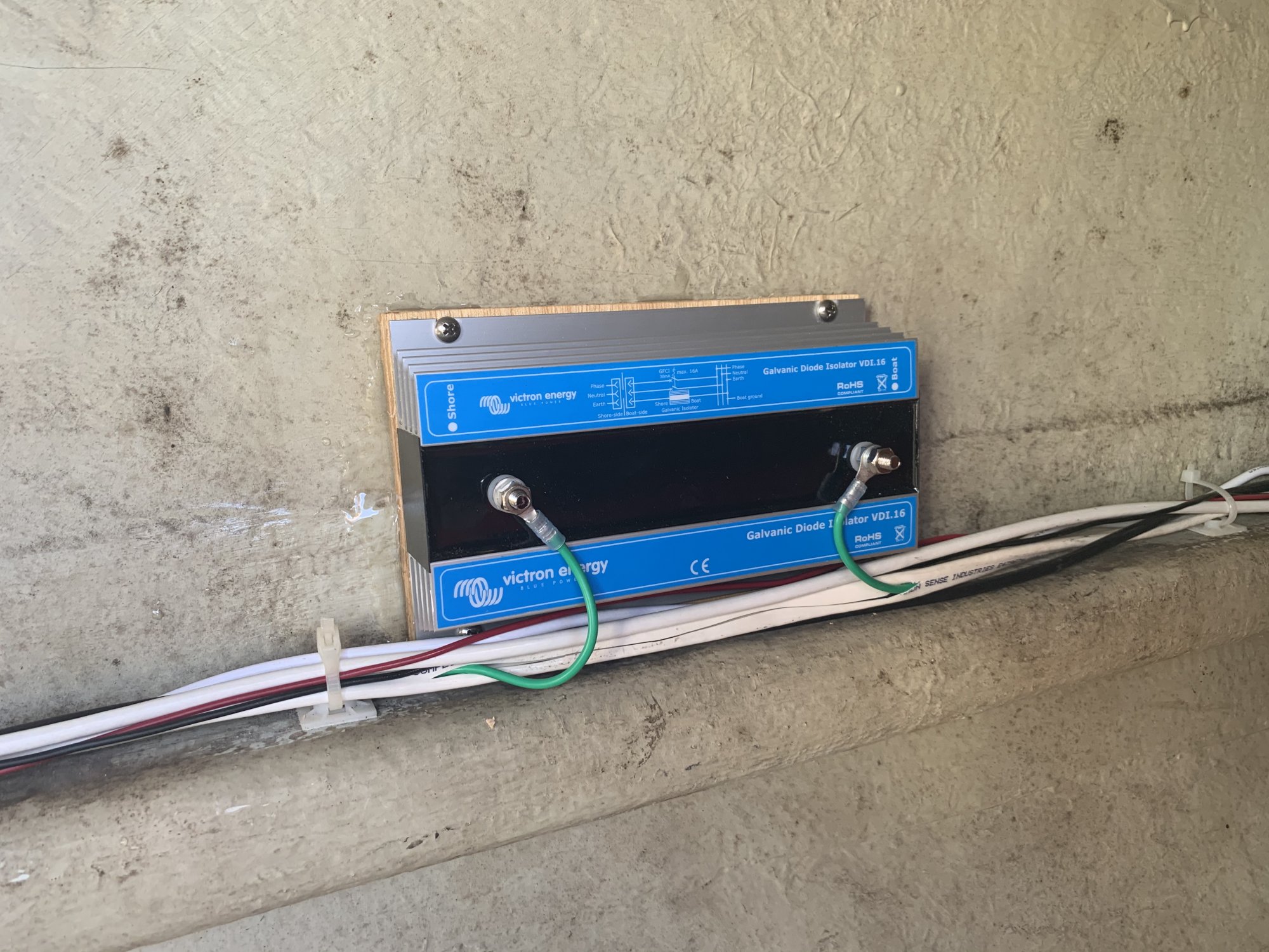

I have a GI , ELCI and surge protection on my A/C . My GI has a display showing if you ever have A/C or DC leakage. I'm on my 3rd year same anode on prop and can still read Martyr on it. Before installing GI ,I would get rust spots on my cast iron keel.
We also have the docks GFI protected. If one boat leaks it shuts the whole dock down . Most common leakage is the element on hot water tank ,then battery charger

If you have a GI you are a good actor.
For years I was the only boat at WYC with proper shore power setup. Per AYBC, my AC earth and DC ground were bonded. Every year, I checked my sacrificial anode on my prop shaft. Every year, it looked like new.
last year, some new boats with home-brew AC systems arrived. And my anode suffered.
so this year.
but having one of really more like a CoVid mask. It’s not for your protection as much as being kind to others.

A galvanic isolator is a device used to block low voltage DC currents coming on board your boat on the shore power ground wire. These currents could cause corrosion to your underwater metals; through hulls, propeller, shaft etc.
What you are saying is totally not true ,its to protect your boat as well as others. Also if you don't have a display it's not ABYC compliant
I believe that there is no longer a requirement to have a display as long as the unit is fail safe. The changing standards are confusing.
https://www.deimarine.com/media/wysiwyg/documentation/GI_Liability.pdf is a good read.
One way or another, a ground fault interrupter, as close to the incoming power connection as possible remains a huge safety asset.

Of course it to protect your self as well as others, you're over-reading my point.
And BTW, to be AYBC complaint, modern fall-safe GI isolators DO NOT need a display.

True ,mine is 3 years old and fails safe ,however without a display you do not know its failed and is now not protecting your boat as it is now possibly passing current, The ELCI which I also have is only measuring a balance on neutral and hot on A/C that you are using . If the boat beside you has a leak and bad ground ,it travels thru the water to your boat and thru your ground ,eating your anodes as your GI has failed safe
