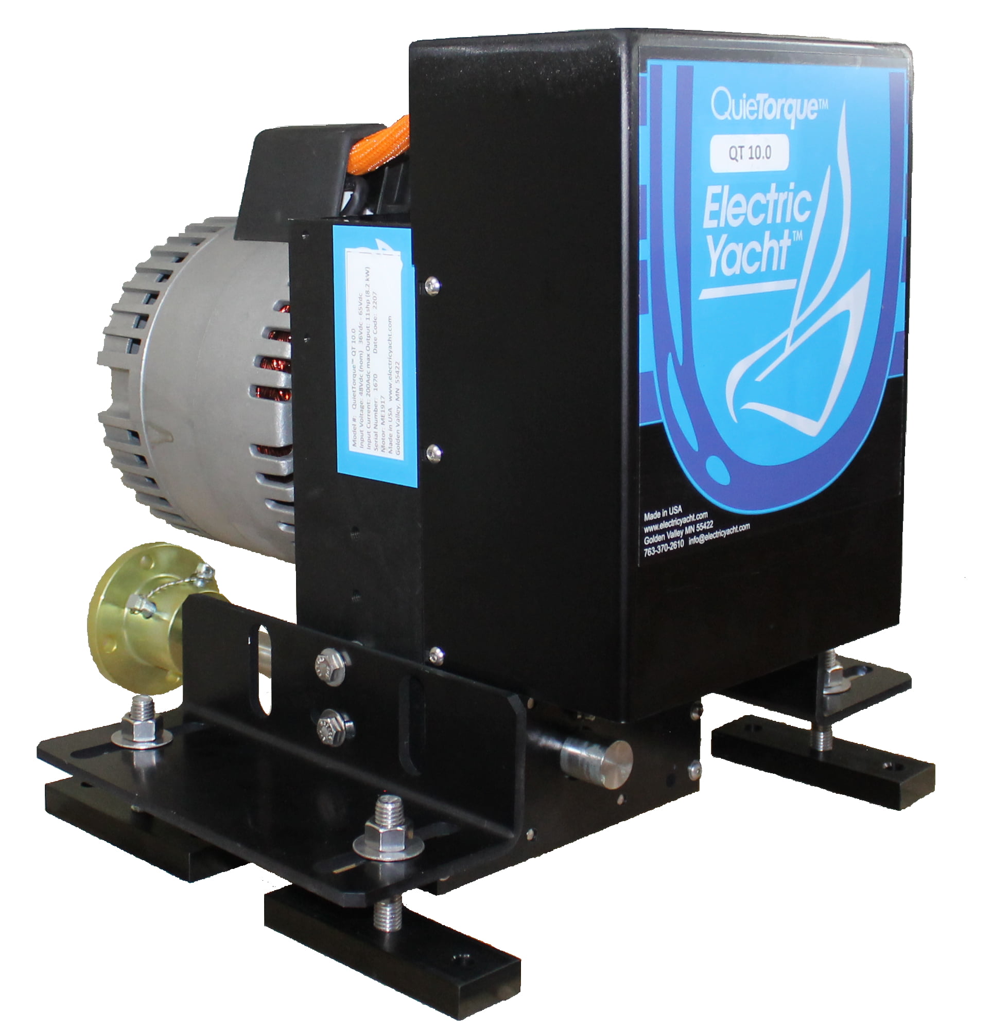

simple direct drive as far as i can tell. pretty much exactly like a power drill. This is the motor she has. I stuck my head in the engine bay behind the engine while motoring. The noise is definitely coming from the exterior. The motor sounded and looked to be working normally.
I hadntt thought about the zinc though. Maybe it came loose.
