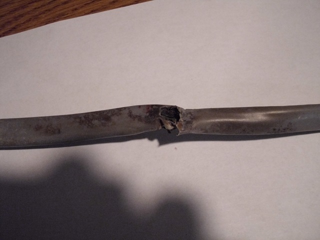

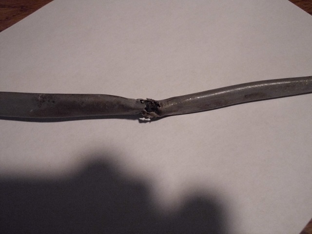

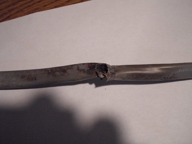

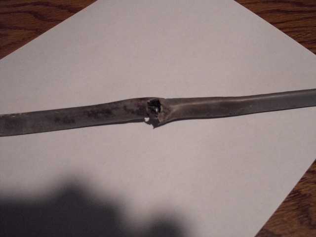

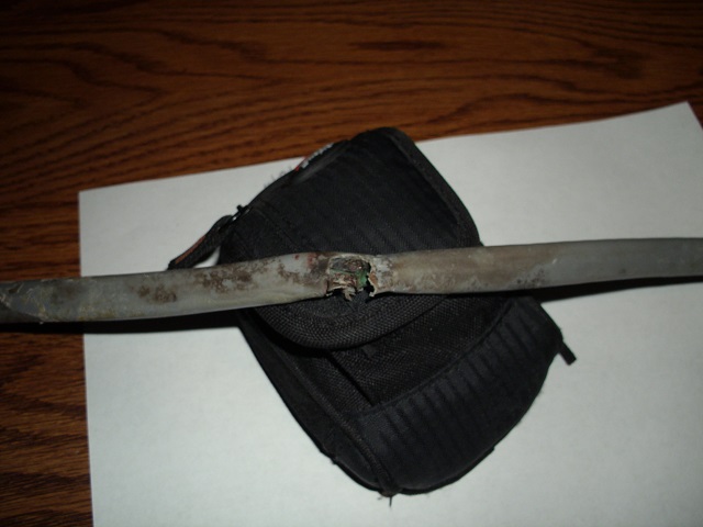

All, Sorry in advance for the long post. I had a rather strange experience today. I have been in the process of upgrading the shore power system on our N28-2. So I get the old panel such as it was removed, enlarge the opening for the new Paneltronics panel, run a new 10ga wire from the shore power plug to the panel, and hook it all up. I temporarily hooked the old outlet wiring to the new panel for testing. Everything was looking good. Plugged in one of my power tools, and turned it on. The circuit breaker immediately tripped, as well as the main 30A breaker. As the breaker tripped, the reverse polarity LED lit. So , back to the shore power plug. Verified it was wired correctly. Checked the wiring at the panel, which was also correct, restored power, and tried again. Same result. Both the circuit and Main breakers tripped and the reverse polarity LED was lit. Got out the DVM., Thinking that the marinas power was faulty. Started checking voltages. Checked the voltage at the panel, saw 120 from hot to common, and also to ground. That looked good. Checked the voltage between common and ground, and saw about 60v. Now that should not be. So I scratched my head a bit, trying to figure out what was wrong. Checked the voltages at the end of the shore power cable, and got the same voltages. Ok, so I think to myself, that the marinas power has a problem. Check the voltages at the marinas plug in, and found 120v from hot to common, and to ground, just as it is supposed to be. Checked the voltage between common and ground, an it was 0v. Again just as it should be. I had brought a new shore power cable to replace the old cable that came with the boat. There was nothing visually wrong with it, but I had a new cable I had purchased for the CM26 I rebuilt last year that I wanted to use. Plugged the new cable in, and everything worked perfectly. Able to plug in power tools and run them without the breakers tripping. So with all of that said, there appears to be a high resistance short between the hot and either common or ground in the old shore power cable. The resistance is high enough that it does not trip the marinas shore power breaker, but it lets enough voltage pass to trip the voltage actuated breaker in the new AC panel. Anyway, I figured that you guys might want to know about what I discovered today. I will take the cable ends off in future and see if I can see what is causing the voltage issue.

Mitch. Glad for you that you identified the problem. That might not have turned out well if you had tried to force the issue. Fortunately the breakers all performed as advertised.
Look along the cable. You might find a spot where the cable looks damaged Like it got between a boat and the dock, A slice in the insulation, or just a collapsed spot. The type of event that damages the inner cable but leaves the outer shield in tack.
Good luck and thanks for sharing your experience.

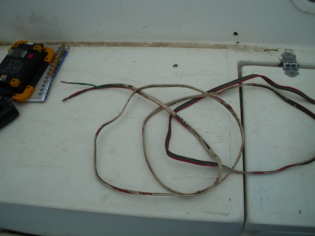

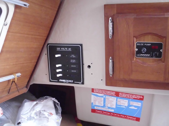

Here is a picture of some of the wiring I am replacing. This is piece was the run from the shore power plug to the original AC panel. It looks to be 12ga, but there is no markings on it that I could read. Also attached is a picture of the new panel in place. I will be filling the holes in the bulkhead with some colored epoxy in the near future.
24,873
Positive work Mitch. Looking at your wire, I have replaced some wires like that.

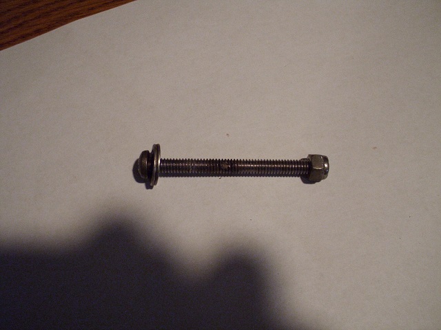

Here is an update on the wiring issues I am encountering with my 1982 N-28-2. I apologize in advance for the long post, but I think it is important.
Well, it was a very interesting day working on the N28-2 AC wiring, and I had posted earlier that I was re-wiring the AC circuits. I have installed a new wire run from the shore power plug to the new breaker panel. Last weekend, I got the wiring run from the panel to the first outlet which is a GFCI that is wired so that it protects all the other outlets downstream. Anyway, today I was continuing with the wiring runs and outlet replacement. I got the wires run from the GFCI to the starboard outlet. Now on this outlet I had to re-use the existing wire as it appeared it was glassed in during construction, and I was not able to get it out. So, no problem, its a good grade of wire so I just ran the end of it to the junction box and made the splices. Ran the next segment of wire across the V berth to the second junction box where the wire will run up between the liner and hull. Got all that in place, and the port junction box installed. I was pretty much done with the wiring for the day, so I separated the hot wire from the rest at the end of the run and temporarily installed a wire nut to make it safe. I still had a few things to do, so I plugged a work light into the starboard V berth outlet, and it did not work. Took the light to the GFCI, and plugged it in, and it worked fine. So I unplugged the shore power from the boat and started trouble shooting the wiring. result of the investigation showed 120v between the hot wire and ground, but 0v between the hot wire and common. After a bit more investigating, the old wire from the starboard junction box to the outlet that I had not been able to remove was bad. No continuity between the two ends of the common (white) wire. So I started trying to figure out how I could get the wire out as it was stuck solidly. As I was following the wire with my hand to where it get covered over by a piece of fiberglass, I felt something odd. Stuck my head down in the storage compartment to try and see what I was feeling. There was a 1/4-20 bolt sticking out of the fiberglass and it appears it was sticking right through the wire. Turns out this bolt is one of the three bolts that holds the hanging locker on the starboard side to the rear of the V berth liner. After a bit of studying, I was able to get the bolt out. And guess what, the wire could now be moved. I attached a new piece of wire to the old so it would feed in as the old was removed. Got the wire out, and it was indeed bad. Best I can tell, this outlet never worked from day one. When they drilled the hole from inside the locker, they drilled right through the wire, completely severing the white wire, severely damaging the ground wire, and damaging the insulation on the hot wire. It looks and is really bad! I have attached some pictures showing the wiring damage. IF you have a N28-2, you may want to check the location of the bolt and wiring located under the starboard V-berth where the locker meets the V berth. You have to stick your arm down in and feel up until you locate the wire, then follow it up to where it gets covered by a thin layer of fiberglass. If you feel a bolt sticking out of the fiberglass cover, check the location of the wire and the bolt. A mirror would help in making this inspection. There are three bolts that are drilled through the locker wall and protrude into the v-berth storage compartment. The upper most one is the one you need to check. Anyway, here are the pictures. They speak for themselves.
24,873
Mitch. Welcome to the fun of old boat maintenance. If it is not the original boat manufacturer, or the marina yard install, or the previous owners “this would be cool project”, it is self inflicted current owner stuff. One good idea sometimes creates unexpected consequences.

Jssailem, you are so correct. Unfortunately, this appears to be a factory issue. I, and previous owners are fortunate the wiring did not catch fire. If I was not so determined to ensure everything is installed and working correctly, I probably wold not have undertaken the rewire, and could have easily caught the boat on fire. As it is, the middle of the stainless bolt is black from heat, and there is a nice blob of copper welded to the bolt. So it got plenty hot! Anyway, only a few more junction boxes and outlet replacements to go,and I will be able to call this repair/upgrade complete. Then on to lowering the mast to service the masthead sheaves, light and vhf antenna. I'll be glad when the wiring is done. Hopefully then the various cuts and scratches on my hands will heal. Rough fiberglass edges are tough on the hands.
