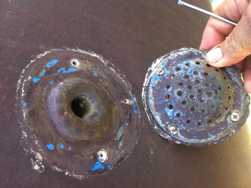

Slotted strainer
Yes, mine is held on with screws into the hull and a little caulking. I suggest that you replace the strainer with a slotted strainer/cover with the slots facing aft. It really stops a lot of the seaweed and eel grass from entering the engine intake and fouling your raw water strainer.
