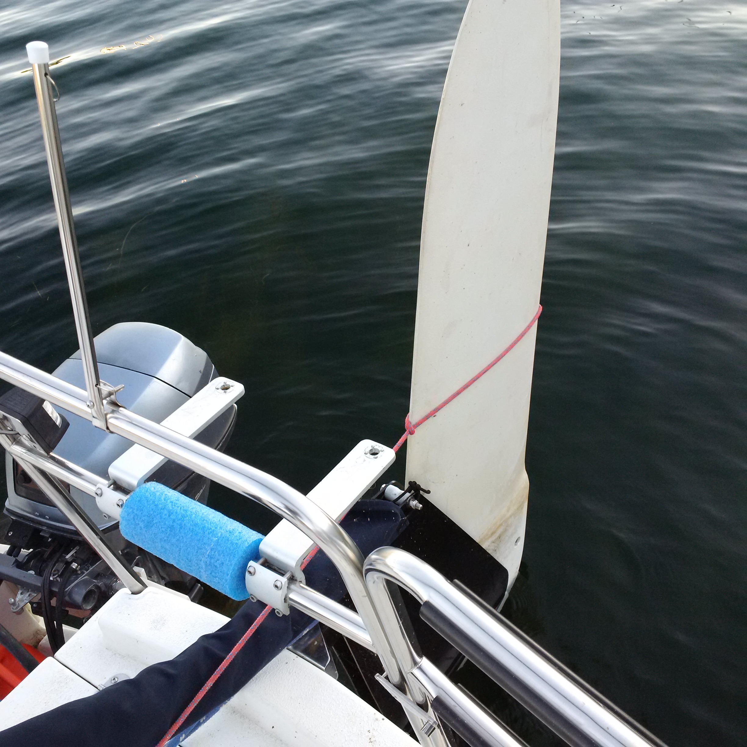

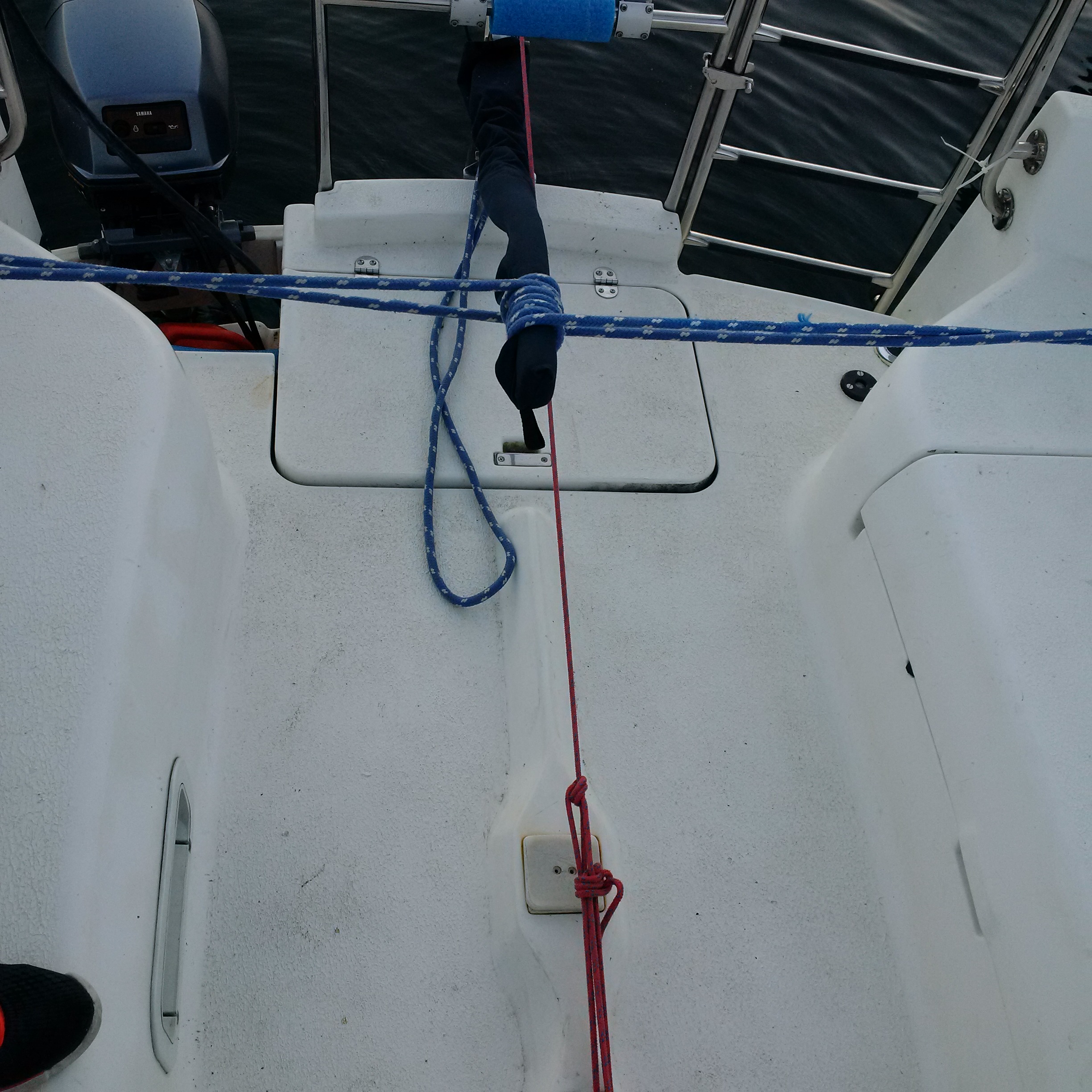

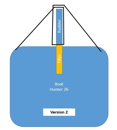

I keep my H26 at a marina that gets a lot of wind and can be a little ruff. To take the weight off the rudder and prevent it from banging around, I have been trying a few different thing. Version 1 (with the pictures) has the Rudder up and a line secure from it to the Main sheet cleat. The tiller is tied to both the stern port and starboard cleats. My latest idea version 2 (apologies about the graphic), has the rope wrapped around the tiller and then back to the stern cleats. I used this for the remainder of the season and it worked great. It removed the stress from the tiller and held during some crazy weather.
My questions is:
My questions is:
- By lifting the rudder, is that putting too much stress on the stainless steel rudder brackets?
- Every time I lift the rudder that high I have to stand on the ladder and get my feet wet. If I drilled a hole in the rudder and attached a rope to lift it out of the water, would hole and the lifting stress crack the rudder? The rope that's inside the rudder bracket only lift it to 90 degrees.
