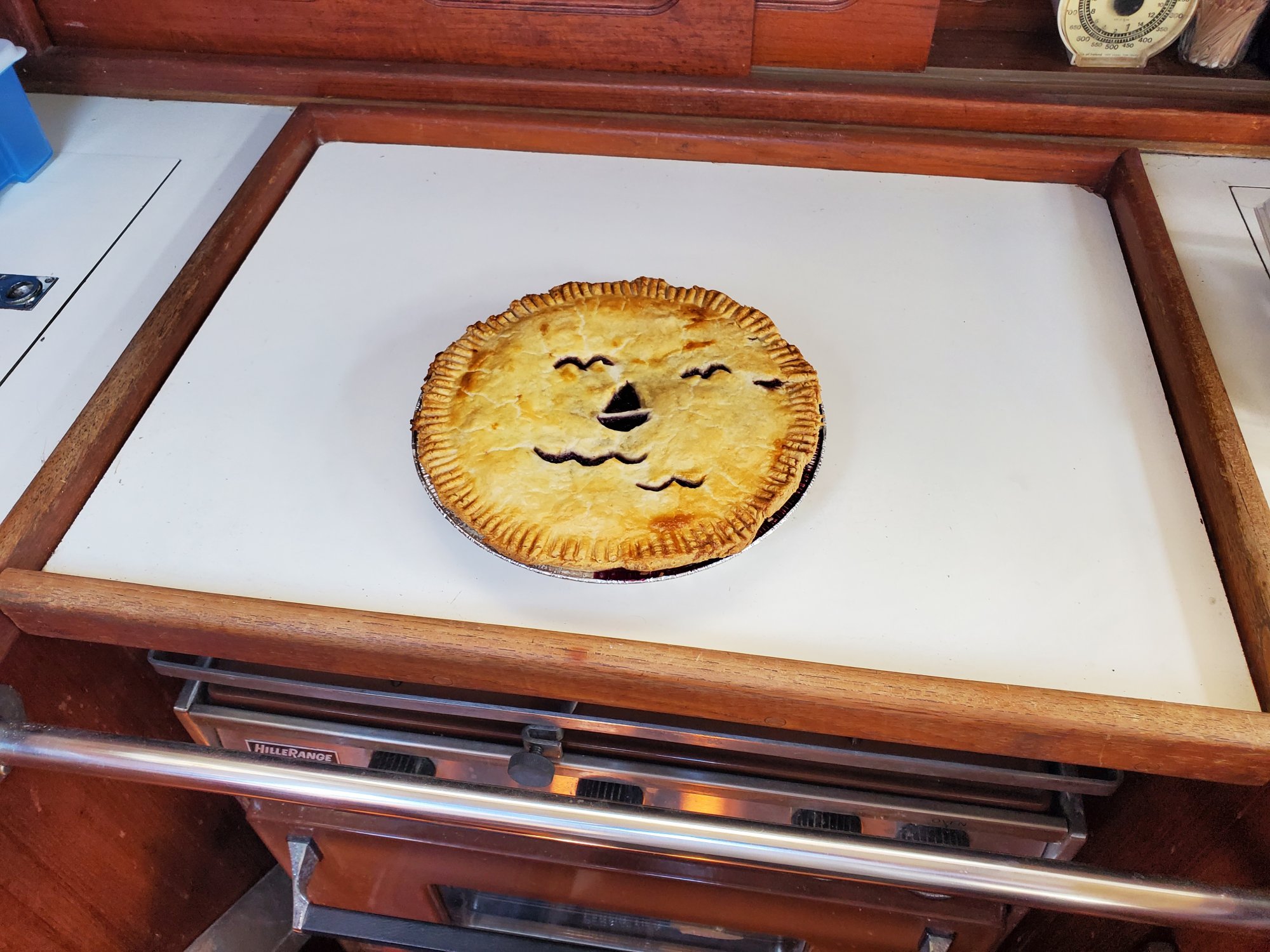

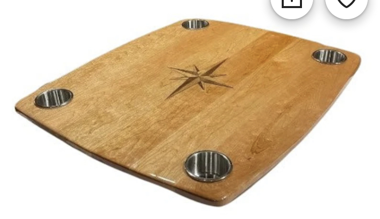

I improvised a server tray by removing handles, then used it to cover stove for more counter space...when the lightbulb went off. How about a custom, serving tray/mosaic compass rose or design counter top. Handles face down to lock on stove top, flip over for cutting board/serving tray? Thoughts?

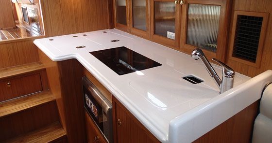

Excellent points. Trays with fiddles = good idea. I removed other handle & when using stove it fits over the sink. New boats I noticed have snug sink covers. This was the motivator last year I saw this setup @ the Newport boat show... actually my wife saw it and said "that would be nice." And so I set to work on my old boat to bring it up to date.

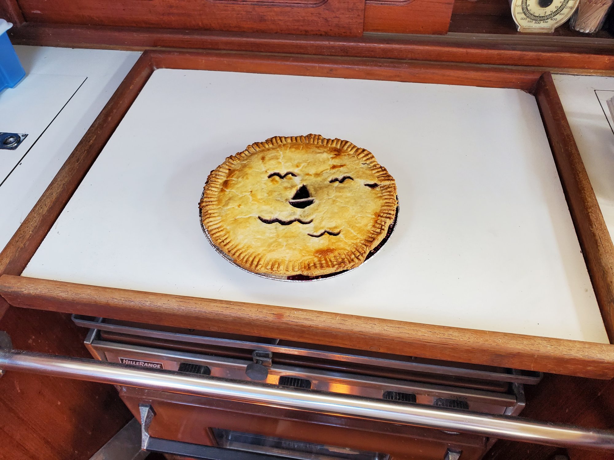

I don't have a picture of mine but it is a tray with fiddles and handles. I made it from left-over teak and holly flooring and some solid hardwood for the fiddles and handles. The bottom has a rim to secure it to the stove so it is never displaced when sailing.
We use it to load up snacks to bring up to the cockpit and it's generally a catch-all countertop that secures small items when sailing. It's never in the way for cooking because it will normally be in the cockpit then. It can be stored behind the stove, which is generally locked while sailing. We never use it as a cutting board since we don't want to mar the surface. We just have a varnish finish, nothing hard. We use the plastic sink cover as a cutting board.
We don't cook very much and never while sailing so the tray is never really displaced or in the way of anything. In short, I would leave the handles on unless you need absolutely flat counterspace. But preferences always vary!

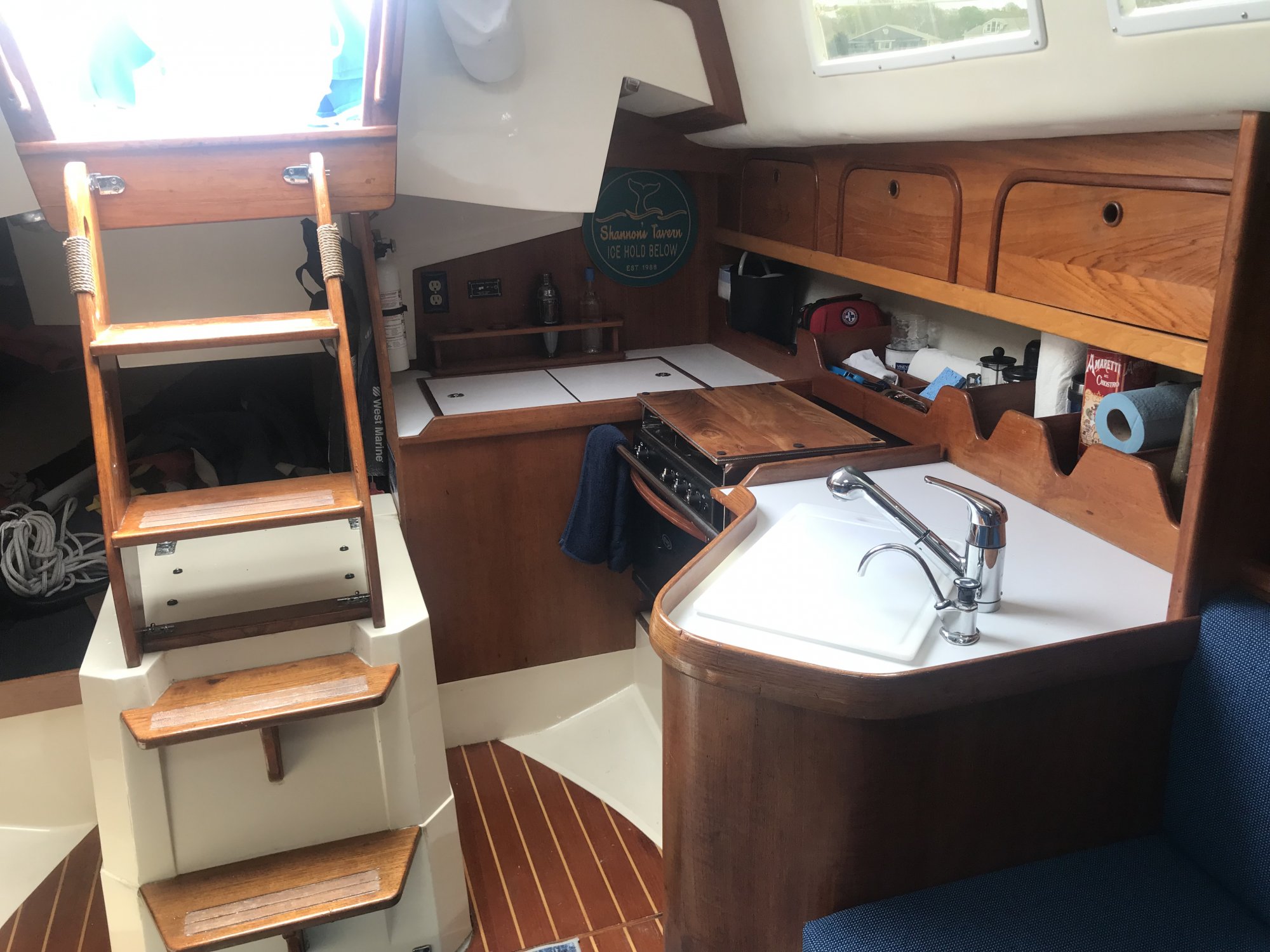

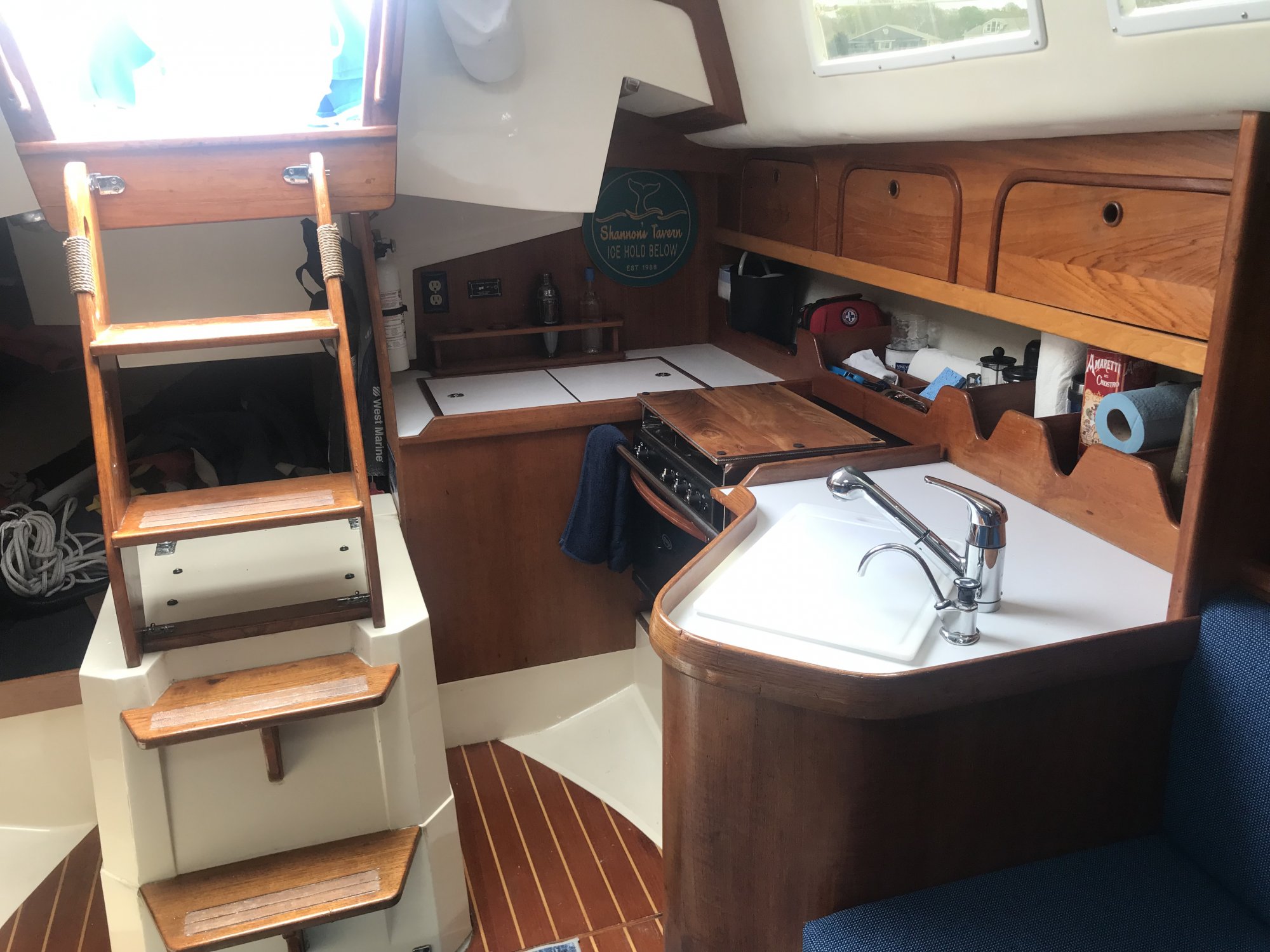

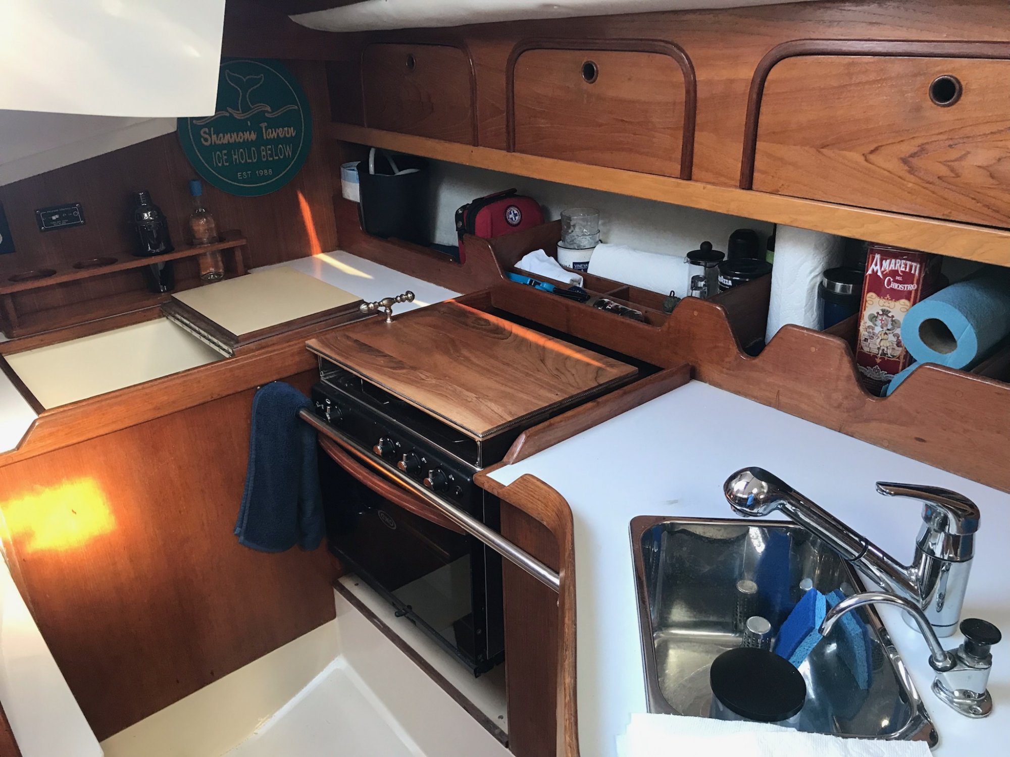

Thin water, you are making too much common sense, less is indeed more. Here is where I have left the project…. Basically, a cutting board on top of stove., stows behind stove when not in use. wife likes it. Not really necessary, because I have a small cutting board that fits over sink, stows in ice box, when not in use. Thanks everyone for input, boat goes in water this weekend & sail we will.
