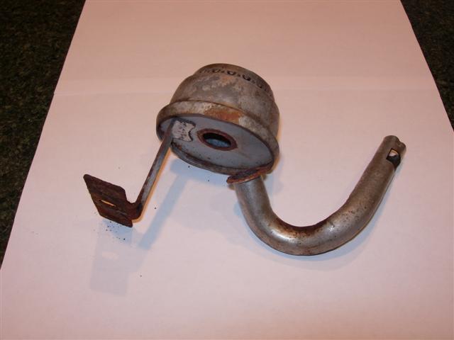

Hi, I'm a new owner of a 1988 Catalina 30 (first boat!). One of the things I need to fix before spring is a burner on the stove. The burner fractured at the base where the inlet was attached. I assume it is the original propane stove, but I cannot find any labels that indicate the manufacturer or model of the stove. Here's a picture of the stove and the broken burner. Does anyone know the manufacturer and where I can get replacement parts? Thanks much for your help.

It is most likely a SEAWARD, look 'em up on the internet. Then call them. Or open the top of the stove, remove the burner holders and lift it up.

I am still researching my stove issue and someone from Seaward told me it is a Model 2122 (based on the picture). They sent me to Sure Marine for the burner, but of course they don't make them anymore! He has a newer version that might fit, so I still would welcome any info you have about the stove. Mine is 4 hours away and covered with shrink wrap, so I can't look at mine until spring.

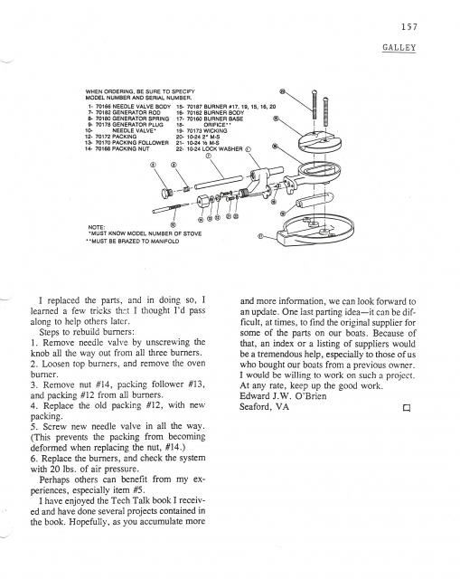

Regarding the stove parts, attached are two pages from a great notebook left on our boat when we purchased it 4 years ago. It is listed as
Tech Talk by Richard Dickens
A collection of Owner Modifications , Experiences, Revisions, Maintenance and Care... for Catalina 30 and other similar yachts
It was first written in 1988 but has been revised multiple times through1994. What is really cool about it is I think someone actually typed this thing up, all 400+ pages. It is packed with so much information that is all owner based.
We spent the first 6 months on our boat enjoying every page of this and the Main Sheets on board.
Anyway, these are the two pages to do with what might be of help fixing the Hillrange stove, but it sounds like you may have already found our more than I am giving you here.

Thanks for the brochure images. However, your stove burner looks different than mine. I think you have an alcohol stove and mine is propane. I talked to the stove expert at Sure Marine today, but he says that there is no place to get a replacement burner for my stove. Dang! He suggested that I may be able to have the parts welded together so I guess that is my only option for now.

I have good news to report on the stove! I was able to get exactly the burners I needed through Torresen Marine in Michigan. I just sent them a picture of the stove and burners and they were able to order the parts from Seaward. They arrived yesterday and they're perfect. Yeah!
