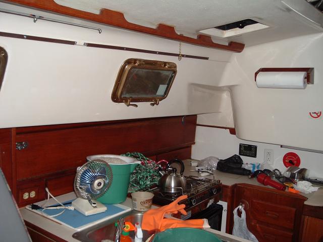

My stove is not quite as old as Jim's. But the original pressurized oven/range is in my garage if anyone wants it. In it's place is a dorm fridge. On top of that is a two-burner non-pressurized alcohol stove. In March we finished the Erie to Tampa trip. All I can tell you is that the three of us ate very well, cooked a lot of great meals. So I still have not seen the value of changing to propane. Maybe if I had to have an oven.

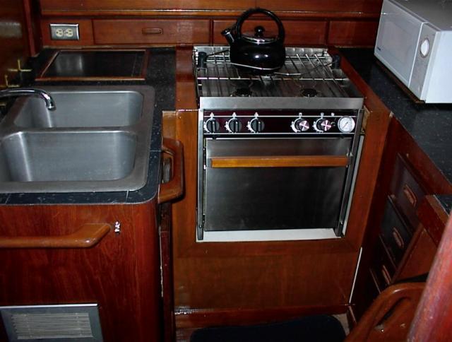

P.S. Picture 1 is Ron Pearson's conversion to propane. Picture 2(winter layup) is mine. You can see how I solved the portlight issue. You can barely make out the stove and dorm fridge.

I just saw the pictures of Ron refit and the steel stove. That's exactly what I'm looking for. How do I get a hold of Ron to find out what he did? thanks tj
Jun 2, 2004
5,802
TJ, Ron sold that boat and went RV'ing. But I don't think he would mind if I gave you his e-mail. Write me from here(click on my name) and I will send it on. I thought he had posted the whole install but I can't find it. The picture is here in "Hunter Owner Modifications" but not much text. We do know that it is a Force 10 3-burner(http://www.go2marine.com/category.do?no=12194&mfrno=138). I posted this link because I don't think our SBO site sells them.
