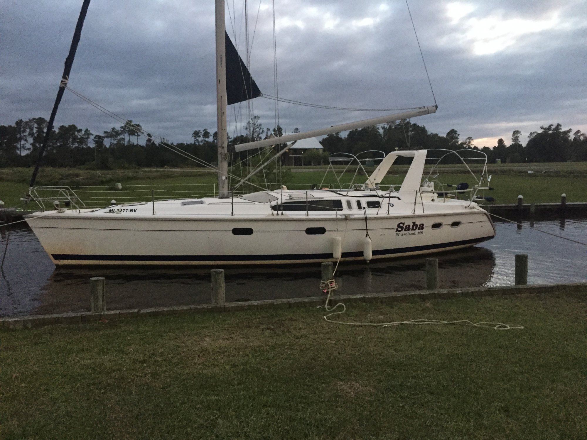

Hurricane Nate Boat preparations.
This is how we left the boat about 5 hours before Nate hit.
More on what we did and why it was in a Canal, if anyone is interested.

I'm interested Jim.
Hurricane preparation is complicated and can involve factors that are outside our control. I don't mean the storm, I mean other boats, objects and circumstances that are unpredictable.
The North pass of Clearwater Beach is called Hurricane Pass because a hurricane made the pass. Before that, Clearwater Beach was a bigger island. Imagine relying upon that piece of land to help protect your boat, but the hurricane removes it.
Surge can be devastating to the geography of a sandy coast.

1) Storm Surge or slow rising water that is caused by Winds.
That Before picture shows the already rise in level by about 1 foot, but trees in back ground & water surface show no wind.
The Official prediction was up to 10 feet at the Canal.
Or..
About the bottom of the boom gooseneck.
2) The Bow is facing the oncoming wind and waves [not from Nate , but the fact boat is in a canal or land somewhat protected
[Nate eye to pass near or West of boat] Picture was looking East.
3) Lines that center up the boat in the canal:
a) 3/4" diameter on the Midship cleats [2], but you can see the Port side connection to the Bollard.
Note: Pink flagging tape [ reference level marker]
b) Surprise! The bow and stern cleats don't ;)
___________
Boring yet?
If not, I will continue on next post on line lengths, knots tied, and restraints, and why I was confident.
Jim...
PS: Note zero line chafe protectors.o_O

Yes Jim, why so confident? You're in the Gulf, why not anchor out away from shore and obstructions, flying trees or cows or other boats less secure? The bottom is shallow enough far enough out that a Bahamian double anchor system would be very secure. Of course, you stay on the boat or worry about how to secure the tender that brought you back to shore.
