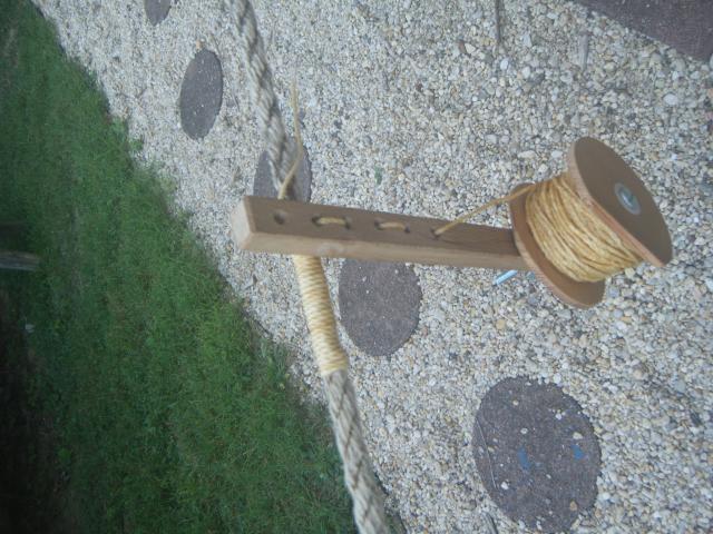

Jun 15, 2004
14,693
Very tightly applied service is very chafe resistant. Make one of these load it with waxed marline or waxed seine twine and applying service is easy.
