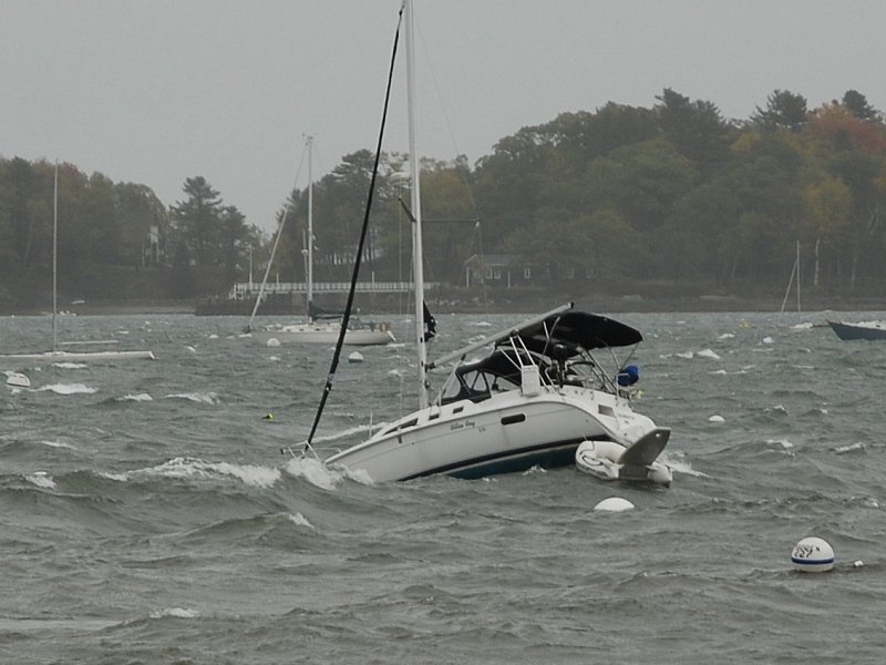

Actually I prefer the chockless cleat right near the toe rail method and have actually converted two of my boats to that. You obviously need to be careful in the placement of the cleats but with no real line to stretch and rebound over a chock less heat build up and less wear. I have been monitoring chock to cleat and chock-less, like Catalina uses, and by far find less chafe and pendant wear in chock less tow rail mounted cleats. I would convert my own boat to that in a heart beat but I have a custom made ss stem head and complete aluminum toe rail making the conversion a huge project. I have spent a considerable amount of time softening the edges on my SS stem head though. The Hunter shown below was yawing side to side wildly as well as pitching and she had no wear on the pendants and had toe rail mounted cleats.I've seen pendants with clear hose, shrink tape, and nothing at all. Since this Catalina has cleats without chocks, what would be the better solution? We've been in a slip for 6 seasons but will be traveling when we put the boat in next year.
