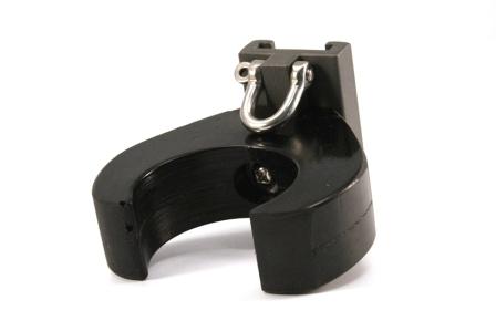

Actually, the system is not uncommon. Many chandleries sell a hard rubber clamp called a mast mount pole chock.
You might google "spinnaker pole chock" or "spinnaker pole mast mount" for some more ideas. Here's a list of parts that might inspire you.... http://www.fisheriessupply.com/sail...les/spinnaker-pole-mast-rings-cars-and-chocks
Just about any boat larger than 25 ft should have a track on the mast for adjusting the pole height.... You can find the standard 1" track and surplus sliding mast ring cars at Minney's Yacht Surplus in Costa Mesa/Newport Beach.
Here's a link to a previous discussion on this subject a few years back: http://forums.sbo.sailboatowners.com/showthread.php?t=107182
