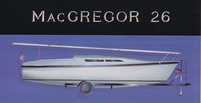

But on my old Macgregor 26c that's how I usually kept the mast. It's a 100 pound pole which laid snug on deck with a few sweatshirts to avoid scratches. I can't imagine it ever being a problem, from wind or wave issues. And via ropes I would lower it by myself...

fear by people of having mast down… I can't imagine it ever being a problem, from wind or wave issues.
Your Macgregor 26 was just under 26ft overall length. The mast (deck stepped) is listed at 28ft long. The mast laying down on deck, there could be a foot over hang on the bow and stern.
Even on the trailer you could feel assured that the mast would not trike the pickup or need a flag hanging off the transom because the mast did not have an extended overhang ready to strike a vehicle tailgating
Compare that to the Hunter 260 with an overall length of 26ft and a mast that ranges from 30 to 36ft depending on the model/year/mast length. That could be 4 to 10 ft of mast hanging over the end of the boat like a knight’s jousting pole waiting to strike an unsuspecting victim.
Maybe an owner need not be fearful but there is room for concern. :waycool:
