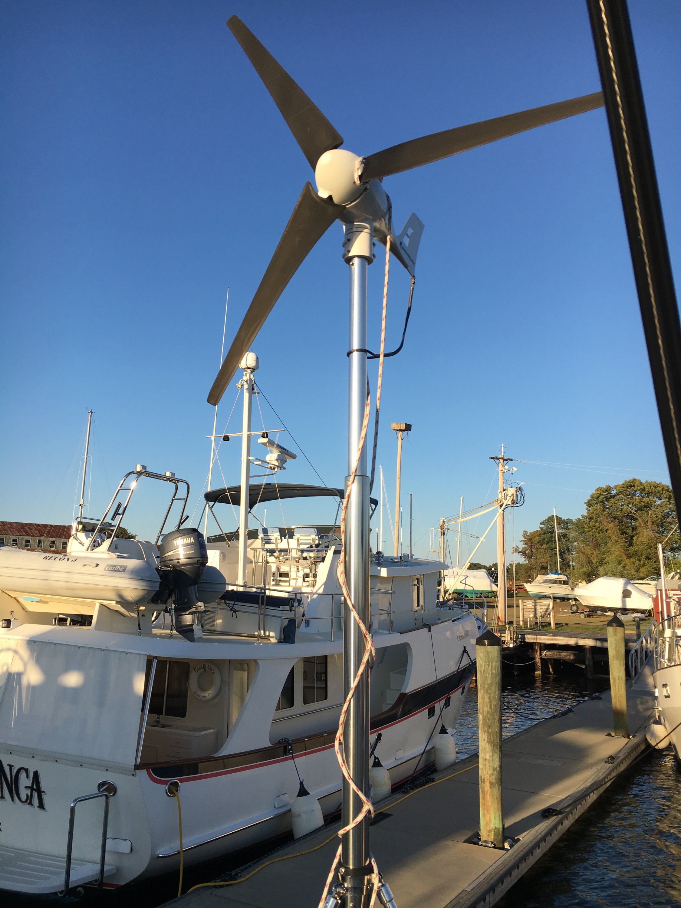

Hi all,
While cruising we have entertained ourselves with various games like "Swat the fly" and "Dodge the racers". Recently we came up with a new one called "Stop the blade". Quite sporting actually. What you need is a wind generator, some line, a boat hook, and winds that gust 10-20 kts. We quickly found that wrapping the blade doesn't help as it soonly turns to the bottom and the line falls off. I was able to turn away from the wind direction enough to stop the blade, but with a new plan in mind I'm curious what other thoughts are out there.

My loop works pretty good
So, you're just looping the tail to turn it out of the wind, not actually capturing the blades? Or is a blade wrapped and I just don't see it?

In the center of the line I made a knot with about a 5" loop. I then pulled the loop over a blade and have the knot on top of the wind-gen body. Lacing the two ends around the mast keeps the loop from falling off. If you look close you may see the loop around one blade.
