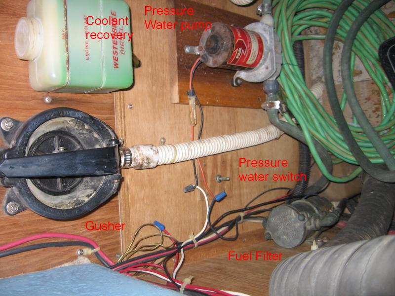

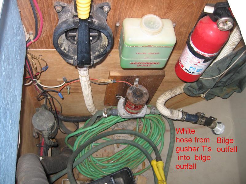

OK - here's 2 pictures. horizontal one shows fire extinguisher, coolant recovery, fuel filter.
Also shows bilge outfall, pressure pump, toggle switch to turn on pump, gusher.
Gusher & bilge have white pipes. Fresh water has gray. One end I assume goes to tank (left side), other goes to hose nozzle. Thought there was a 3rd gray hose, but is not apparent in these pics. Maybe it's just a fresh water cockpit wash down (shower or something)?
Guess I'll need to fill water tank to really find out.
