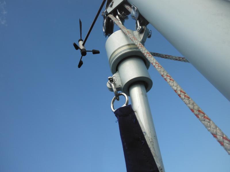

There seemed to be some confusion when I referred to the top of the furler. This is the piece.
Nov 18, 2010
2,441
Catalina 310 Hingham, MA
Yup, that is the part I was referring to. There are ball bearings in there and they can get stiff from dirt and salt water. Every fall when I take the sail off I flush that out with fresh water followed by spraying it down with McLube Sailkote dry lubricant (I am sure any dry lubricant would work, I just like this product). Spin it around a bunch of time and make sure it is turning freely. Then I tie it down to the furling drum so that it's secured for the winter. In the spring I will spray the bearings down again and make sure it can spin before putting on the sail. I will also spray the McLube in the foil to help the sail go up easier.
