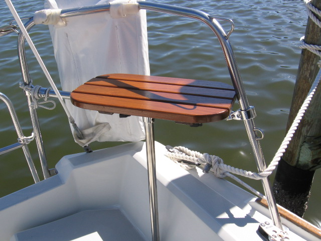

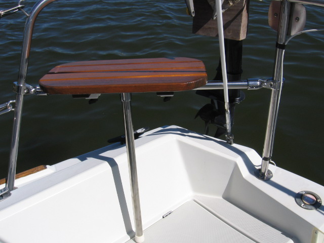

Hello Members,

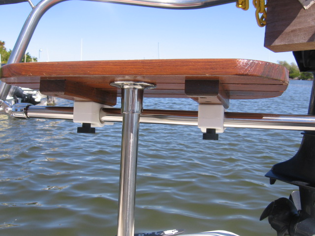

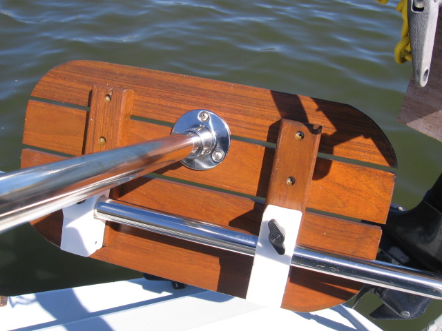

We took Breezin' Up, our 272LE out for the first sail today from Bokeelia. We had an exciting time and then put a reef in the main to make it a bit less exciting.
We had installed the sternrail seats before leaving the dock. Pictures are included. The wood is from a salvage shop. They were cut from one of those slotted covers that fit in the sole of a powerboat to cover the storage space for skis and such things. I copied the curve of each end along the centerline of the wood and then used a router to ease off the edges. Two coats of Cetol were applied.
The fittings were from ebay and the 1 inch ss tubing was from the same salvage shop as the wood. I need to adjust the length of the legs a bit, but we are generally pleased with the installation. The legs can be removed for storage in the fuel locker and then the seats can be flipped back behind the split backstays if the seats are not in use.

Nice job, that's a very clever way to install perch seats with only a single rail on the pulpit.

Stu, thanks for the comment. The fittings were the most expensive part of the project.

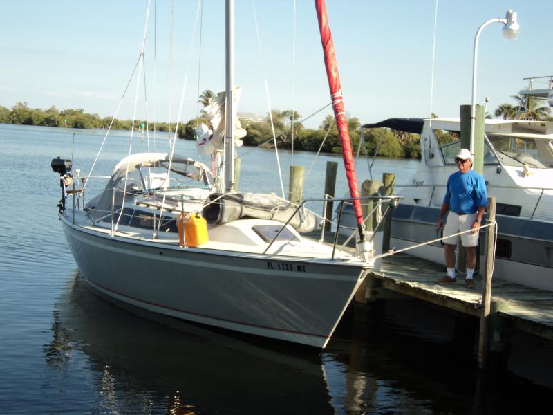

Also, the routing of the stern line in the first picture is only used when we are loading the boat or working there. I'll need to come up with a better way to pull the boat close to the dock. We are also experimenting with ways to leave the spring lines and other dock lines at a spot on the piling where they can be easily grabbed when docking. We are on one side of a small dock and close to shore, so spring lines are essential.

Bicycle hooks on the pilings.

31 Seahorse,
Great work on the stern rail seats.

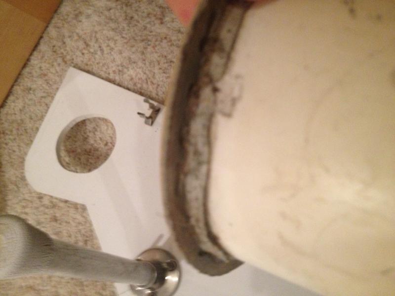

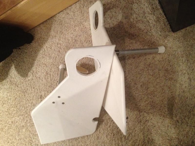

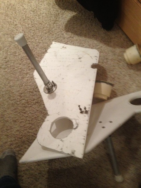

I enjoyed reading your profile. Middle school teacher , so trying to douse a flogging out of control sail is nothing to you. I was the jerk in the back of the room with the hormones raging. I may not have been in your class but I bet you had your fill of my type. Anyway... I have a few questions.
My boat has a set of seats but they have a few issues.
First off I'll get the proper length bolts for the leg flange fitting and replace the aluminum tubing with Stainless.
I'm stumped on the the clips holding the seat to the horizontal rail. You see mine are cheap and flimsy. Something designed to hold a mop or broom. I see you found yours on E-bay. What are they called? How do I find them?
The Beckson cupholders were (poorly) caulked in place. Anyone care to offer a suggestion as to the type of caulk that will actually work on Starboard?
Your wooden seats look better than the starboard. I may have a new project.

Hello Panta Rei,
Thanks for the reply. RE: Middle School....What a great age! I always said I enjoyed my job so much because I had an eighth grade mentality.
RE: starboard product. I think I read that very few (if any) glues or caulks really adhere well to starboard. I always connected that material using screws. I had made a set of seats for the Oday 34 we owned, but I had used starboard that was too thin and the seats flexed. Not a great feeling when we were heeling.
The white clamps are called rail clamps. They come with inserts that allow you to clamp things securely to several sizes of tubing. 7/8 to 1 1/4 I think. I left the inserts out because I wanted the seats to be easily movable not "clamped". They were pretty cheap...under $10 a pair if I remember correctly.

31SeaHorse - great looking seats! But I have always wondered whether they are more 'in the way' than they are functional. I like to sit at aft end of cockpit, facing bow with legs on seat. Seems the sternrail seats would 'get in the way' of my head. Do you actually use them for seats? What year is your 272LE? I have an '87 272 and have a single backstay...

Hello Charles,
As a matter of fact........We do use the seats as a good vantage point to see over the dodger rather than through it. Sometimes I like to sit on the leeward side for induced heel in light winds. Sitting on the windward side can sometimes be a challenge when heeled. Best seats on the boat for motoring.

Our boat is a 1988 with split backstays that I think you noticed in the pictures. We are thinking of adding a helm seat of a smaller size than the sternrail seats. I cannot see out very well if i sit on the transom, so I thought a seat above the storage area might help. I'll experiment with that using left over parts from the first seat project.

31 Seahorse,
Thanks for sending in this message and pictures. I had asked about installing perch seat on a single rail, stern rails last month. Your design was pretty much what I thought I'd have to do, but was concern about the clamps on the stern rail, not the seat. My concerns was that they might slip down the rails once weight was applied. Is there any "positive" lock on the clamps, such as a "set screw" to lock the clamp to the rail?

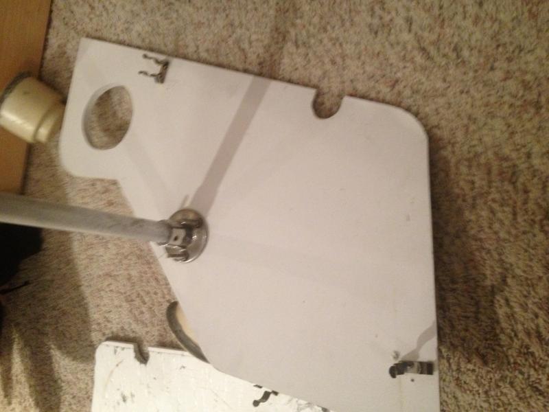

31 Seahorse,
I would fill the cup holder holes with cup holders.
http://www.boatoutfitters.com/4.3-black-plastic-cup-holder?gclid=CODQgN3hzLUCFW3ZQgoddW8A8A
When I made mine I didn't want to leave them in the weather so they snap on with fishing pole clamps. The seats are made of laminated aluminum honeycomb panels, edged with split pvc tubing. Flanges came from Minney's. Best part is that they float, oh yeah and they cost less than $25.

Hello dennisv,
The clamps on the sternrail rely on the clamping action of the hinged clamp to hold the new rail in place. With the leg under the seat not all the weight is borne by the horizontal tail you would add. I considered drilling the clamp to insert a screw or a bold, but I fif not do that yet. Tested by several of my friends who would never be accused of being small! ;)
Aug 2, 2005
1,155
Hello caguy,
