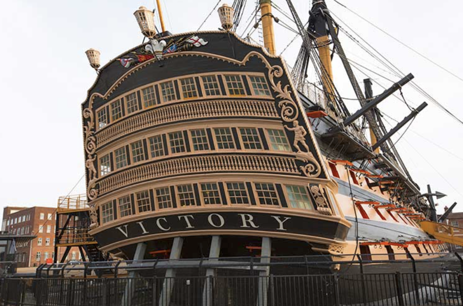

Good morning everyone! I know I haven't posted in a few weeks because I've been on winter break and on the water and with the girlfriend for most of my time :) so now I'm back! My remark for today is simply to acknowledge the beauty ot stern windows; although they look cheesy on smaller boats, I am personally fond of them on larger multi-masted vessels like schooners, ketches and yawls.
24,519
They give the Skippers cabin a sense of the great past "Sailing, sailing over the bounding main. Where many a stormy wind shall blow 'Ere Jack comes home again."

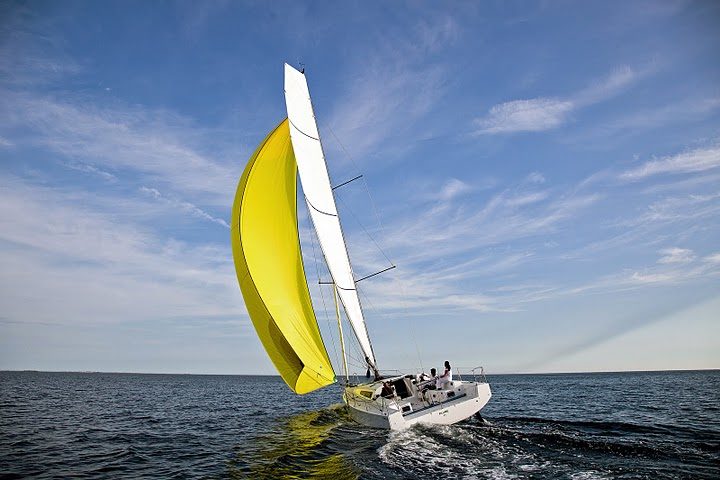

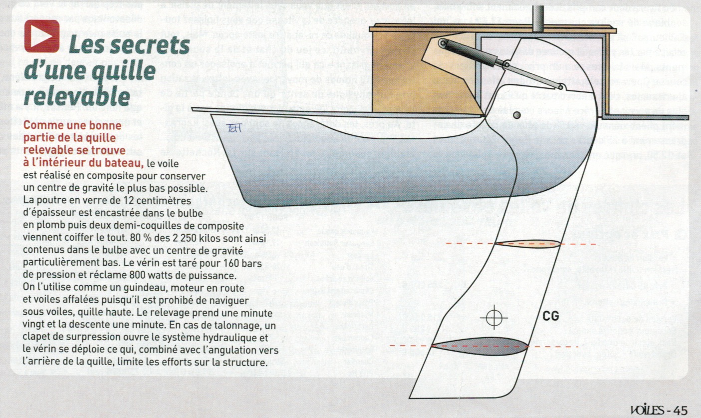

Do you think there is anything that ties the performance and capability of that Pogo lifting keel to one used on a Mac25?
Finot designed boats (Pogo, First, etc) uses a deep, high aspect foil that is controlled by a hydraulic ram. The foil is SS and fiberglass, with a lead foot for very low CG. It is also fused so in a hard grounding, it releases to avoid damage. If you run up on sand, you simply raise the keel and sail away. The ram hold it in place all other times. It allows a very deep keel for excellent pointing, with the ability to retract for motoring into shoal areas. In addition, the keel box creates an immensely strong 3-dimensional structure to hold the keel to the boat. The whole setup add cost and complexity, but is very reliable and very much gives the best of both world.
