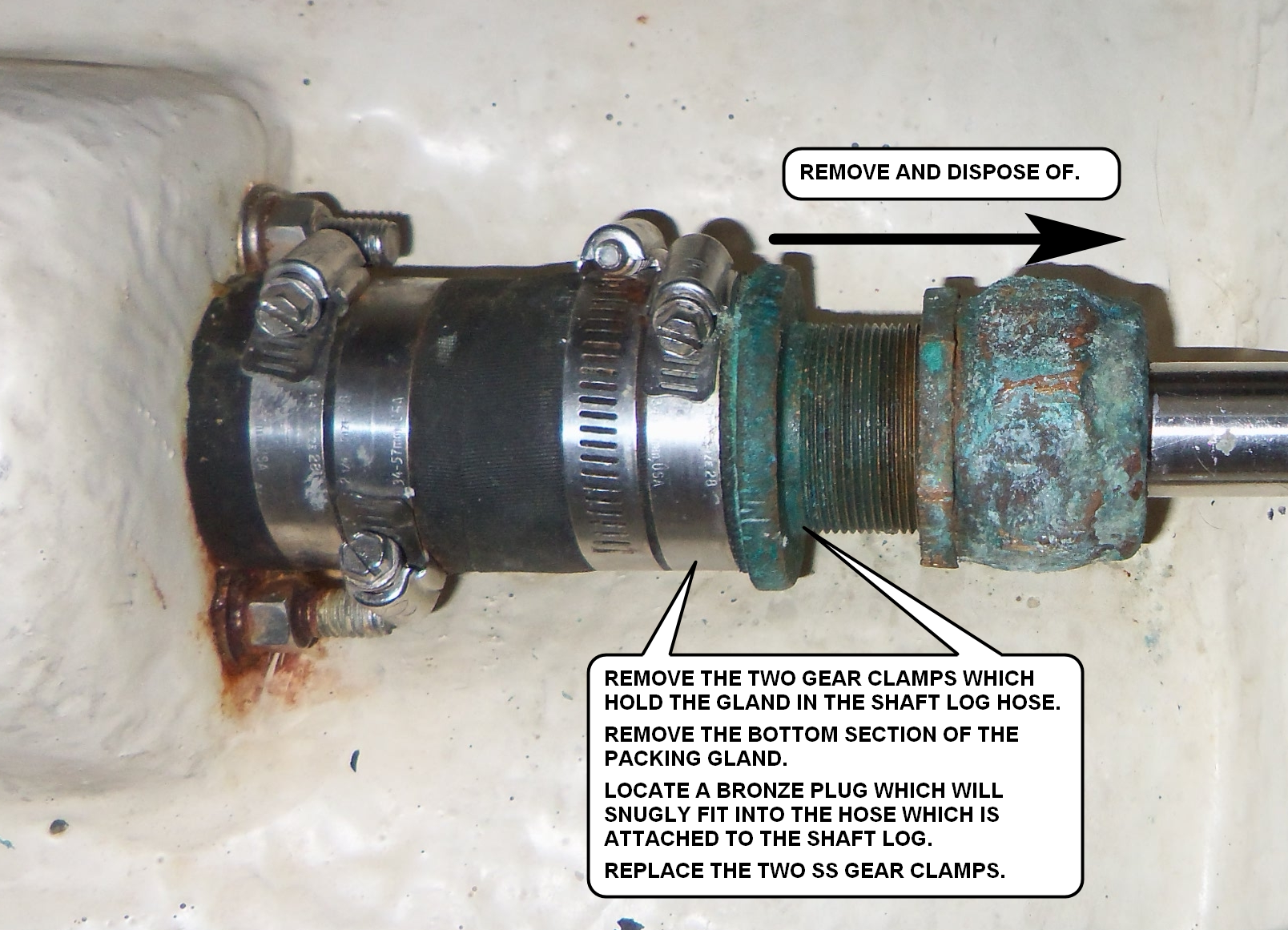

Consider disposing of the gland and replacing it with a bronze plug in the hose.
Be sure the hose is in reasonable condition before doing this.
