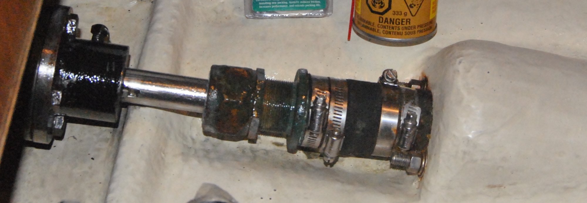

This picture of my old bronze stern shows that the combination of zinc and copper was not quite right. The corrosion occurred under the stern tube hose. I noticed a slow leak, so after a haul out, I pulled the hose back and saw a small amount of corrosion on the bronze. I tapped it lightly with a hammer and chunks of it fell away!

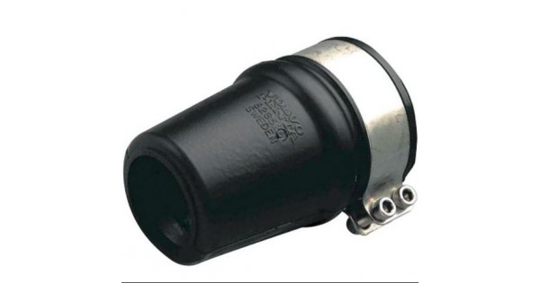

Most Beneteaus do not use the old packing style glands . How old is your boat? Going back to the mid 1980's Beneteau has used Volvo dripless on tubes which use a wide special clamp that comes with it .
with regards to it coming off the clamps must have not been tight or the gland to too tight and drive shaft force worked it off. Remember they are to drip a drop of water very minute or so. The volvo dripless is dripless no water and cannot be driven off by driveshaft . My bilge has dust in it for the last 3 years after replacement, they last about 7 to 10 years and are about 120.00

Mine is just like that. Shows the importance of checking the clamps periodically.

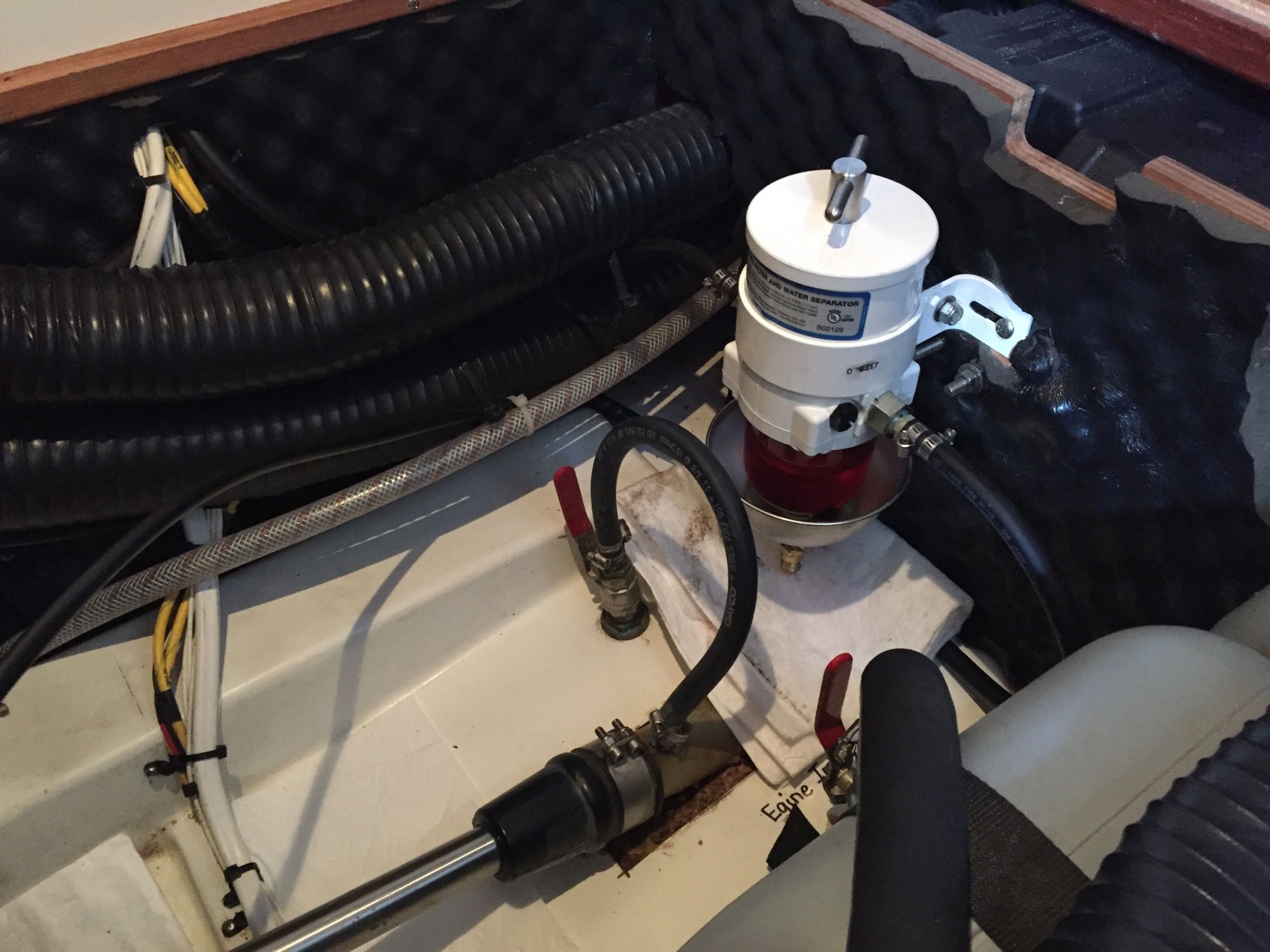

A picture always helps let people know what you are speaking about as there are many different set-ups.
I assume you mean the cooling hose as seen in picture. Isn't there a sea-cock to close off the water feed to the stern tube. Make sure the nipple on the stern tube is secure... they have a history of breaking. Regarding what can you do to prevent this..... at the beginning of every season I tighten every clamp on my boat...... and always during the season I do a visual to make sure all is good. All hoses that go to thu hull fittings are the same... two clamps. Vibrations can loosen them.
Good Luck... I'm sure you will be fine.
Greg
That looks like a dripless system. the hose I'm talking about is the one that goes over the prop shaft and connects the stern tube to the stuffing box.
I will be ckecking the clamps often. When the incident happened, the clamps were loose, so I wonder whether the source of the problem is engine misalignment or some other issue that generates too much vibration. I may end up calling a mechanic for good measure.

So it sounds like you have the traditional style stuffing box.
Most modern beneteaus Ive seen use the Volvo like in the picture. In any event, the hose on the traditional stuffing box goes through a lot of torque and vibration and must always be checked. Basic vibration will loosen clamps regardless of misalignment or not.

Exactly what I said in post #5 it must drip water or it's too tight, do yourself a favour and change it out to Volvo dripless ,I changed out 2 CS 36 boats from packing this past winter
