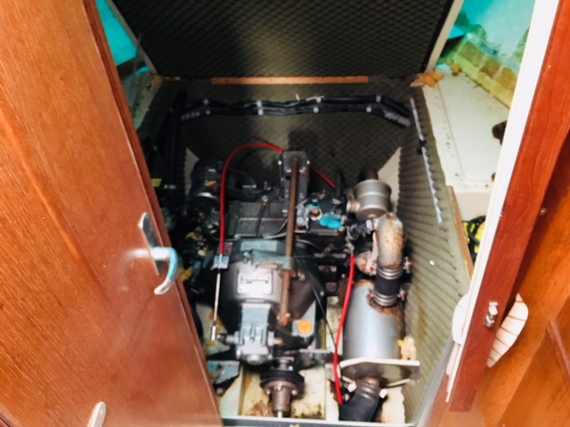

From photos I could find, I think you are right. You will need to disconnect the shaft and coupling from the transmission output flange, then separate the coupling off the shaft. Then you would be able to slide the stuffing box and hose off the shaft, and replace.
I am not familiar with the “thrust connection”, so maybe that is another alternative.

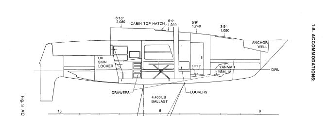

Apparently the Y30 has a 20 foot long prop shaft (hope you don’t need to replace that)... and has pillow blocks to support the shaft along the way...maybe those are the thrust connections you are referring to.
Either way, I am not sure then how you get the shaft log hose off... I assumed (incorrectly) that the shaft log was close to the engine....but apparently the shaft runs the length of the boat (hence the pillow blocks)...
I saw this photo on line but it doesn’t show where the shaft exits the boat...
