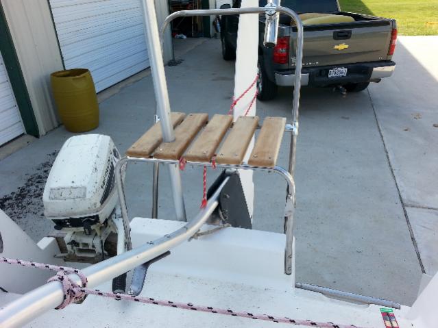

This goes over the rudder area and has teak wood for a seat and a place for the pit. Very easy to make and no welding just two 30 degree brackets and two 90 degree tees then drill the holes thru the teak and rails.

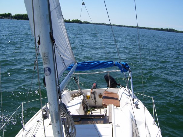

I didn't make it, but here's a convenient photo I have, under full sail with a 3-strand nylon helmsman. It was pretty home-made looking: mounted to blocks of plastic that were through-bolted (single bolt) on big blobs of sealant to sit flat, the feet attached with 4 small screws each, and and the rail sat in the feet/ help by setscrews
As a side note, I just set the mast on the railing to trailer the boat. However, I think I had a tendancy to pull it down a wee too tight with the ratchet straps..the slight bend in the middle is my addition.

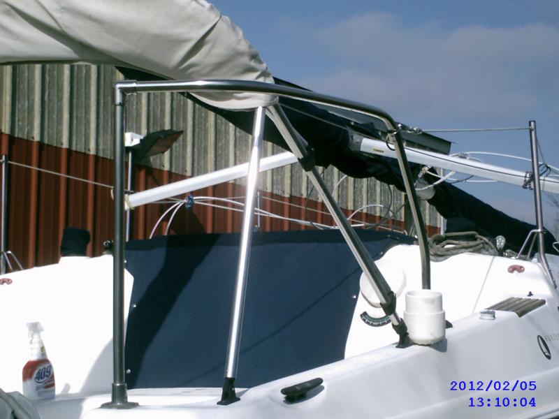

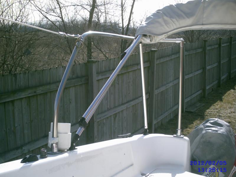

Made these for my 23.5.Got everything from Wholesale Marine.Your stern is probably diffrent,but can be done.1 trick,fill tubing with pool filter sand at tight bends,stops kinks.I bent a piece of 3/4 rigid first as a pattern
