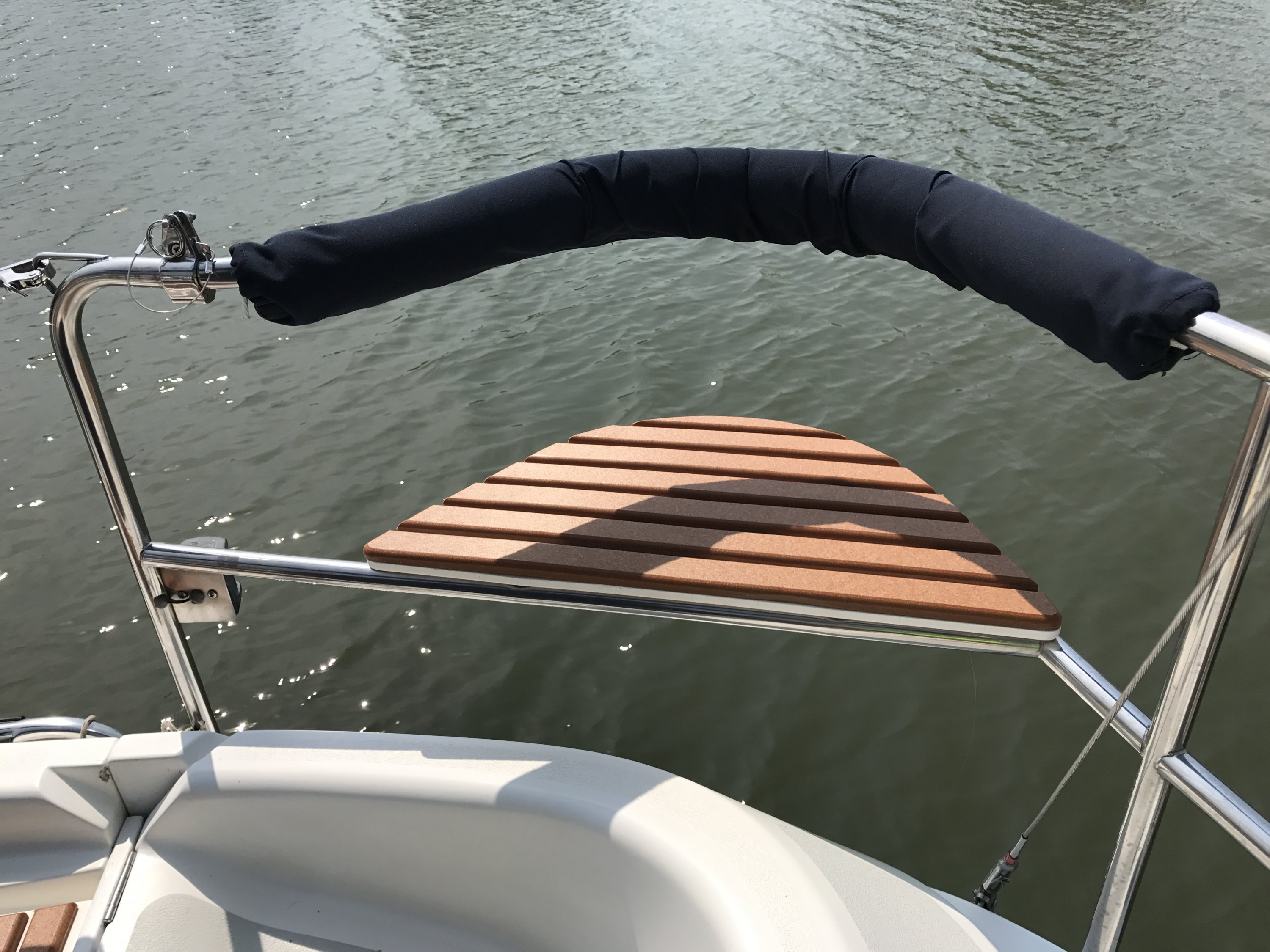

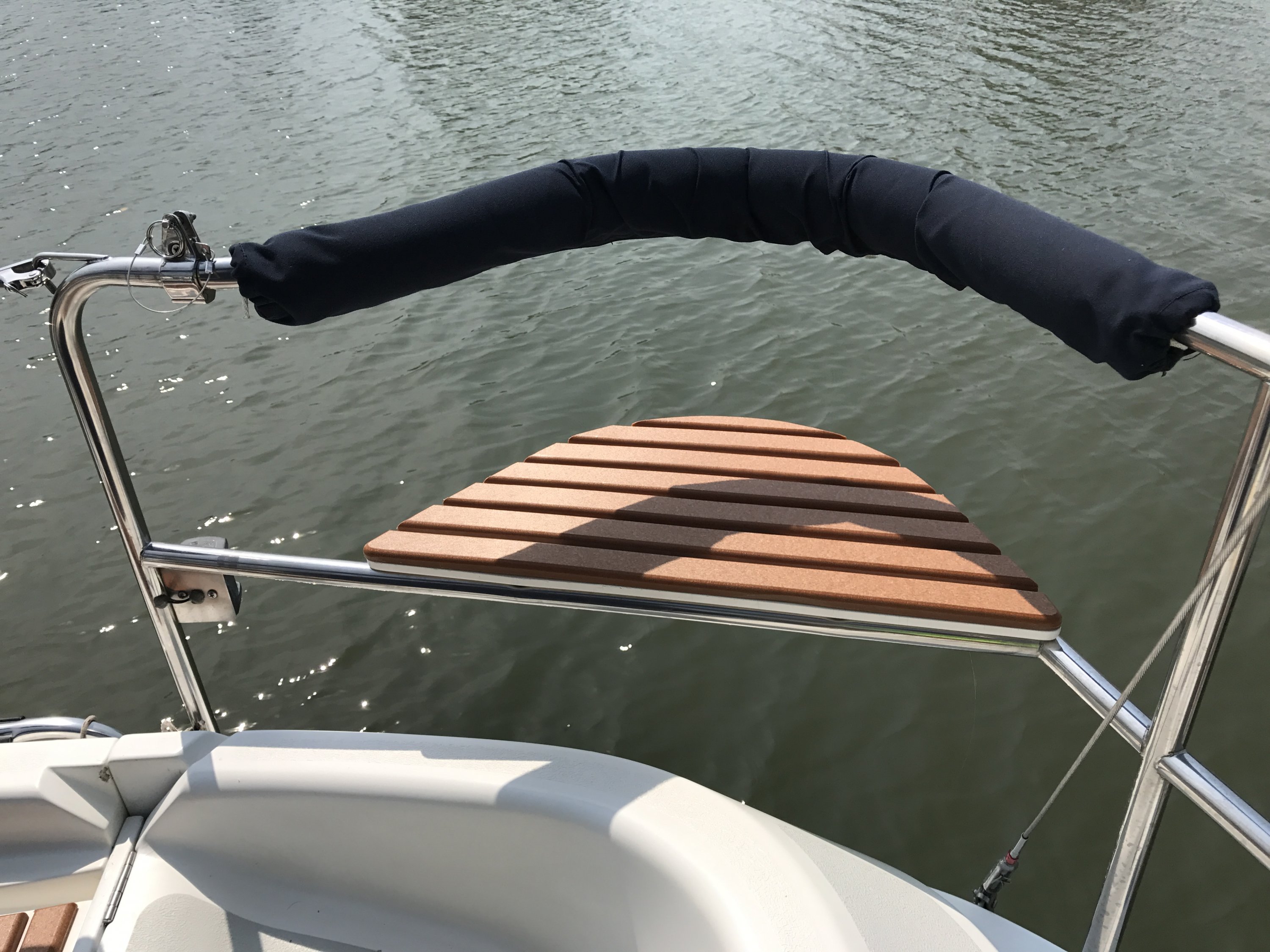

I replaced my topside teak with Plasteak. I like it so far.
That seat looks really nice. I have been thinking about doing the same thing for 10+ years. Where did you get the Plasteak and were you able to get it in the width you needed or did you need to cut it?
Feb 1, 2010
210
Hunter 33.5 El Dorado Lake, Kansas
You can go to there website www.plasteak.com. They can make it for you or you can order the lumber from them. You use wood tools to cut it to the shape you need. Then when done put a heat gun to it to make it all the same color.

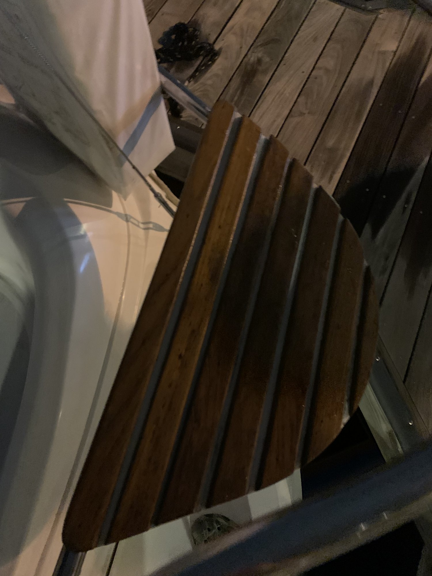

Greetings, I was just your photo and I saw this (see photo). Please tell me more about plasteak, how do you cut and stick on and how is it holding up?
