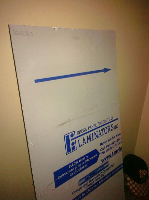

I found what I thinks is going to be perfect material for the seats. I found some 1/4'' laminated aluminum honey comb panels. They have a polyvinyl laminanant on them. The panel was $2/lb. This stuff would also make a great companion way hatch. I'm going to pick another piece up for a starboard bench seat slide out for sleeping.
