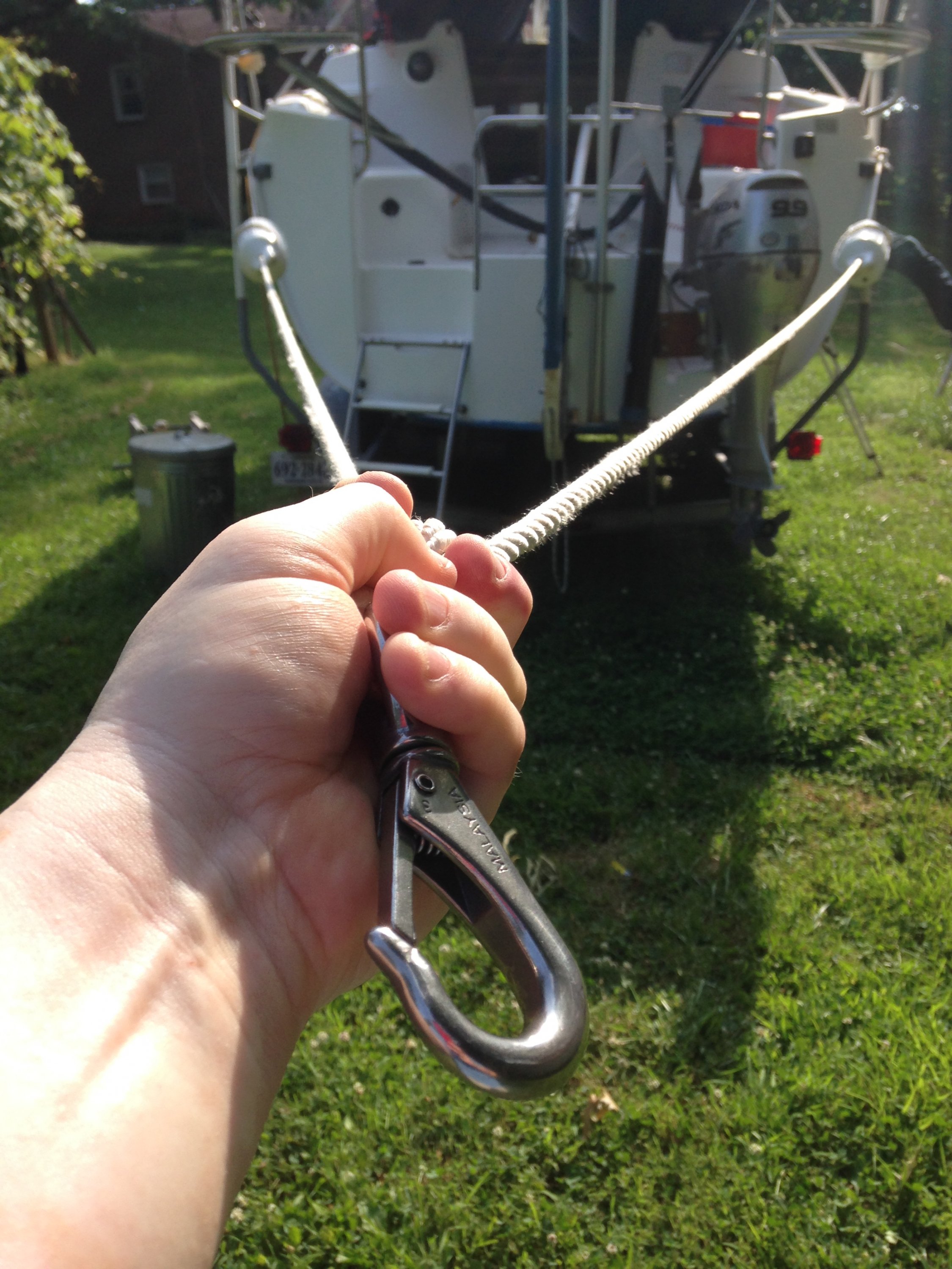

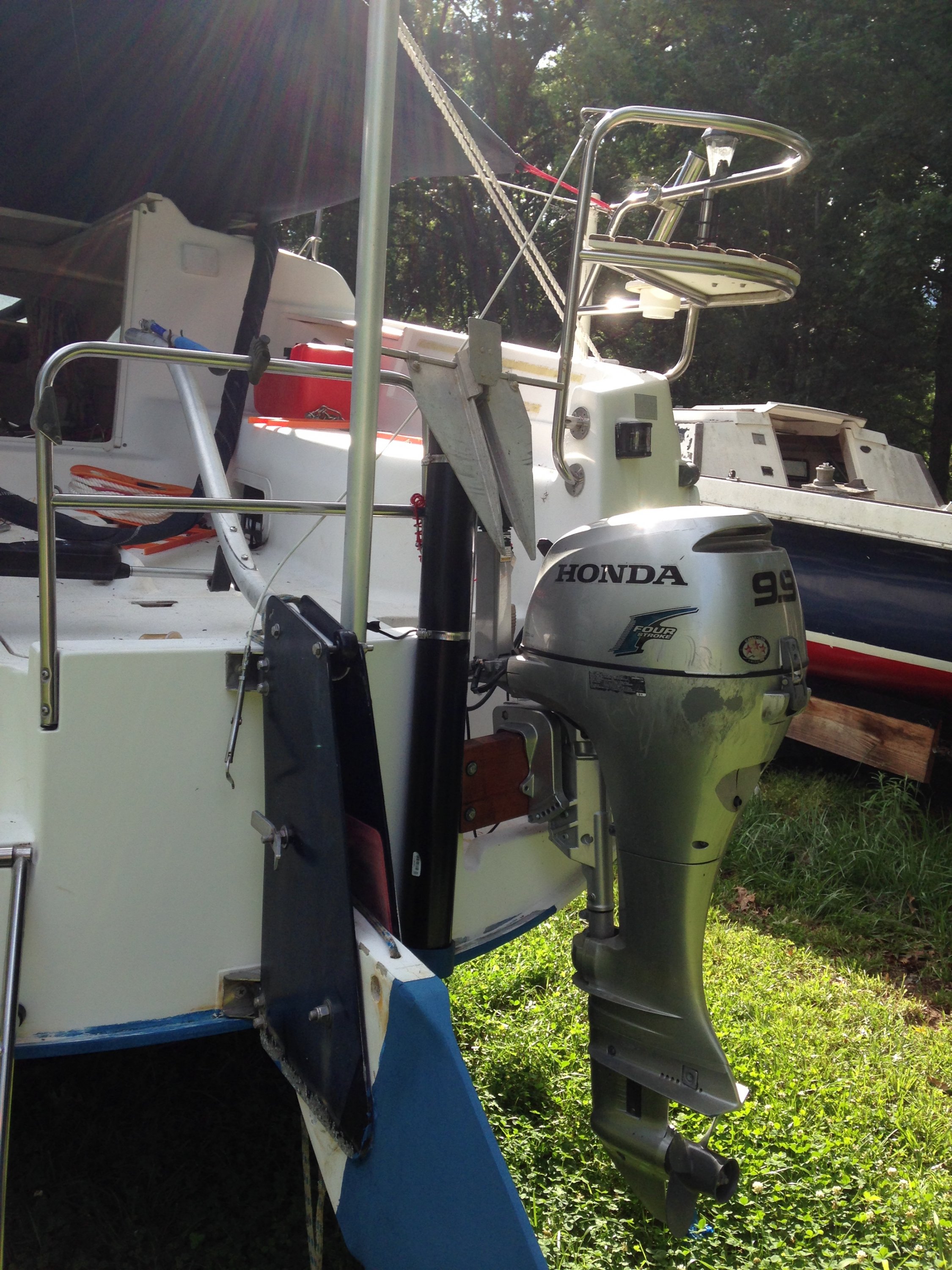

I'm back on my computer now. Here is a pic of how I set up my stern anchor. The black pipe is hose clamped onto my stern rail and sits on a lip at the bottom of my transom. The 4" pipe is long enough that I can set 10' of chain down in the pipe as well as the anchor. I also made a bridle that quick snaps to two U-bolts off of the stern. I sometimes use the bridle to tow my dingy but I bring the dingy up to the boat when at anchor. You can also see how I wrapped the bridle line around two bumpers. This keeps the line floating so I don't get it sucked up in the prop. I still have to be careful in reverse with the line and the prop but it works great so long as I am moving forward. The bumpers also double as a snubbers. Probably don't really need a snubber but I like the idea of it none-the-less.
