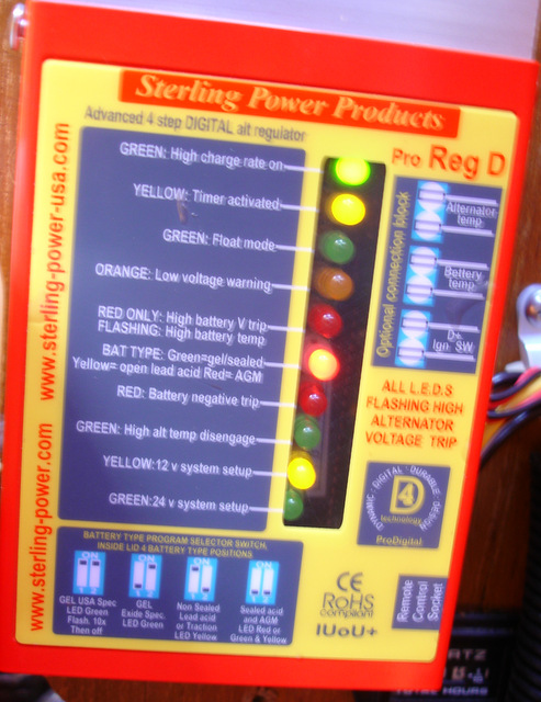

I have the Electromaax 140 Amp alternator, with Sterling Pro-Digital regulator, I do not have the remote control for the regulator. I have about 400 Ahr AGM house bank.
If I am in the slip with the Sterling battery charger on, with the bank fully charged, so it is floating at 13.3 volts and few mA's going one way or the other. Then when I start the engine (the battery charger is off of course) and the alternator voltage goes quite high around 14.7 volts, with about 8 amps being accepted by the battery bank, the voltage and current seems to jump around quite a bit like the regulator is analyzing the battery. After a bit, the voltage is reduced to 14.5 V and about 2 amps are being accepted. It has stayed like that for a half hour or more until the engine was shut off.
From the owners manual it appears the regulator has entered a timed period of 1 to 6 hours at the high charge rate before it will go into "float" mode and reduce the voltage to 14 volts. I have the regulator on the AGM setting.
The battery label indicates it should be charged at 13.8 to 14.6 v and floated at 13.2 to 13.6 v. I am concerned if this could hurt the batteries by running them at such a high voltage when they are already fully charged ?

Bob,
What brand of AGM? It may be temp compensation doing its job on a colder morning. I don't recall whether Charlie has programmed it for compensating "up" in cold weather or just down in hot and his manual is rather "scatter brained" so I have a tough time even reading it..... The easy way to test is to disconnect the battery temp sensor.
The long and short is you will be fine. You can always program it for a lower absorption voltage too. The Pro-Reg D regulator calculates the time it took to come up to voltage and then adjusts the absorption time, or should. You should never see 12 hours at absorption with the Sterling reg unless the batts need it.
That said there are millions of cars on the road using AGM batteries and millions of car alternators pumping out 14.4V - 14.6V constantly with no float what so ever. These batteries are not cooked. Personally, for sailboats, I think float on a regulator is more of a "selling feature" than a useful feature. For shore chargers float is useful...
Also the term float has wide definitions. Some manufacturer consider floating as days or months and others want to see no more than 10 hours at absorption etc....
Keep in mind that a battery charger has a known amperage thus it can tell better than a regulator when to go into float mode as it can assume it has been properly sized..
A regulator has no clue what size alternator it is connected to, or the bank, thus it can't base going into float on such things as % of field current etc. and has to run on-the-fly time calculations to determine absorption time..

thank you Maine, good information........just what I was looking to get.....I will feel better now when I look at that voltmeter !
Yes the manual is a bit scattered. He states that AGM and Gel batteries are not recommended because "they have a limited ability to absorb high charge currents" , so it made me question some of the rest of his advice and recommendations.
I bought the AGM's at Sams Club, they are group 31's I have 4 in the house bank, the specifications on the label are in the photograph below.
We are about halfway down the east coast of Florida, it has been quite warm and we have not started the engine before 10 am so I don't imagine temperature was an issue. I do have the temperature probes on both the battery and alternator for the regulator.
thanks again, Bob
