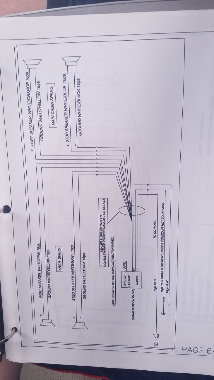

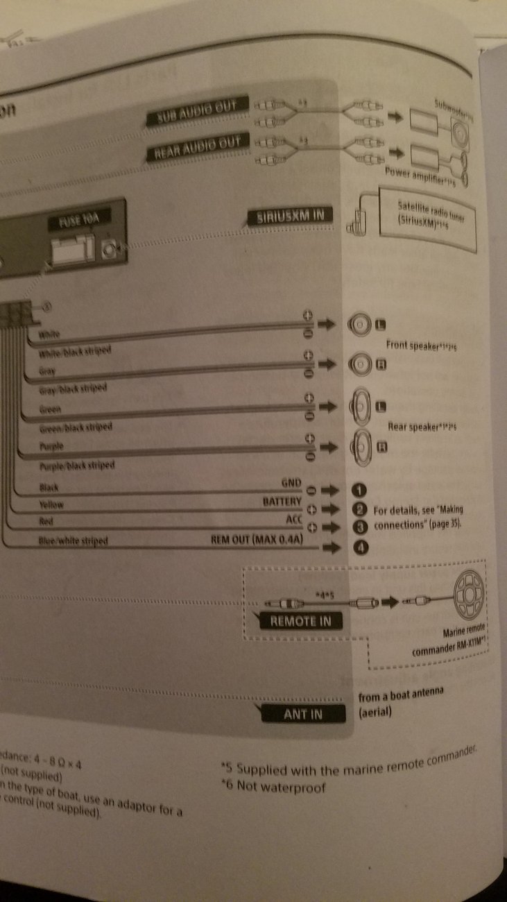

I'm replacing the stereo in my new to me 2004 hunter 36 the old didn't have bluetooth or even and aux input so replacing my old sony with new of course wiring harness are different so no plug and play speaker wire is stright forward not a problem. But not a 100% sure on power wires any help would be appreciated . Here the wire in the boat from my boat manual 20190605_194157.jpg. And here's the stereo manual 20190605_194157.jpg

That's what I thought but when I looked at the boat manual its saying ground is yellow and on radio wire harness its black so am I going yellow to black ? Red to red . Then yellow/red to yellow ? Or am I overthinking this?

The boat ground shows "YLW".. I don't know what that means, but I think it is a cable type and not a color..?? (one of the electric guys will have to decipher that) .. but solid yellow is the "memory" power (hot all the time) red is main switched power, and on the radio, black is ground.. so black from the new radio to "YLW" in the boat, probably black .. Probably would be good to break out the voltmeter to be sure..

Well there is from the boat a yellow/red wire , a red wire and a solid yellow wire . So I'm assuming ( I know assuming lol) the YLW means yellow. On wire harness there is black red and yellow
On car stereos YELLOW is 12V POSITIVE to the battery, it is NOT a negative.. Yellow is the wire that powers the amplifier etc. and typically gets connected to the always-on 12V positive bus. The red stereo wire is your "switched +12V" and this is the wire that actually turns the stereo on or off.

Ok more confused. In the boat manual ( see above picture) its Says YLW which I'm still assuming mean yellow lol. Is the ground . But on stereo wire harness ( other above picture stereo wire diagram its black ) so I'm connecting YLW boat ground wire to black stereo ground . Then I'm connecting yellow/red boat (hot wire) to yellow stereo wire . Then connecting red boat wire to red stereo wire ? Thanks everyone for all your help

That seems correct, Chris.. Yellow/red boat wire to Yellow stereo wire for memory retention.. Red boat wire to red stereo wire.. stereo ground (black) to whatever boat YLW is.. Voltmeter check before letting the magic smoke out..

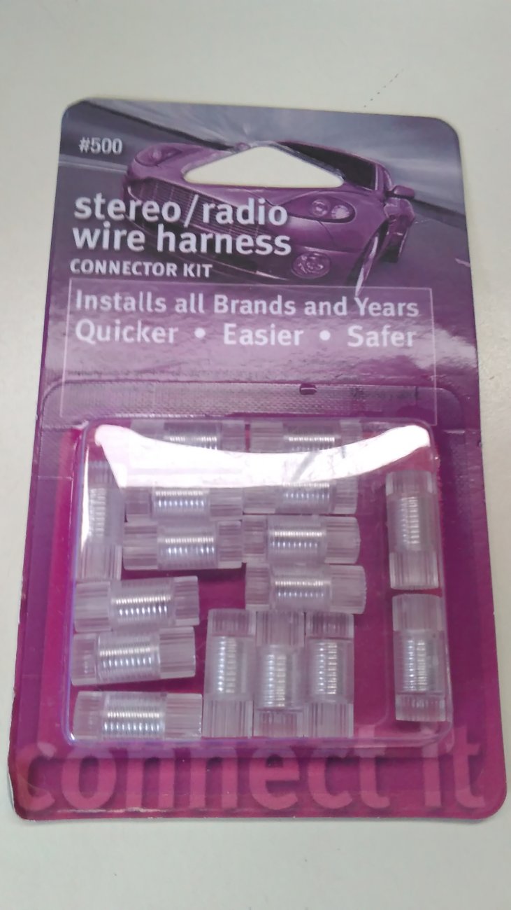

there's a better way and much easier:
When I was shopping online for the head-end unit, I stumbled over the Posi-Product 16 piece wiring connector kit. It consists of two clear plastic tubes with male and female threads for each wire. You twist the two wires together, slide the male piece over them and simply screw the female onto it. It saved me having to make up 11 butt wire splices with the small wires on the stereo harness. I removed the harness from the back of the radio, removed the insulation, and made the splices with the Posi-Product pieces. I was able to do all of the splices while comfortably seated at the saloon table because the old stereo wiring harness came with two additional plastic disconnects for the power/ground/memory and the eight speaker wires downstream of the basic back-of-unit harness plug. Like the BT-139 Gell Filled telephone wire connectors I used for our fridge module replacement in August 2016, both of these little connector tools are true “must haves” for your electrical tool kit for splicing small wires easily.
Sony & these goodies came from Crutchfield.

@Stu Jackson -- Where were you with this suggestion a month ago? Seriously, I could have avoided soldering 16 little wires, and individually dipping in liquid wire tape? Well, it's done now, and I expect never to have to replace one again, but now I've got a great suggestion. Cheers.

23,547
WADR, that text I shared is from my stereo replacement article which was published in Mainsheet magazine only a couple of years ago ('cuz I did the installation in March 2017). That's why I recommend to all our skippers to read the entire magazine, not "just" "our" sections.
And I learned about those connectors from the Crutchfield website when I was looking for the stereo unit.
